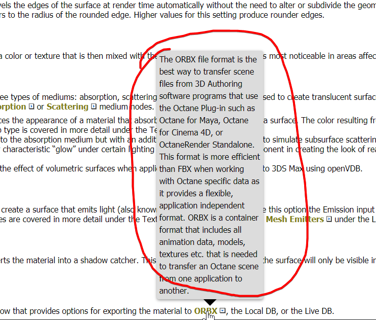

this question is more to the developers of the kernel
What is the meaning of ORBX format if it can not be imported between plugins by octane integration?
screen from 3dmax help

VVG wrote:this question is more to the developers of the kernel
I'll add a proxy node for orbx in next releases. But import and convert to geometry in to c4d scene is useless and big task. No need.
no need? :shock:
ORBX ecosystem between plug-ins is not needed?
maybe this needs to be asked from users?
what then is the ORBX format?
only export to standalone?
