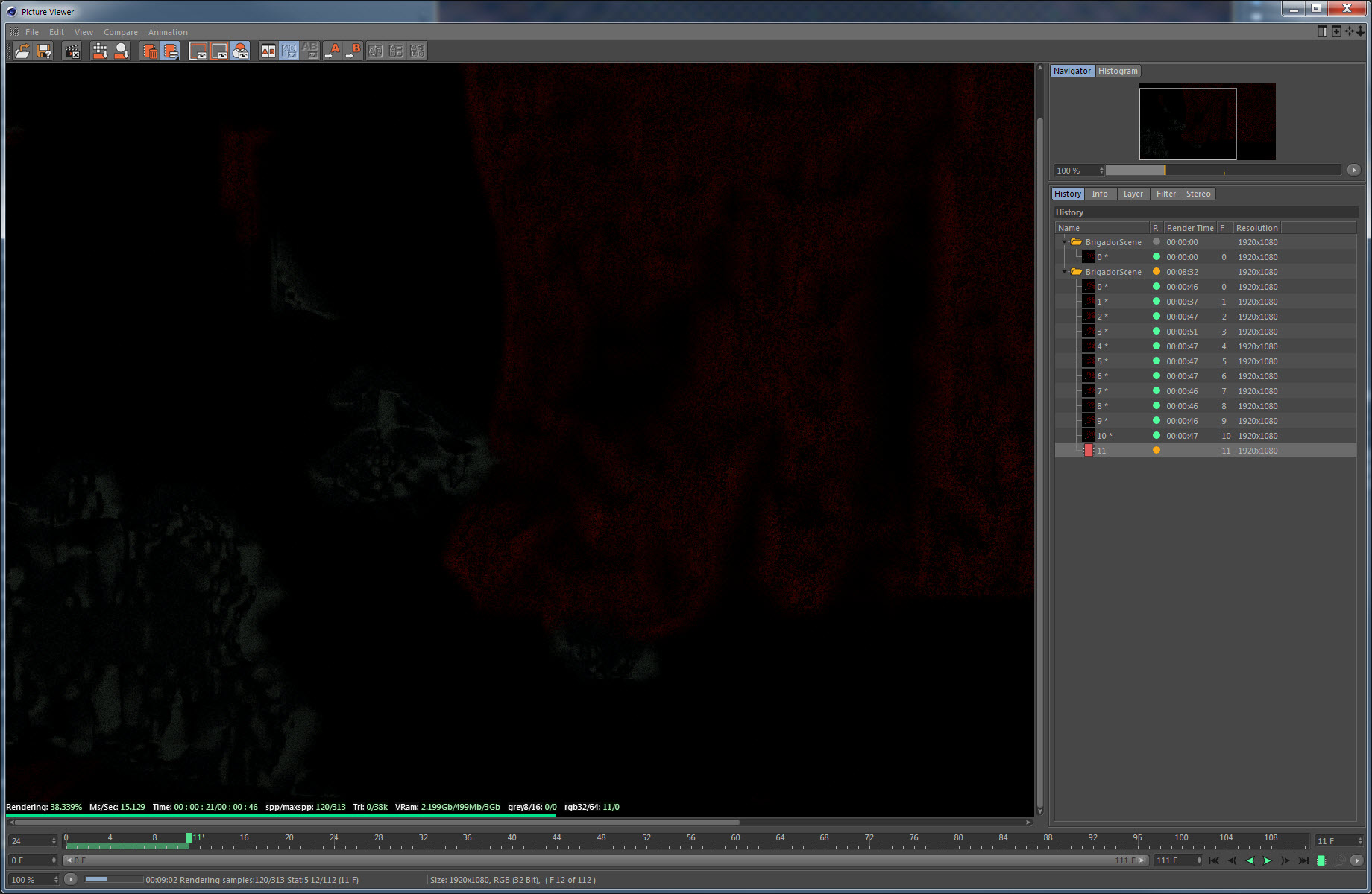

After checking and rendering it this what i got. Can't see any issues here see image. You can try to change render method to "manual assignment" if helps.
