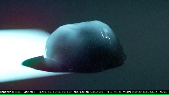

Before updating to octane 3 this scene would be quite clean at a high max. samples value with the PMC kernel (something like 5000 - 8000), however now it's incredibly noisy, with all of the same settings and everything.
Is there any way to fix this?

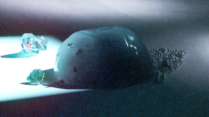

yeah i did sorry, just wanted to make sure it was definitely in the post lol.
I've attached a very stripped down version of the screenshot i sent in my first post. The scene is set up INSIDE a cube, so its a very dark scene. I assume it's to do with octane not having enough light to bounce around, leaving a lot of noise behind. The only frustration I'm feeling here is the fact that this didn't happen with the previous version of octane, I was just able to set the max. samples really high and the noise would eventually go away in v2, so I'm kind of at a loss trying to figure out what changes that came in v3 caused this kind of problem.

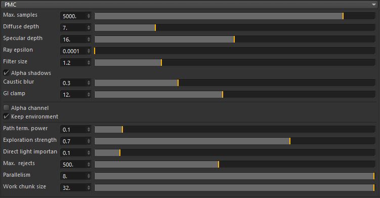

I don't know your scene needs but try to optimize with Diffuse samples down :)

valters wrote:I don't know your scene needs but try to optimize with Diffuse samples down :)
Well that seems to have fixed it, thanks heaps!! Those settings never made any *pleasing* difference on my scenes in V2 so I ended up letting them fly over my head after a while.
