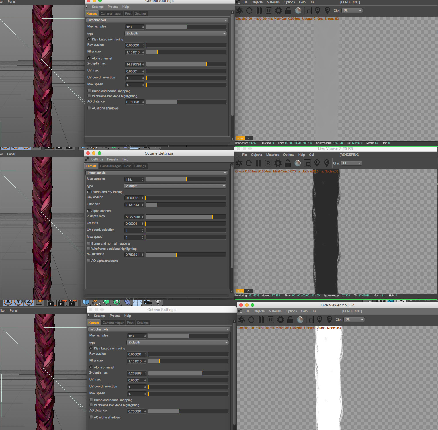

Sorry, should have clarified my issue. I saw the posts about render formats and understand that aspect.
The thing is, all of those people appeared to have successfully created a preview of the depth map in the LV. I cannot get a working preview in LV.
If I futz with Z-Depth Max the object I am attempting to build a depth map for shifts from solid white to solid black in the LV. In between the two extremes it does turn grey, but solid grey. EG, it is acting like the object is a flat plane with no depth detail. (When in fact it is an object with depth detail.

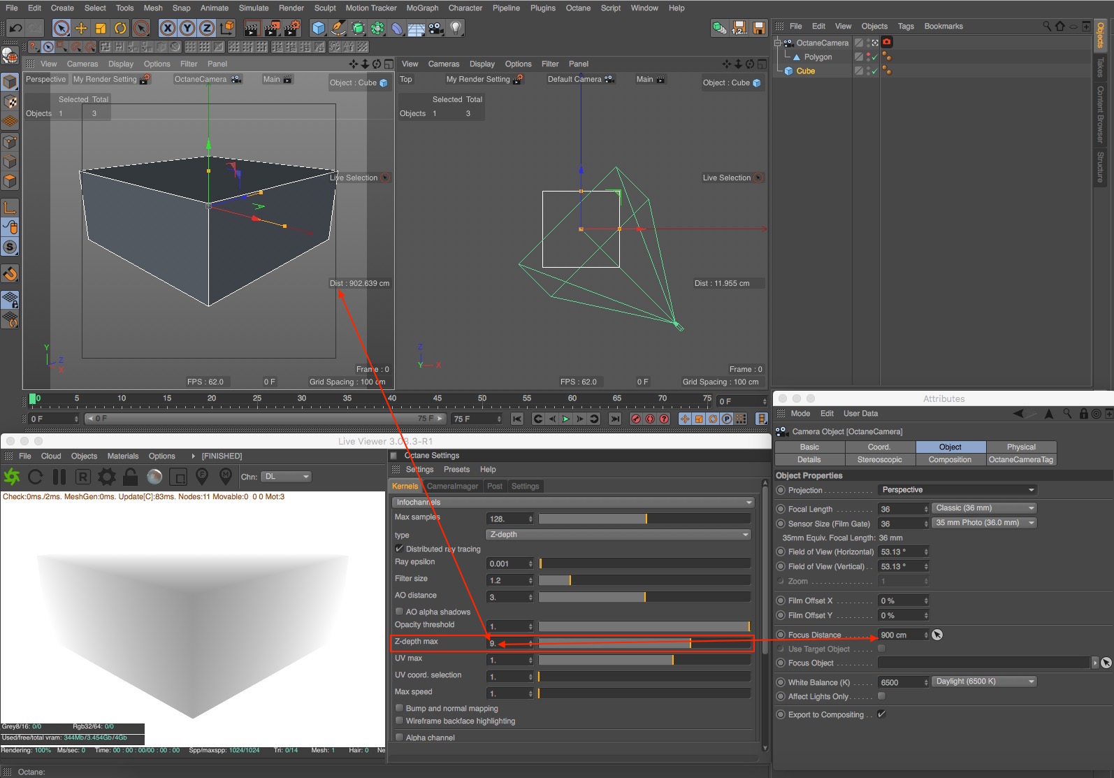

Hi guys,
no, Near clip depth has nothing to do with z-depth.
Near clip depth is used as a cutting plane for hiding foreground geometry, eg. hiding a wall for watching inside a room.
The Z-depth value is in meter, look at this picture: Try to insert a more precise distance value.
ciao beppe
ciao beppe

How are you getting a clean black to white backgrounding your Z-Depth? Whenever I use Z Depth, my render goes from black to white to black like in this photo. (http://imgur.com/bCIKPcg) This is mainly because I don't have anything in the background/alpha. I see in your render that you have a polygon under the camera? Is that what I need to do?bepeg4d wrote:Hi guys,
ciao beppe
Thanks!
It really doesn't matter if you have the Alpha channel active. anyway yes, correct, in this case I have a simple polygon object parented with the camera, to have the white background
ciao beppe
