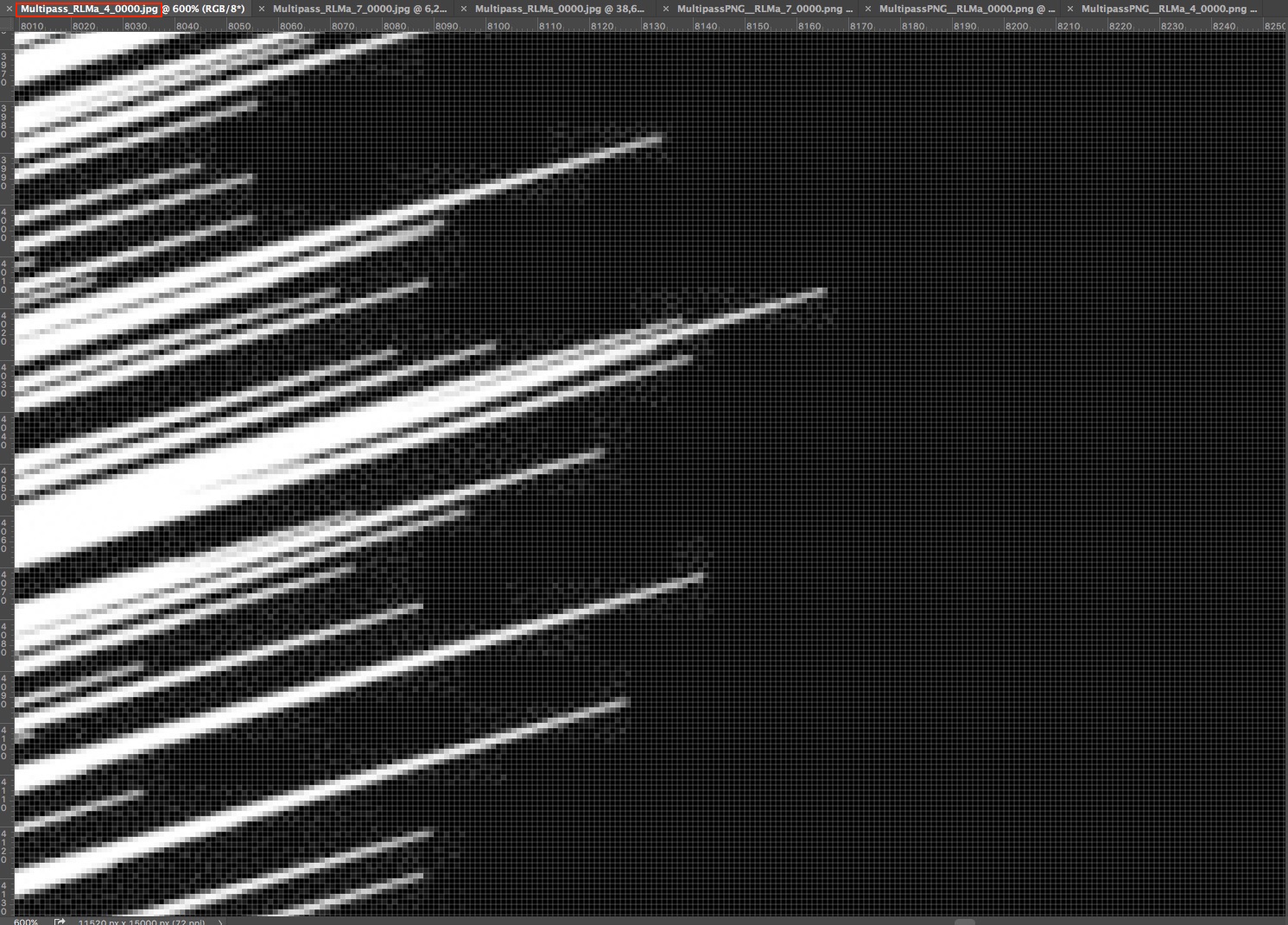

i've some problem since we got Rendermask. I get diffrent results when i choose Rendermask in the infopass (which looks pretty good but i can render only one mask) and when i choose Rendermask as Multipass (has some noise around the Mask).
You can see it with zoom of 600-700%.

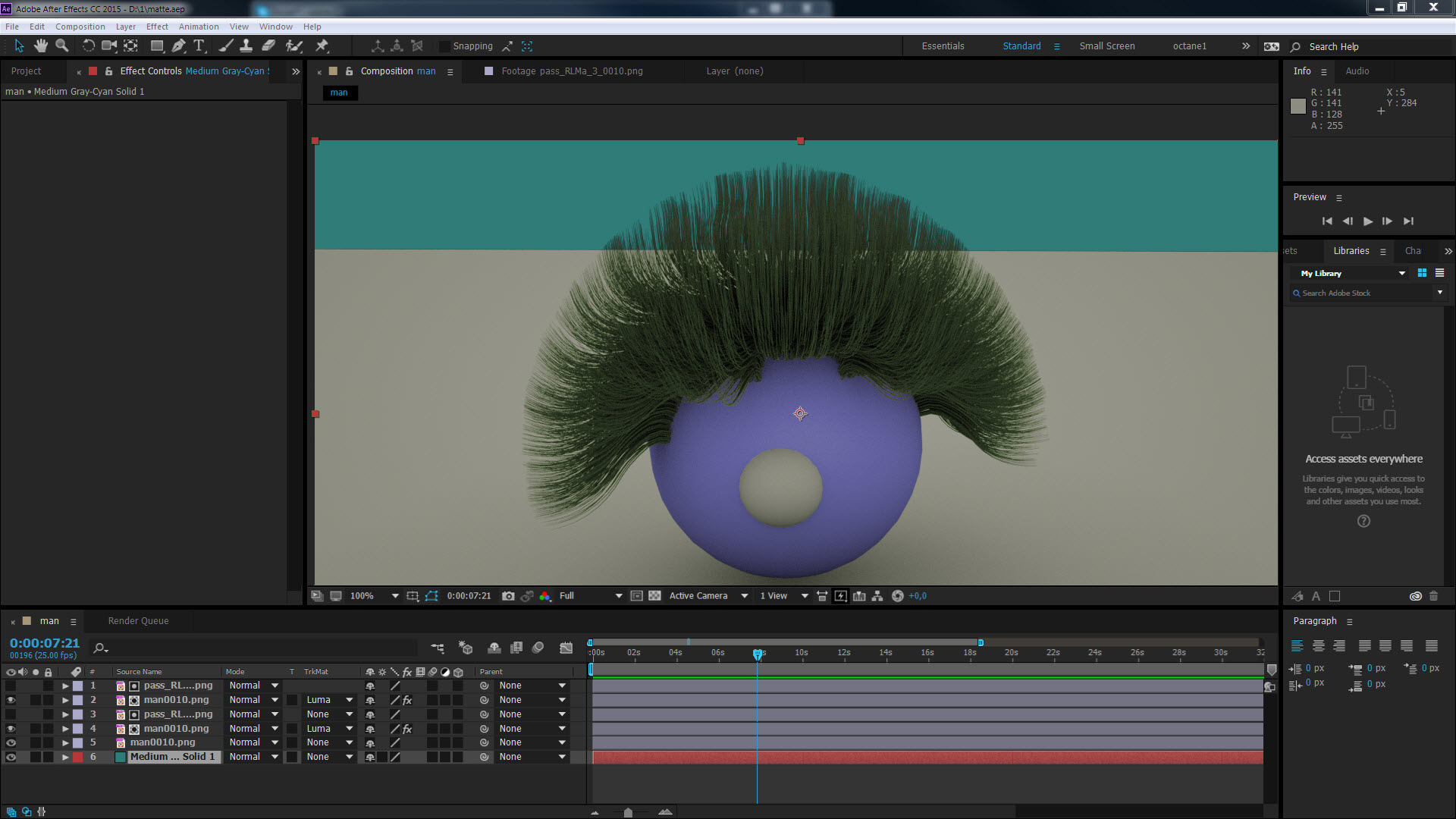

My Workflow for Multipass look like this:
First Beautypass.
than i created a C4D-File for my Rendermasks which i start as usual but with a Samplerate of 1 (because i dont need the beauty pass).
When the beautypass has finished he starts my Multipass with a samplerate of 200.
I attached my C4D File and two picture.....hope you can help me!
Greets, NICK

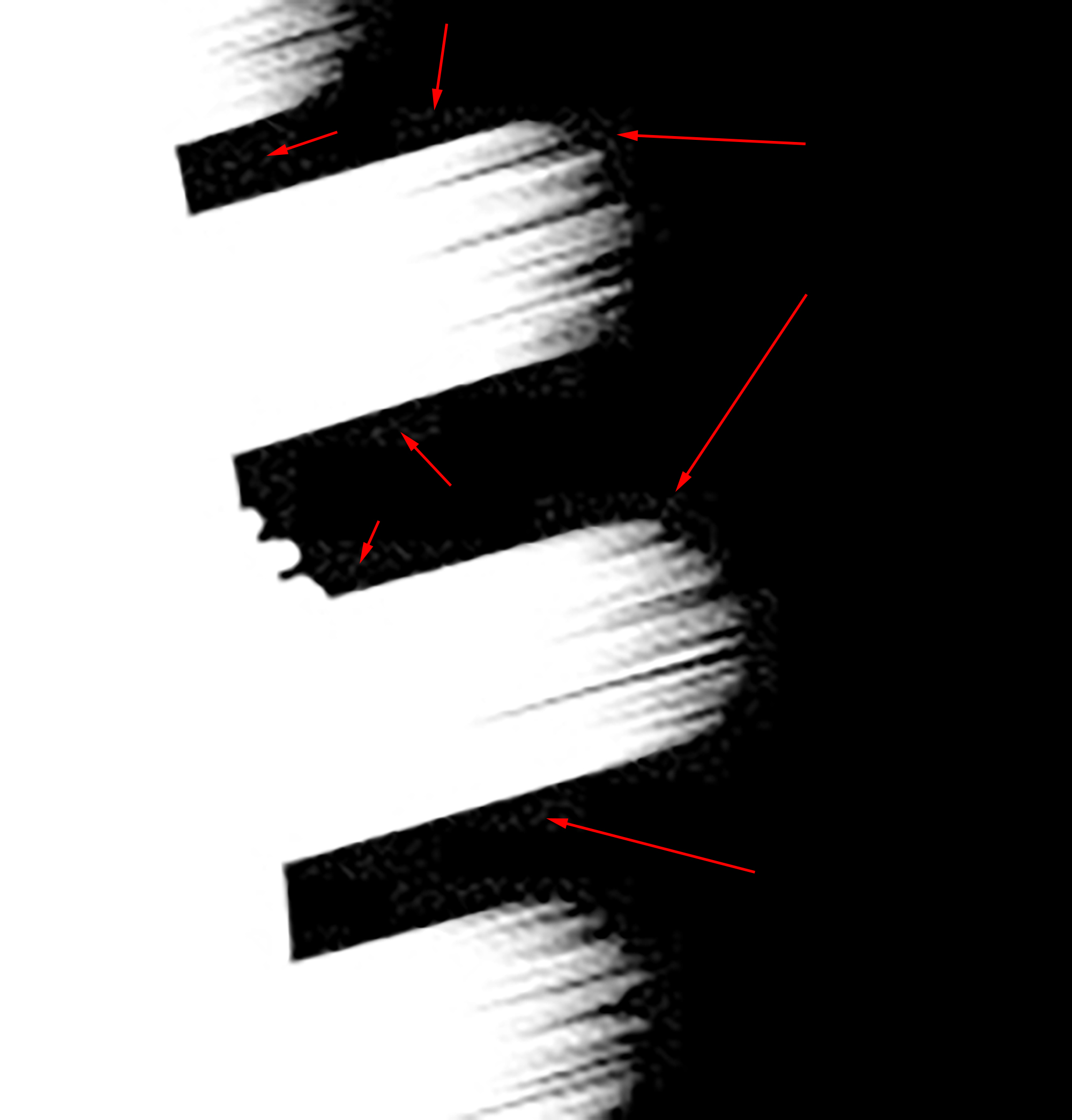

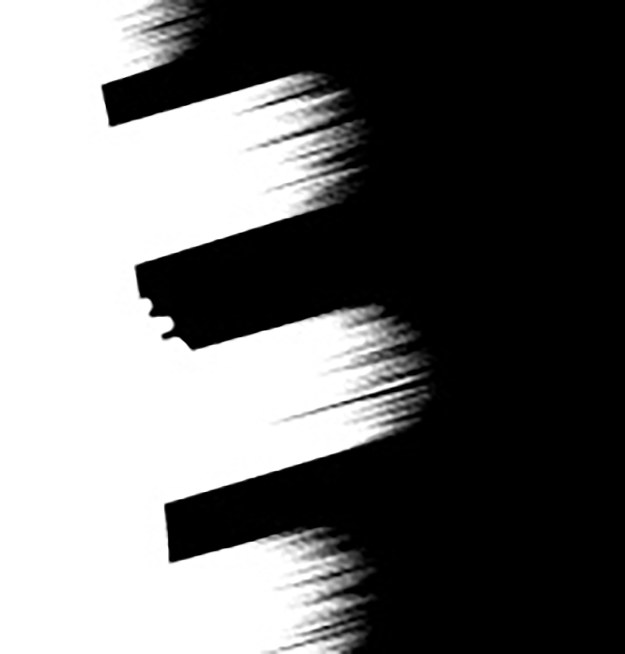

Hi NVN,
I guess that the jpeg compression is the culprit.
here is one of the zoomed resulting mask in your file saved in JPG format: and here is the same mask but in PNG format: ciao beppe

Thx bepeg4d, but i think its a bug, because:
if i only render one at a time there is all perfect. (infochannel--->rendermask)
If i choose beauty and rendermask 1-8 all mask would be noisy....
both ways would be saved as .jpg.
