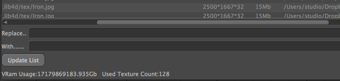

WEll its definately still buggy, see the VRAM usage in this one:
DinoMuhic
Posts: 226
Joined: Wed Mar 25, 2015 10:24 pm
DinoMuhic wrote:WEll its definately still buggy, see the VRAM usage in this one:
@Aoktar, can the wrong display of VRAM usage like in my screenshot above where it says 175952920295GBs coming from dots "." inside filenames? Because there are plenty filenames with dots in them. I'm trying to fix this and get octane to display the correct vram size. I got 3 scenes and only in this one, the display is buggy.
