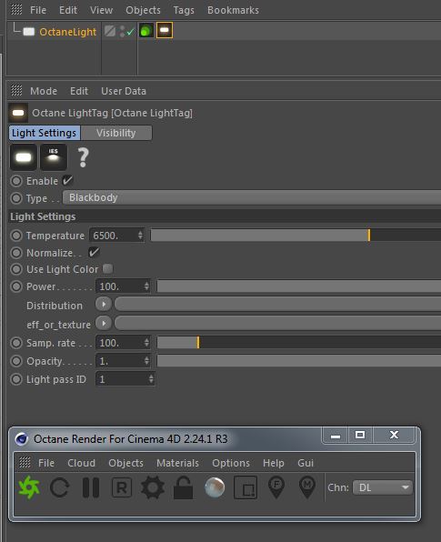

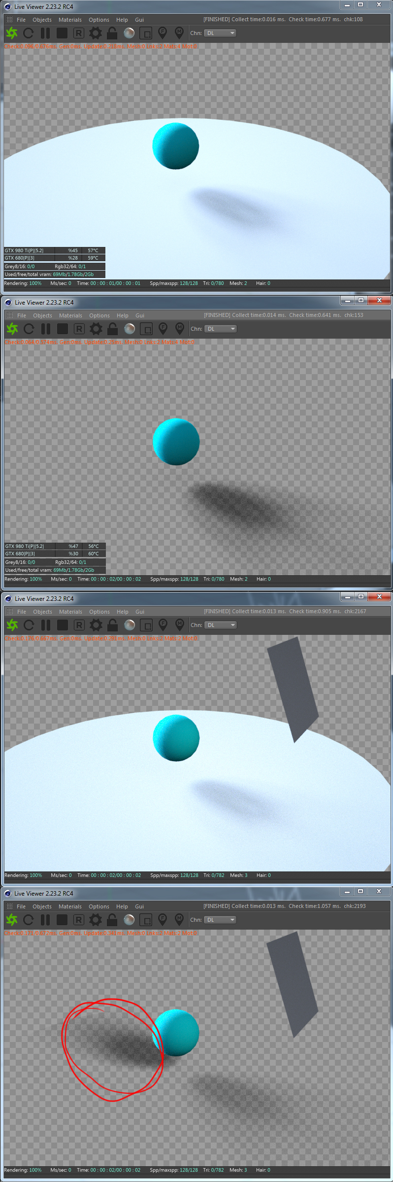

The matte shadow works great for one lightsource only, as far as I can tell. From what I can see, shadows from all lightsources are rendered fully visible when you use the matte-option. To illustrate what I mean, have a look at the pictures.
1 pic.

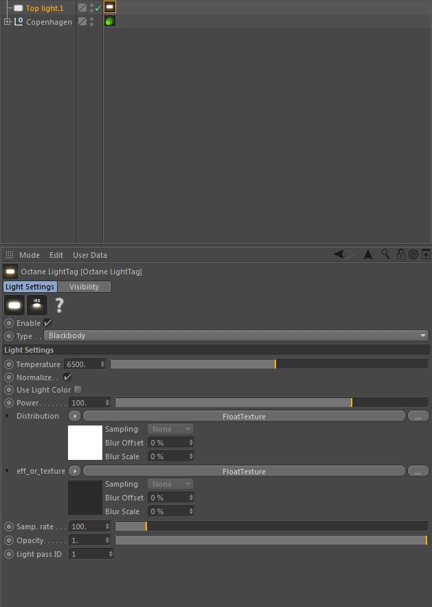

scene is lit by an HDR image.
2. pic
matte shadow is enabled. You get the shadow as expected

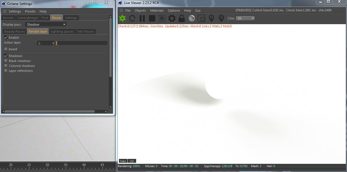

3. pic
A fill light is added in the scene.
4. pic
matte shadow is enabled, but now you get a really dark shadow from the fill light.
Is there a solution to this?
Thanks :)

I tried this, but it gives me the same result. The shadow from the fill-light is waaay too dark. It should not even be visible. And it does not matter what power your lightsource is. It can be 0,0001 or 2000. Strenght of the shadow is the same.
Notice in the tutorial - there is also just the lighting and shadow from an environment. There are no lights in the scene... I guess thats why it works...

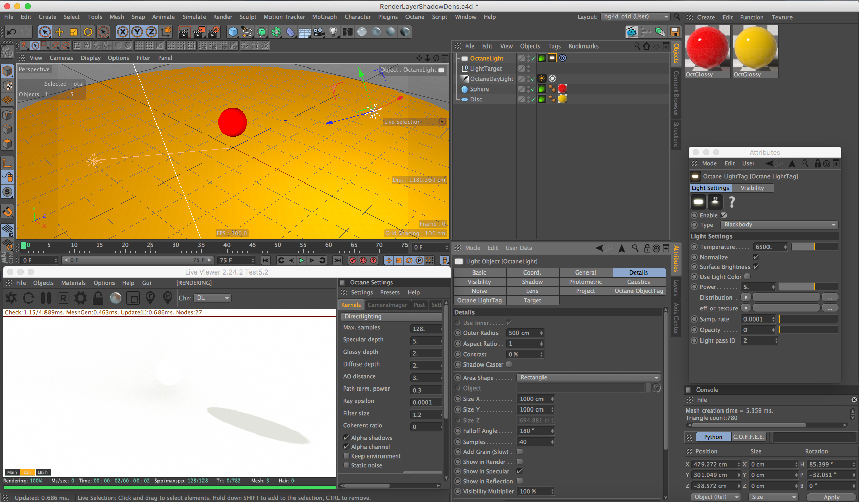

You don't need a fill light If you need less dense shadow, you could reduce the amount of the layer in your compositing app. But, if the fill light is needed in any case, you can reduce the angle in order to spread the shadow:

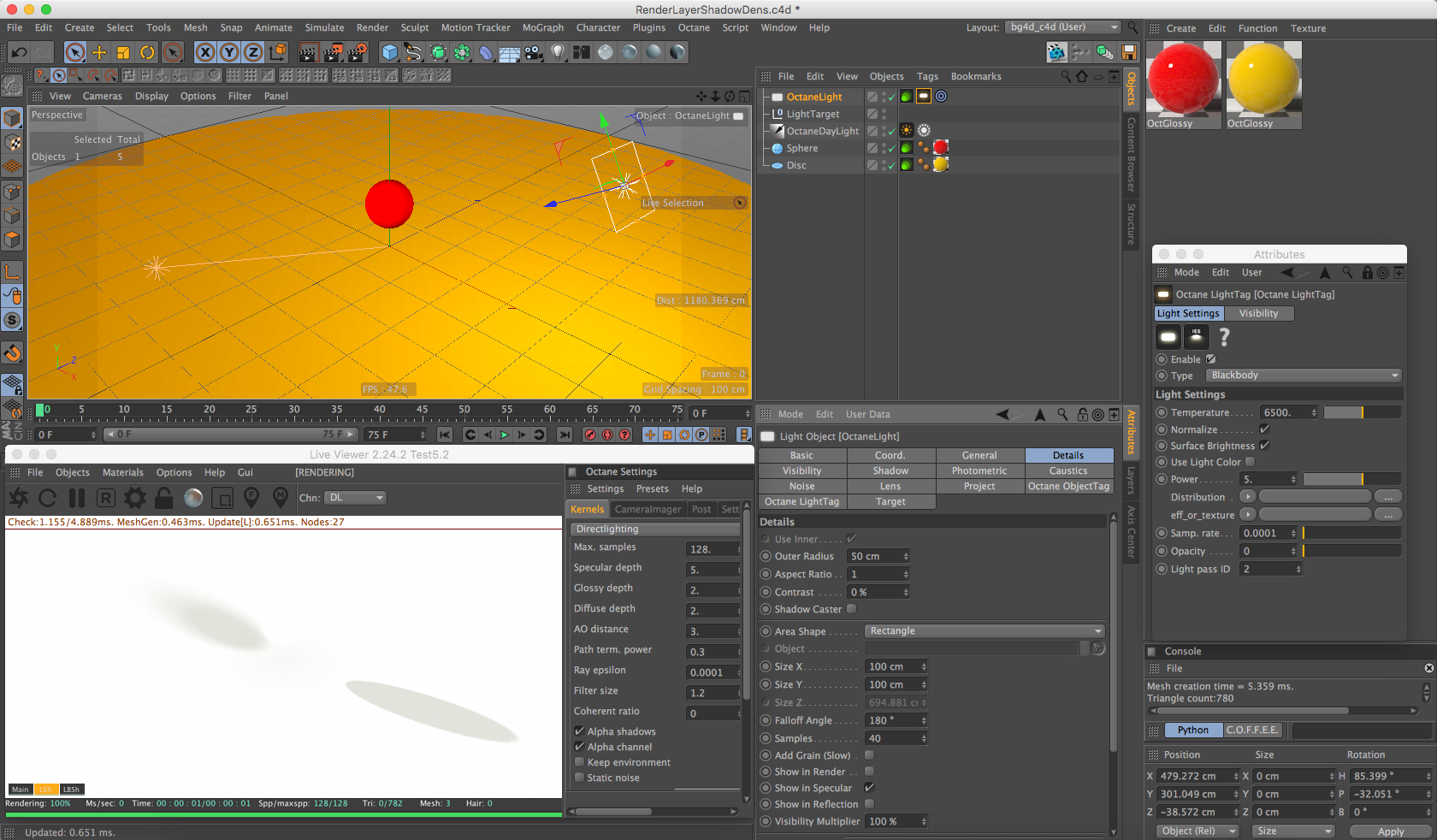

a solution for fill light shadow is to activate the "Surface brightness" option in order to have the same illumination with any dimension, and then enlarge the emission in order to blur the shadow.
Here is an example with emission 100x100 cm:
and here with 1000x1000cm:

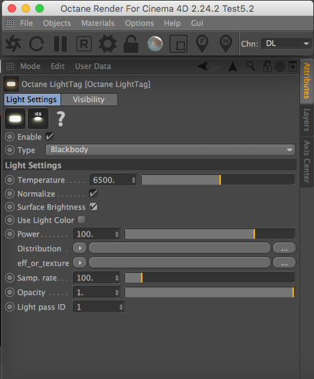

For some reason I do not have the "surface brightness" option in my light tag??

I just uploaded both the stand-alone and the c4d plugin to the latest version (OctaneRender_for_C4D-2.24.1-R3). But I still do not have the option for surface brightness available... Any ideas? :)

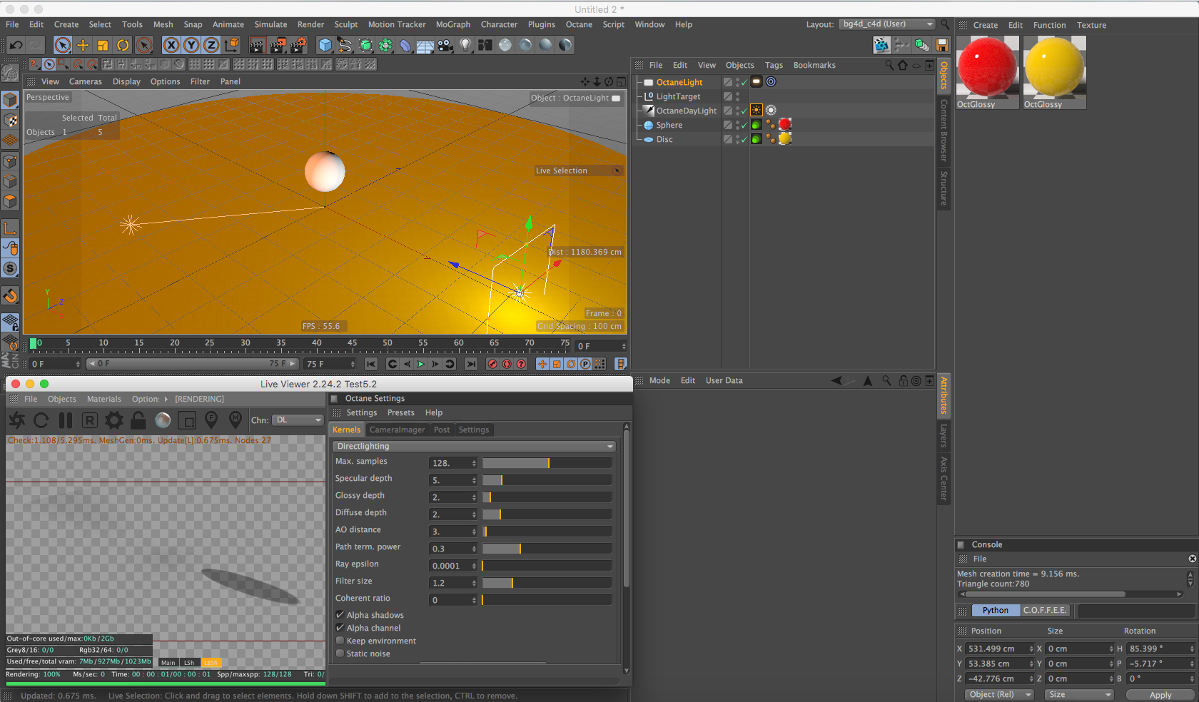

Posts: 10502
sorry, my mistake :(
you need the 2.24.2 for the "Surface brightness" option, sorry again for the confusion.
