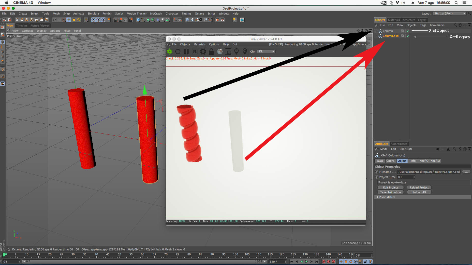

As subject, it seems that Xref Legacy doesn't works correctly. In fact, I can load the model and in the editor windows, I can see the texture mapping, but NOT in the Live Viewer.
Xref, instead, works fine...
But, as always, I'm wrong...
L.

Here's screenshot and the file...
Thank you, Ahmet!
L.

As you can see, in the editor window, I see the texture map, but not in live viewer...
L.

Why do you use legacy mode, what's the advantages? Why i'm asking, because if you use this there is not any material imported. Plugin is not designed to work without materials in scene.
