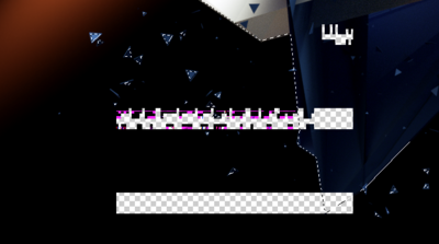

I also get a lot of glitchy errors in the whole OS.
Maybe this also helps.

VVSVS wrote:I also get a lot of glitchy errors in the whole OS.
for what? Is it LV window?

...It spreads through the whole OS.
I will try to monitor all of this and get back with more info.
Thanks for your help.
Ivan.
