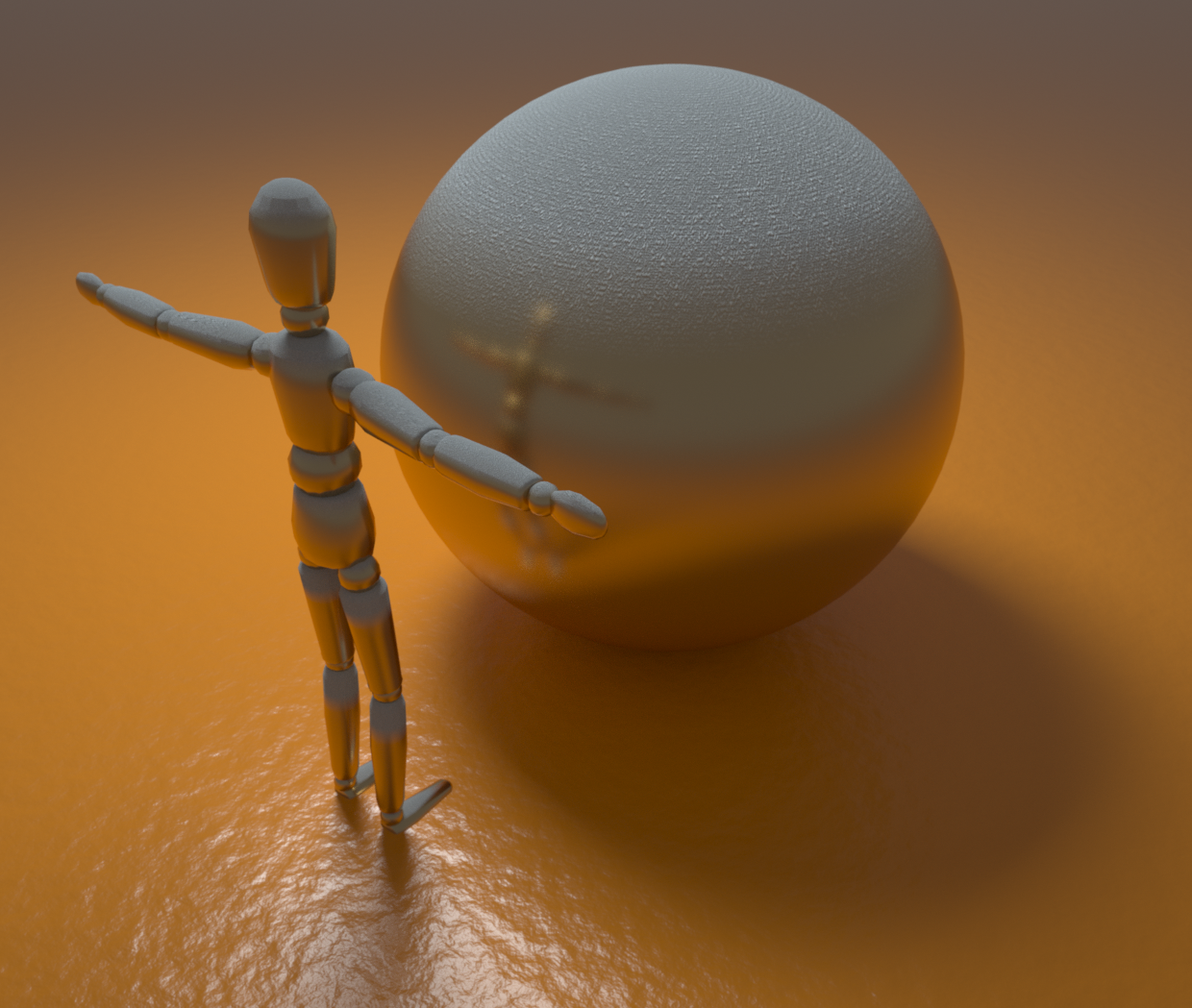

Thanks very much for your time with this. Thanks to you I have discovered what the Sine Wave texture generator does! However, I am having trouble assigning a suitable transform to my model, I get the effect on a primitive but not for my model. Would it be possible for you to PM me your scene, so I can understand the voodoo that it is at work here? I noticed for the arms on your figure that the 'dust' is settling at the ends and not the top of the mesh, so presumably I would have to apply a different material if any part is oriented differently?

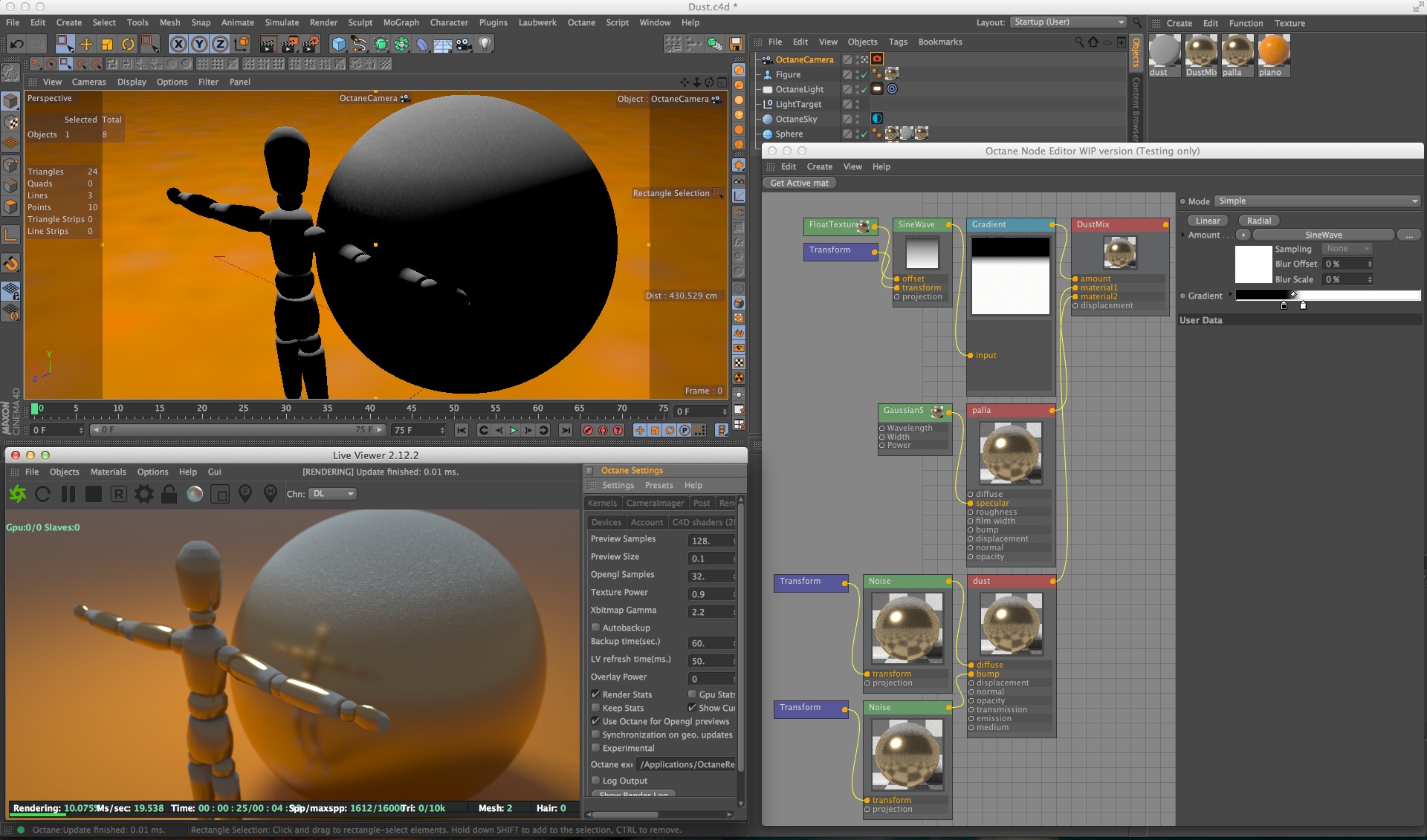

yes you are right about the position of the dust on the arms... i was too lazy to fine tuning the projection on arms and feets :D
this way works better for simple geometry, here is the scene corrected so you can check:
Dust_0001.c4d.zip
(143.71 KiB) Downloaded 347 times

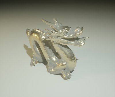

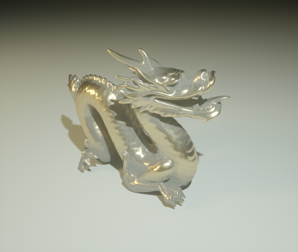

for complex geometry is better to use the dirt node for driving the dust.
Dragon-Dust.c4d.zip
(1.45 MiB) Downloaded 358 times
