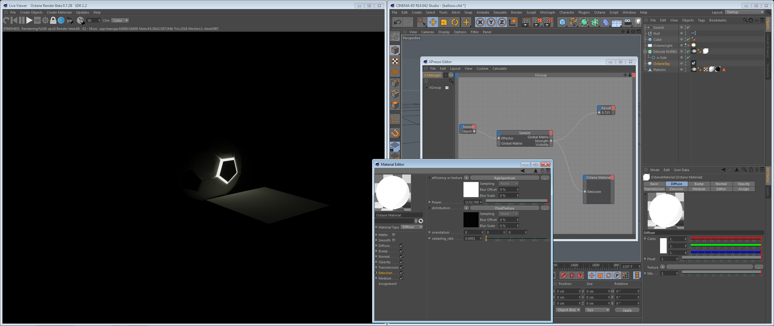

hey its me again, this time its about XPresso. i think everyone here knows about XPresso. And I notice octane cant be use in XPresso just because of ONE reason. Which I think can easily be added in a simple update.

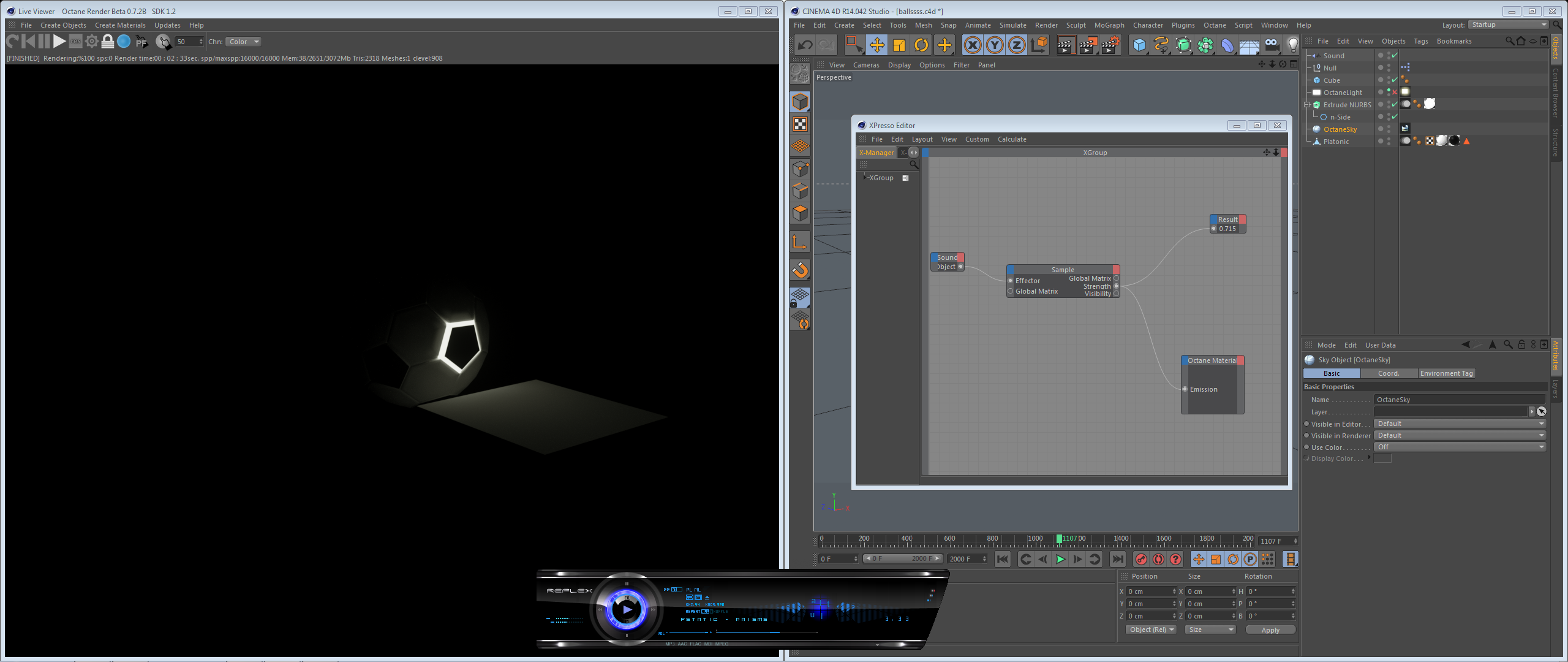

So here below is a sample of a basic XPresso. making a texture (texture emitter) glow according to sound reactive. If we are using C4D material, i would be alight the strength of the effector to the brightness of luminace and brightness of the material color, since we have to use Octane Material. Common sense we will be aligning the strength to emission.
At frame 0, the light didn't lit. but as soon as the sound plays, the emitter lit, but it didn't reactive with the sound. So Xpresso did actually send the data to Octane material, and it can work! the reason it failed to work is because it is controlling the on/off of the emission while it should be controlling the "Power of the emission".

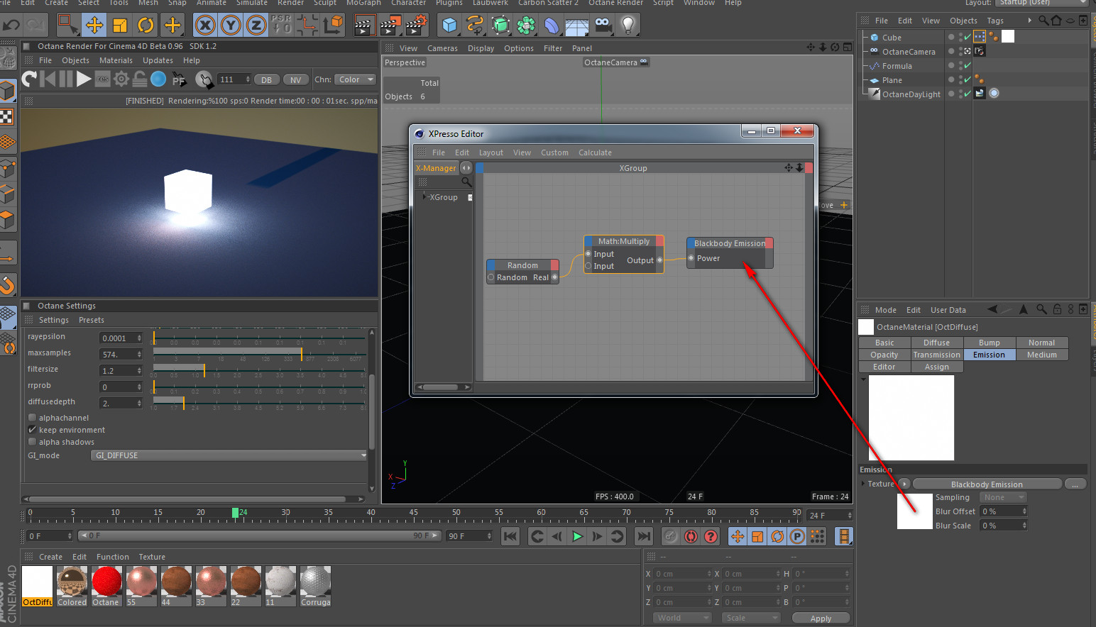

i see it, give me some time to prepare a final RC version. Later i'll help you
Posts: 16068
Location: Türkiye
Best method is to connect black emisson texture to generator like in image

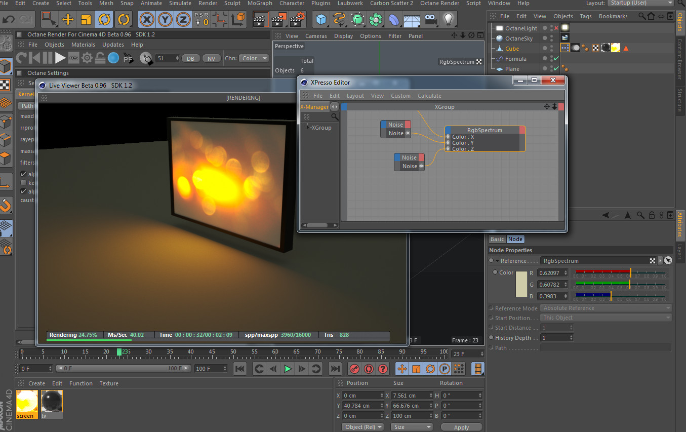

aoktar wrote:Best method is to connect black emisson texture to generator like in image
okay... but using blackbody texture we are limited in terms of colors right? or lets say if i want a certaint image(tv or something) to glow to a beat (which only texture emission can do).
my point is providing control over the parameters. not only on the power, but also on colors too. (okay i haven't tested on the colors, maybe can use it). I don't understand why octane is limiting the possibilities of what this plugin can do.

everything is possible ;)
grap the scene and fireup live viewer and play
