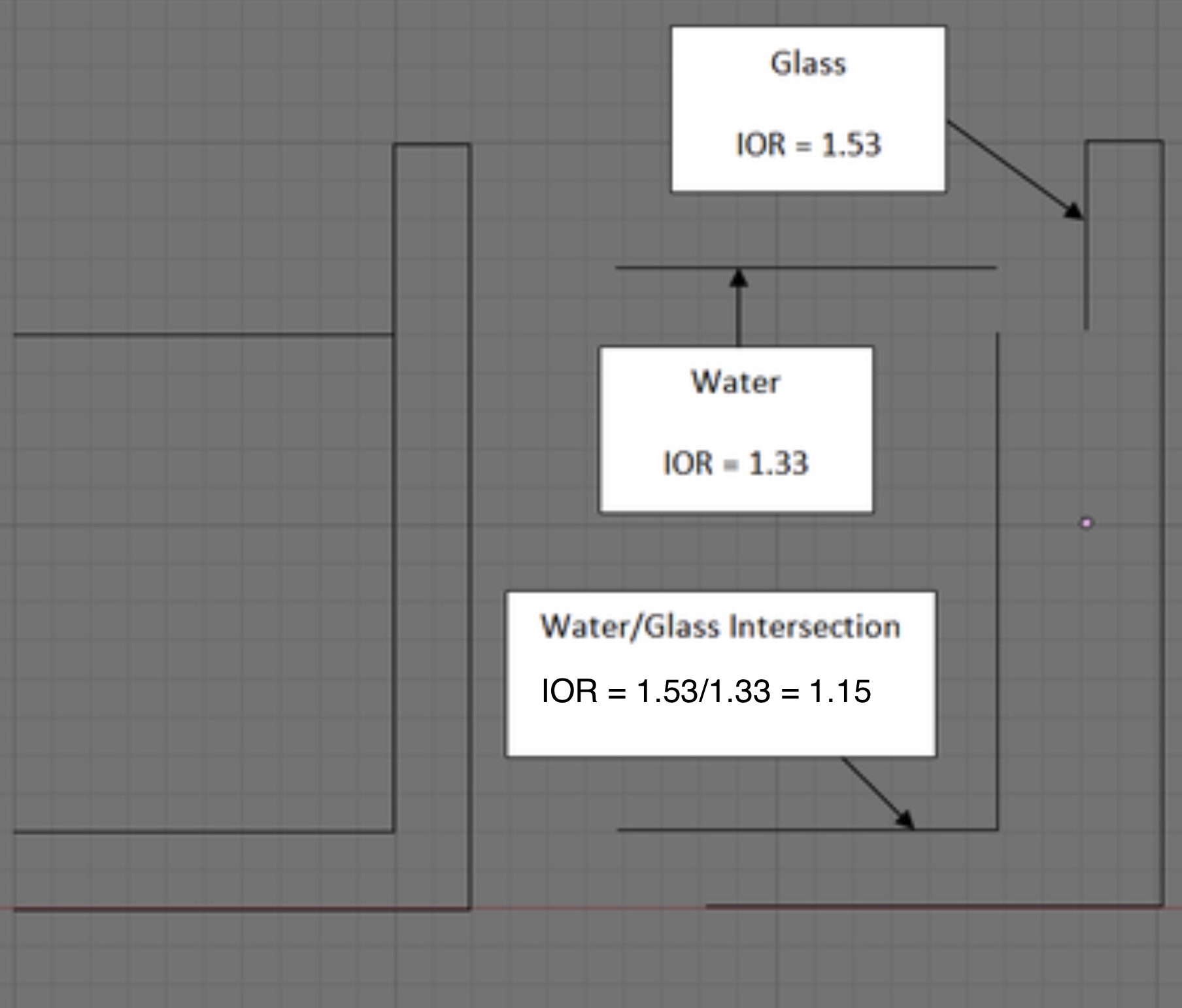

Here is a diagram on how you should need to model a liquid inside glass (without nested dielectric), for any unbiased physically based render engine, not only OctaneRender:

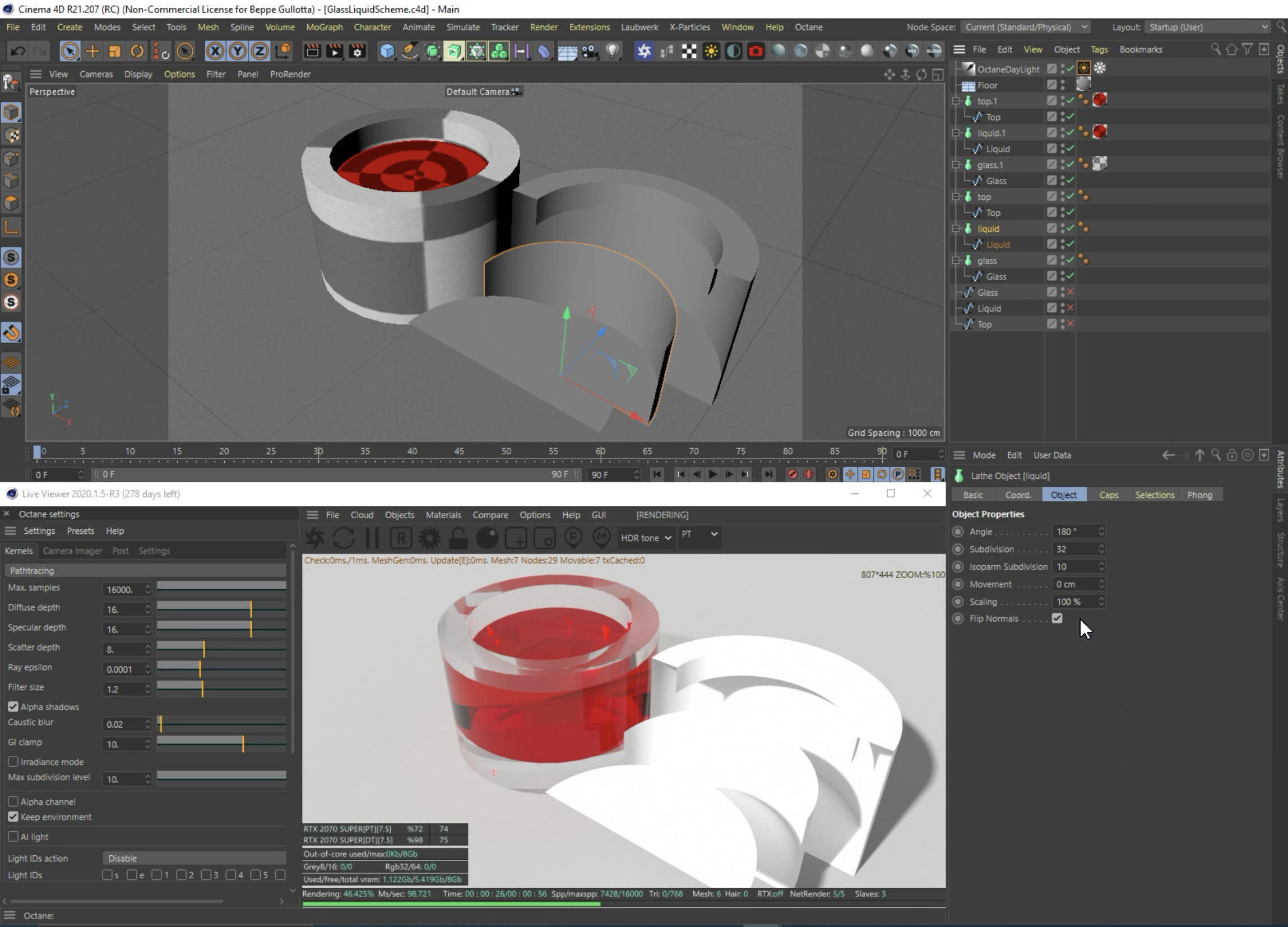

Basically you need to cut the internal glass where meets the liquid, and invert its normal pointing outward, to mimic the liquid that touches the glass, with IOR = 1.53/1.33 = 1.15.
Then add the top part of the liquid as single surface with normal pointing upward, to mimic the glass that touches the air, with IOR = 1.33.
In this way, you have the volume generated by three open surfaces, but with different IOR values, since Octane does not change the behavior of the ray, until it touches another surface with different IOR.
It is the same principle of the sphere around the Camera, with inverted normals, IOR =1, and Scattering Medium, for mimic the fog.
GlassLiquidScheme.c4d.zip
(97 KiB) Downloaded 144 times
Obviously, this solution works great only for static liquids, for animated liquids better to use the overlapping solution between glass and liquid.
