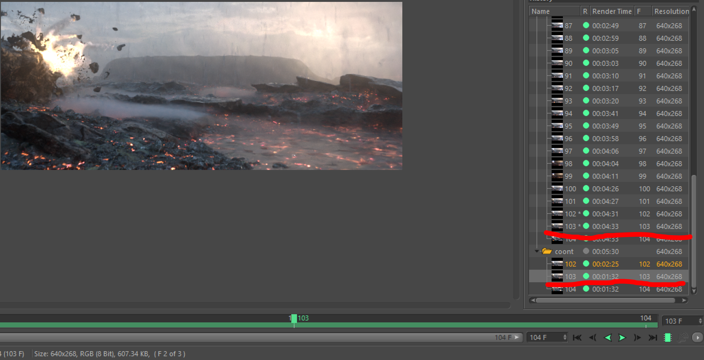

I have this exact issue. I have rain cached x-particles and and a whole scene of assets that are optimized. Anyway, times start at 1min 30sec on frame 1. At frame 103 it raises up to 4m 30secs. HOWEVER------ If i stop and start the render again at frame 103 it renders back at 1min 30sec. Voila! i say render every 12 frames or so and restart frame last frame. You will save tons of time! This seems like a memory buffer type error that can absolutely be fixed. I have no idea how but if I found this method to "fix" it then maybe octane can implement and memory re-buffer thingy. I don't know. Hope this helps. I've attached a pic. Enjoy!

Now my render frames actually start relatively quickly..... but each frame is actually taking longer to render...... it is quite bizzare.
its 100% the motion blur, as if you disable blur, it's fine. I've also noticed switching to just "camera motion blur" instead of "full motion blur" has absolutely helped.
I guess its just managing what's right for your scene, hopefully you can get away with one of these 'hacks'.
