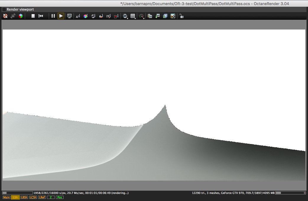

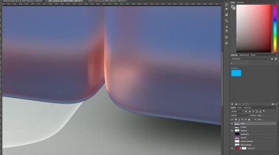

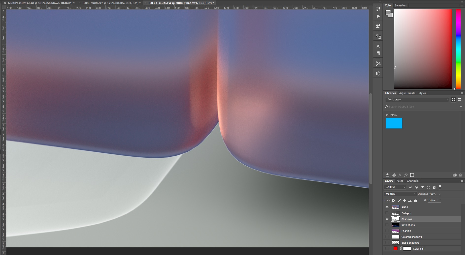

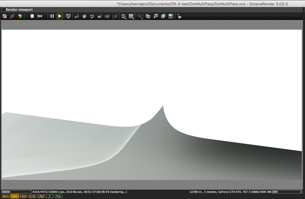

Look at this example:

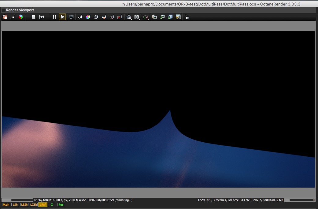

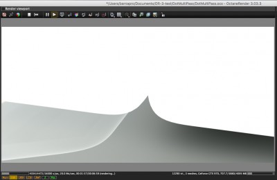

v3.03.3
v3.03.3
v3.03.3
v3.03.3

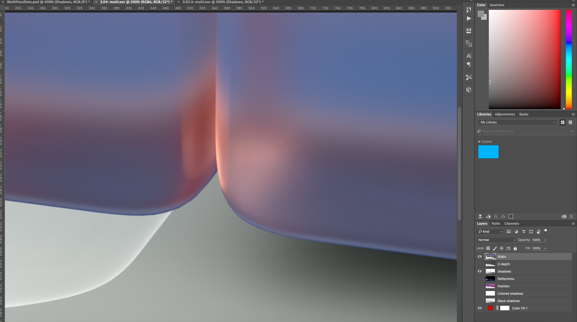

v3.03.3 in Photoshop
with previous versions there is no artifacts but when composed, you have a white halo.

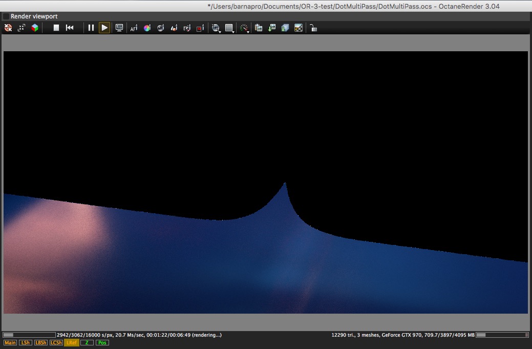

v3.03.4
v3.03.4
v3.03.4
v3.03.4
v3.03.4 in Photoshop
with v3.03.4 you have some artifacts on borders, but the final composed result is correct.

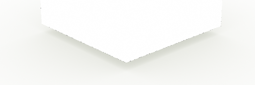

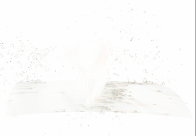

Sorry to dig out this post but I'm using the last 3.04.5-R2 Octane version (windows) and I still get those black artifacts dots in my shadow render! If I use the very same scene as Yambo posted I get this:
In my own project:
Could it be my mistake (render settings) or is it a known issue?
Cheers!
Florian
Posts: 10661
Hi Oather,
as said in the previous message, the beaty pass covers the shadow pass, so the bleck dots will not be visible.
ciao beppe

Oh yeah, sorry I forgot to mention something :D
I'm working on a neon flickering animation, so my scene is really easy: a background with a basic diffuse material and the neon with a glossy material. I did a multi-pass rendering to play with the reflection strength later in after effects. For no specific reason, I was animating the opacity of my neon and at some point I realized that those black dot were visible! But a alpha mask on the shadow pass will do the trick :)

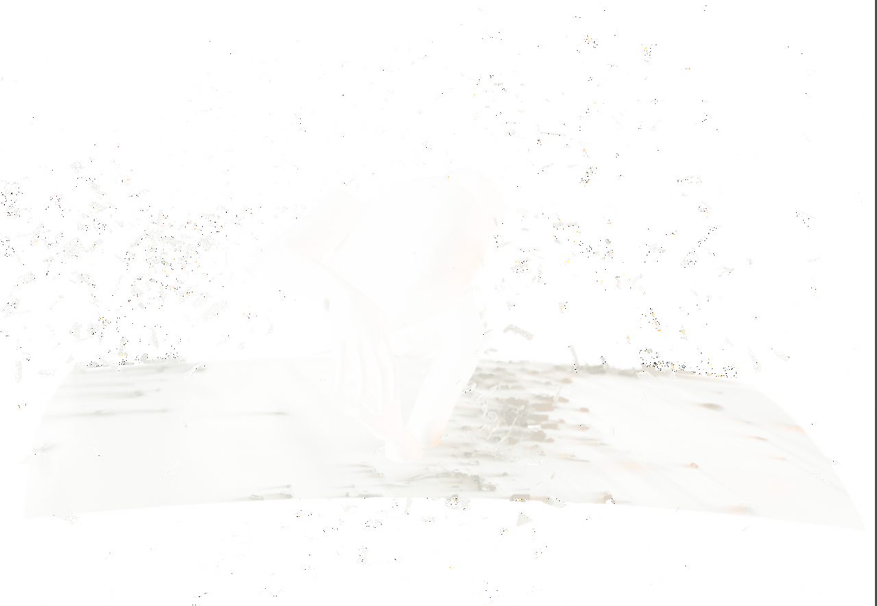

bepeg4d wrote:Hi Oather,
ciao beppe

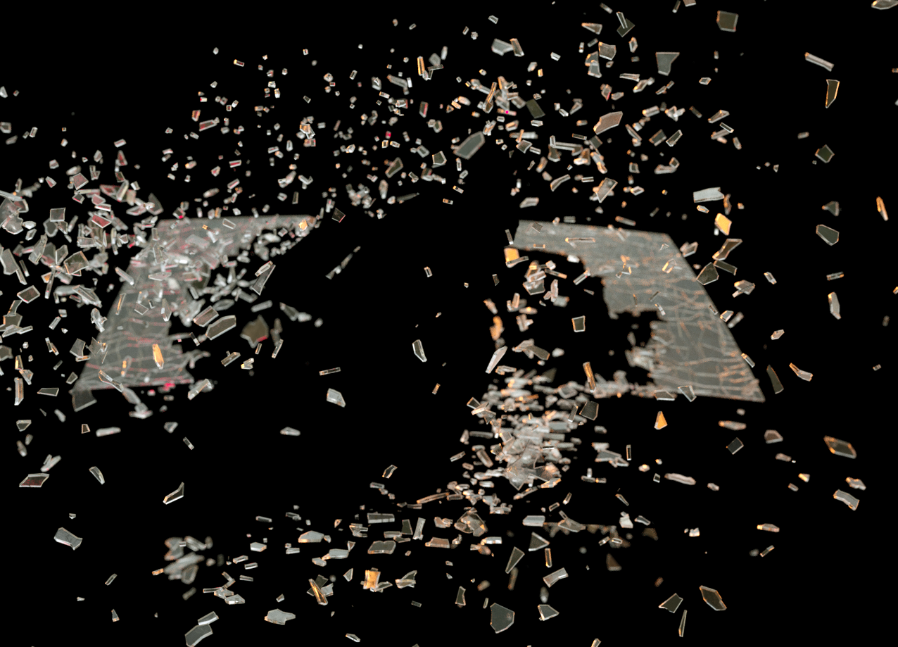

But what when you dealing with glasses :/?
Kind of stuck right now, bummer.

mojave
Posts: 1452
Joined: Sun Feb 08, 2015 10:35 pm
This should be the same case, it's likely that the transparency of the resulting render is near to zero on the glass edges where you see the black artifacts, so you should not see them in the final composited image.
I would need to confirm that, but I'd need the actual result with transparency for testing.
