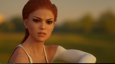

Octane-for-C4D-V3.03.2-R4-win so i think it's the latest!
As you can see in the picture i menage to render all the hair by reducing the segment from 40 to 15 for every hair. But now they are obviusly edgy. I have 2 gb 960 gtx and the scene is about 1 gb o vram. I have 24 gb of ram so i can't understand the problem.

You may think to post scene and bugreport. So we can try to reproduce crash. Otherwise check ram usage and vram usage on export and render. Try to stay in limits. But there's nothing to fix in plugin side i suppose. Anw we read statistics from renderer as triangle or hair counts. I have no idea why hair count is like that.

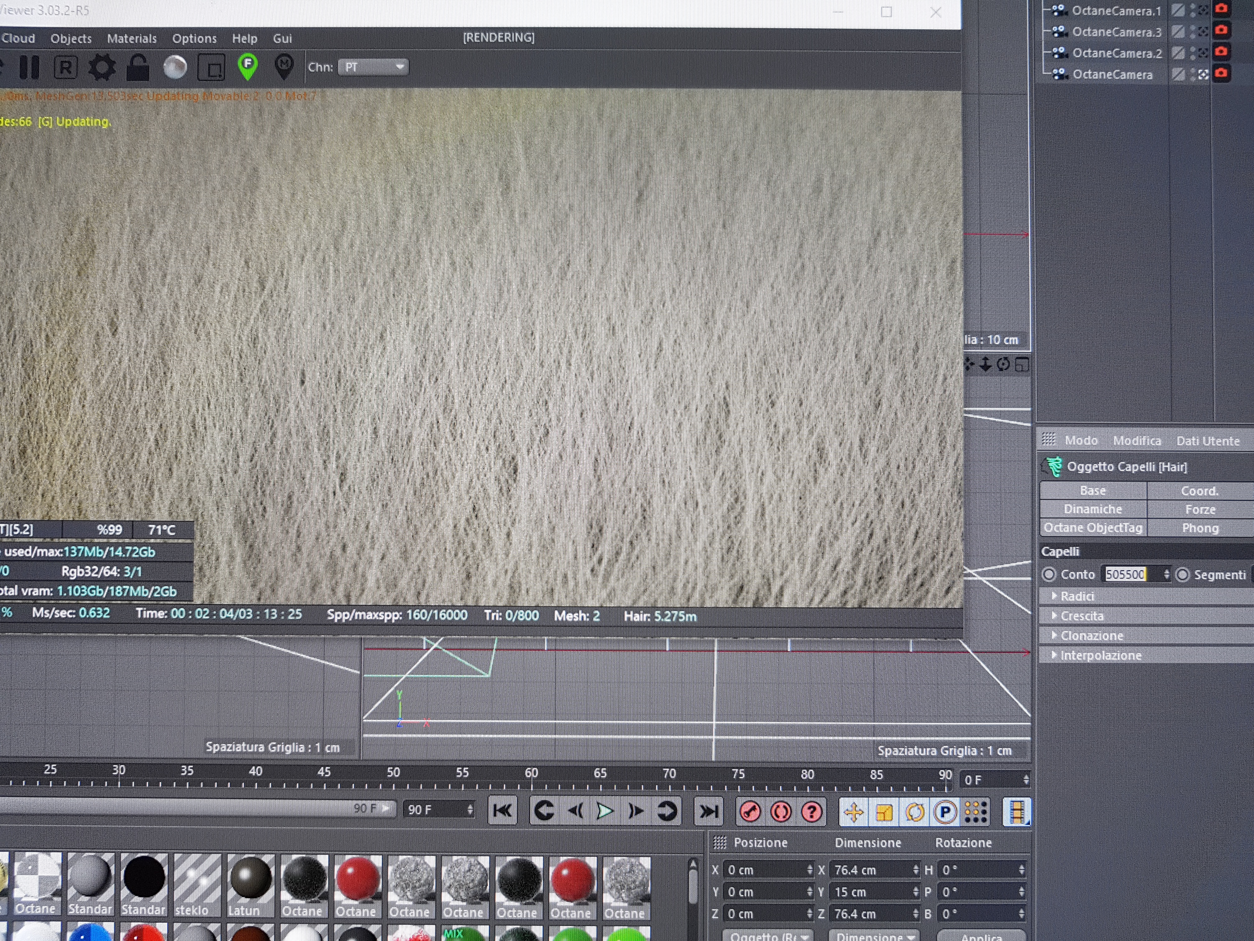

This is a simple example, look at the hair count in c4d and in octane.
I would love to upload the scene here but.. i really do not know how to do it.
