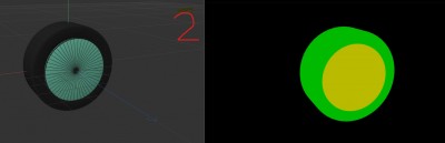

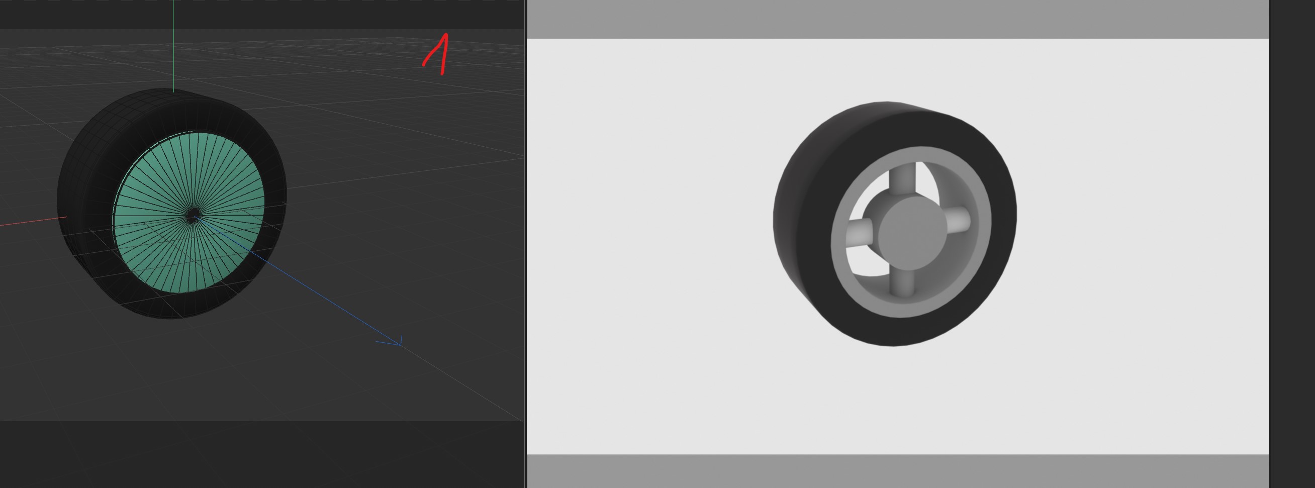

I'm masking out some parts of the geometry, in this case the wheels of a car, with a simple geometry on top of it that is not rendered out on the beauty pass by setting it's layer ID to a different number. That enables me to have the beauty pass, without any other masking geometry visible. (See image 1.)

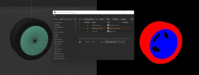

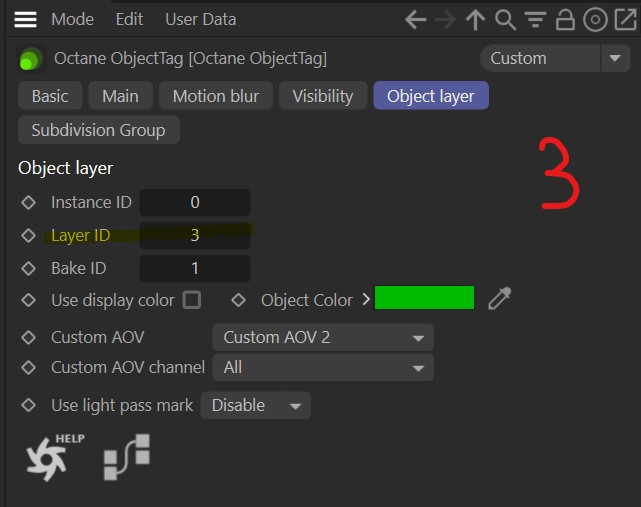

When I add the object layer ID to the Render AOV group as a separate layer, all the geometry shows up color coded as it should, which is great. The problem starts from there. I don't have an obvious way to control the color of the Object Layer ID (see image 3.). It seams it's generated internally and I need to figure out how to assign a specific color (designated by the ML research team)to each layerID. (see image 2.)

I need to have flexibility of color color management for those layers or maybe find a way to use the Display color of the object to drive the Layer ID colors.

I have added a screenshot to show the result of the "Object layer color AOV"

If I understand what you want to do, you could just assign the same layer color to all the objects that are on a given layer?The Render Layer ID solves this pretty elegantly as I can add different label groups to a new Render layer and not worry about having them rendered in the beauty pass. The only thing missing is a way to assign a color to those layers.
Or even share an object layer node between all the objects that need to be grouped, this way they all get the same layer id and layer color.
To clarify, what you want in your last screenshot is for both elements of the wheel to be one single color, say red. Correct?

Solution 2, simpler but maybe there are too many objects: don't use render layers or proxy objects, go into the object layer of each part and assign the color corresponding to its category. Then save beauty and object layer color.

Another solution that might be closer to what you are trying to do: use a null material on the proxy objects. This way they won't show up in the main beauty render, but they will still show up in the Object layer color AOV.
In this case there is no need for render layers, you can save the beauty and the segmentation map in one render.
