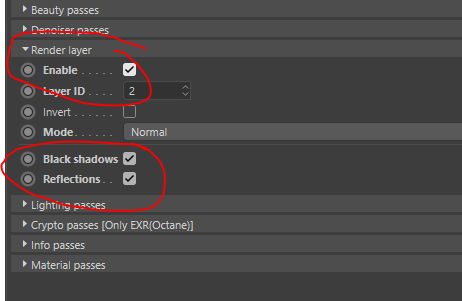

Have you tried the Render Layer option? Putting your character on one layer ID, then enable Render Layer with that one layer ID and enable black shadows and layer reflections. It works as intended sometimes for me. But not always.
Thanks. Unfortunately the Render ID option isn't working: The reflection also calculates the HDRI from the environment tag. I can't separate it from the reflection of the character.bigskyedit wrote:Have you tried the Render Layer option? Putting your character on one layer ID, then enable Render Layer with that one layer ID and enable black shadows and layer reflections. It works as intended sometimes for me. But not always.

just so were clear, you are enabling this, correct?
This shouldn't show the reflections of the HDRI, just the reflections of any object on this Layer ID.

Yes, exactly as in the screenshot.
