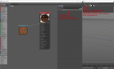

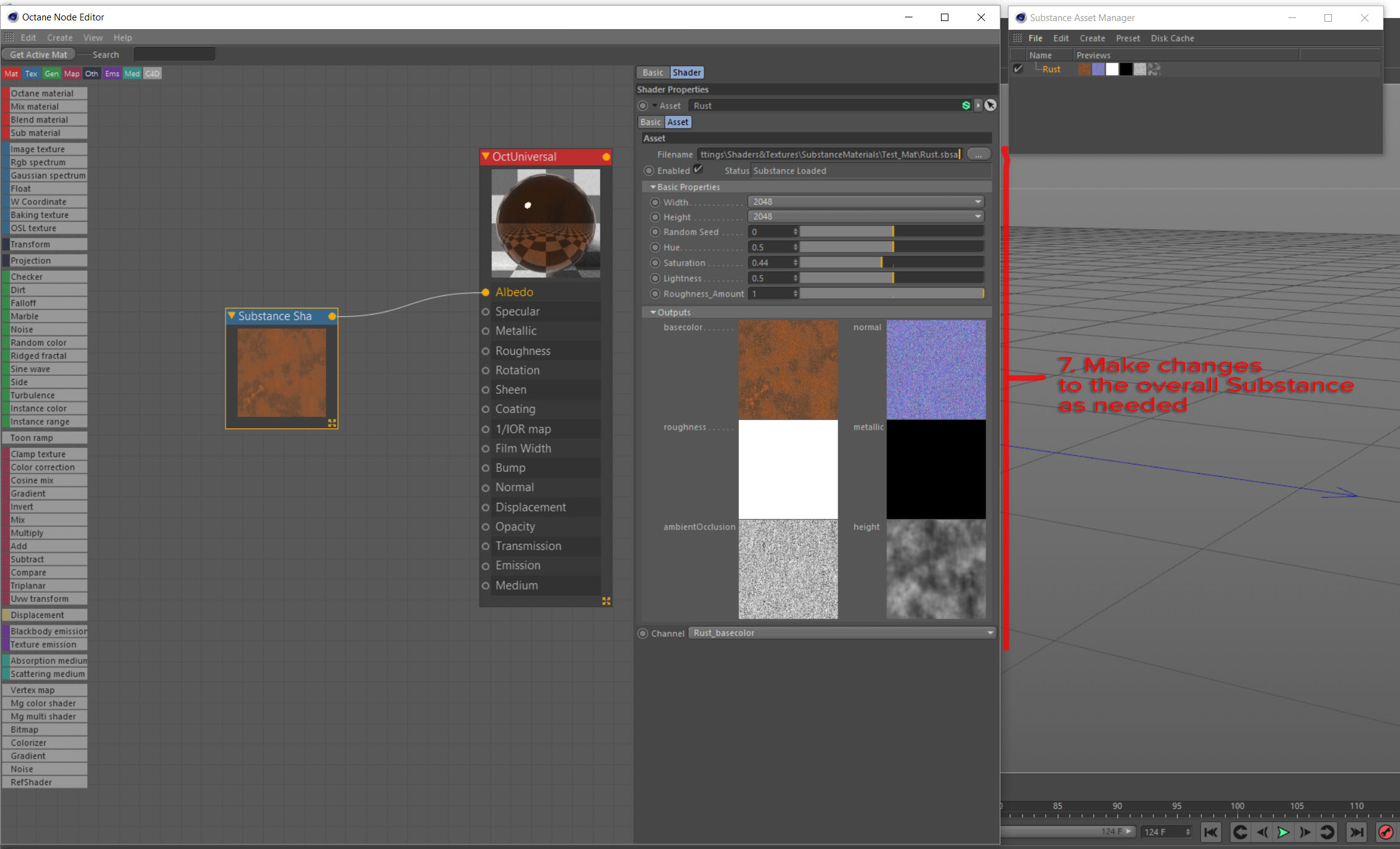

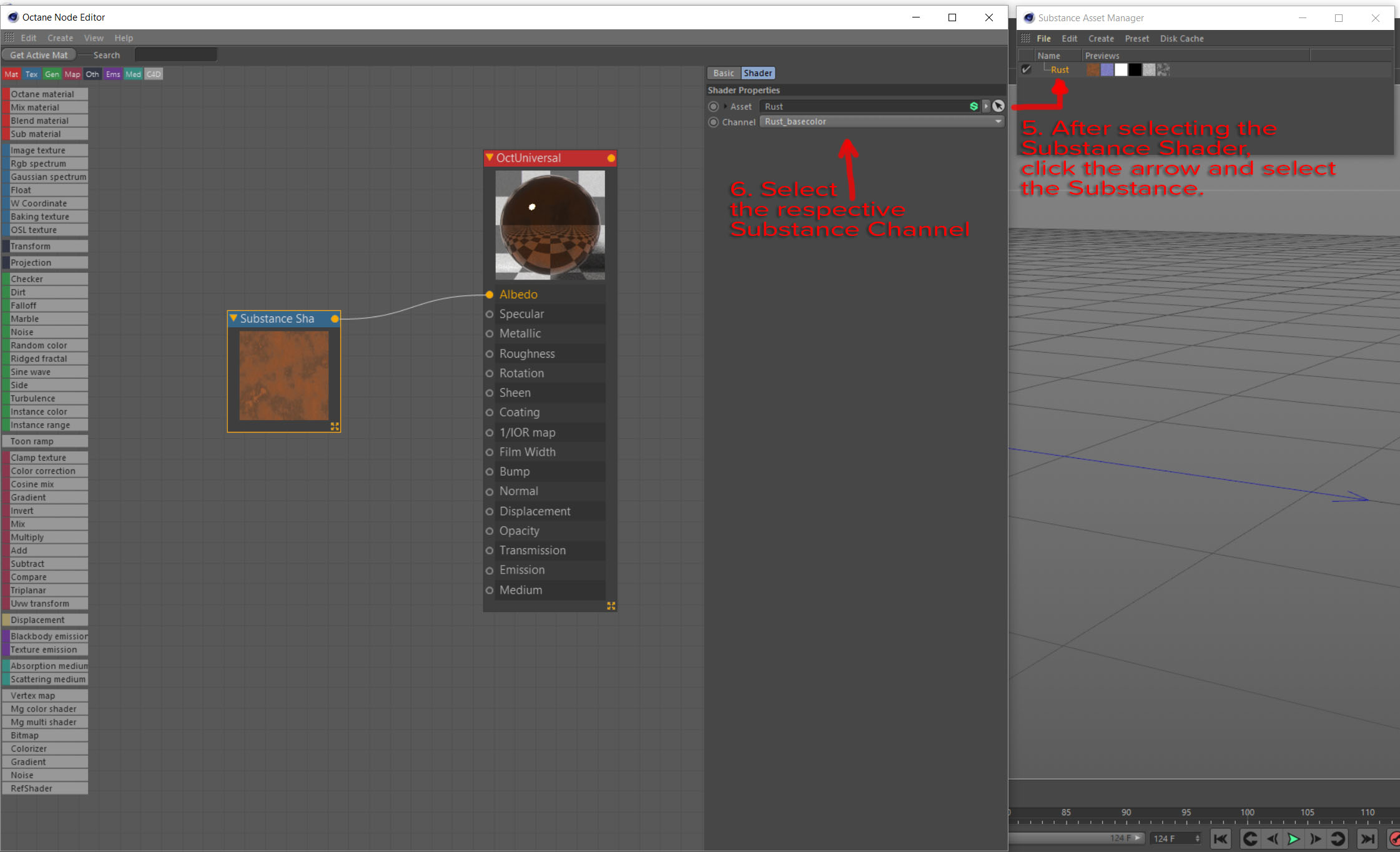

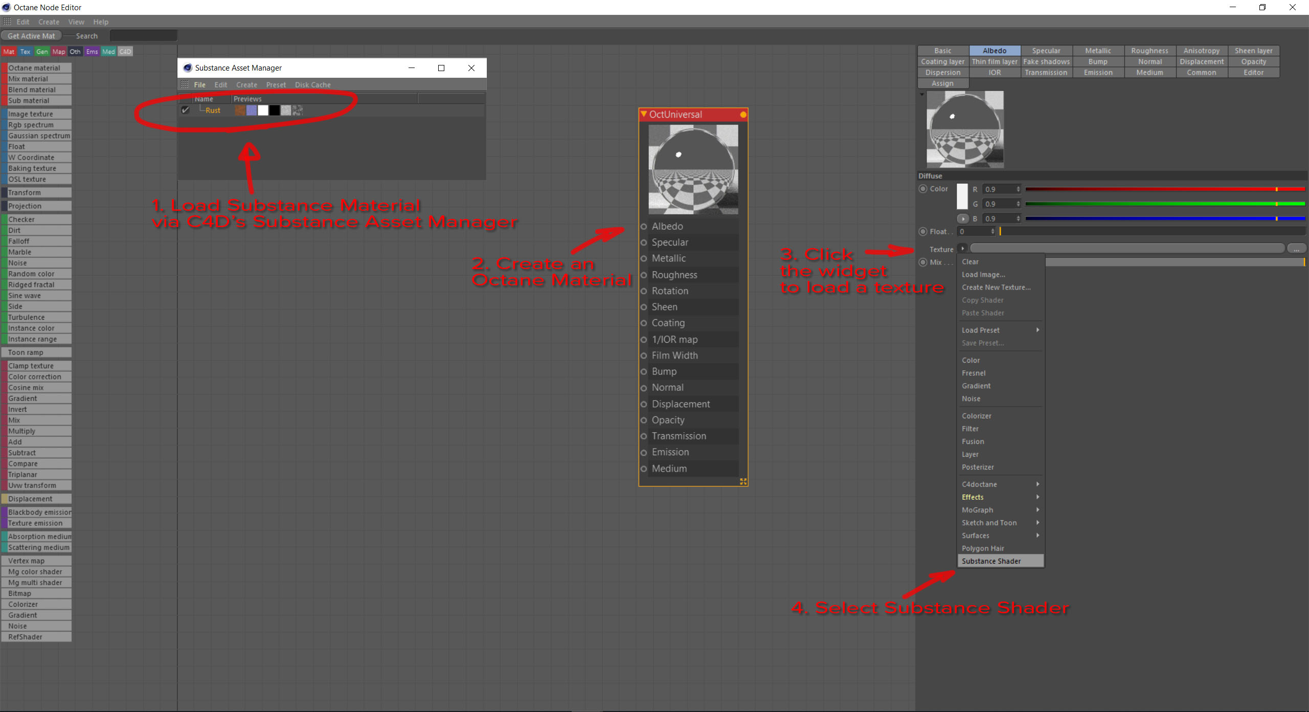

Hi everyone,

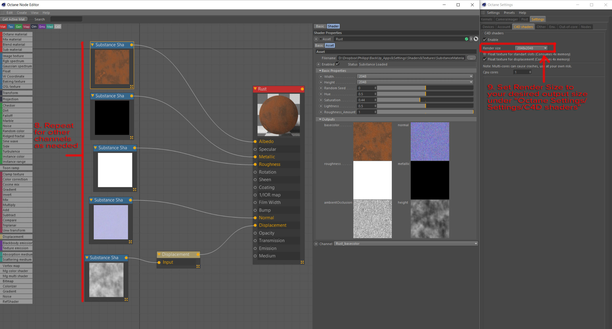

It seems like I finally managed to wrap my head around how to use 'live' Substance Materials with OctaneRender for Cinema 4D. Here it goes:
Please correct me, if I'm doing anything wrong, or you know a better way to do all this.
Now, I've already discovered, that this isn't the most elegant way to work with Substances, mainly for two reasons:
1) The Substance Shader node doesn't remember the previous asset when you copy/paste or drag/copy it, so you literally have to repeat the node creation process for every single channel.
2) Since you're creating a node for every channel, you'll also have to go through every node one by one, if you'd want to change the Substance Material later.
As it stands, working with Substance Materials in Octane will involve a lot of clicking and 'mousing around'.
So this one goes out to Aoktar: Would there be a way to have a Substance Shader node in the Node Editor that would have dedicated 'output pins' for each channel contained within a Substance Material? That would make the process almost seamless and would allow for much faster management and changes.
Also, setting the 'Render Size' under 'C4D shaders' in the Octane Settings tells me, that working with Substance Materials in this way might be considerably slower than using the 'old method' (i.e. exporting texture sets from Substance and then connecting them to materials via Image Texture nodes), as Octane will have to bake each channel into a texture, prior to rendering. Is there a way to make this more efficient?
Looking forward to hearing your thoughts!

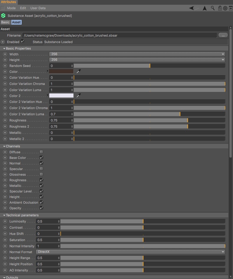

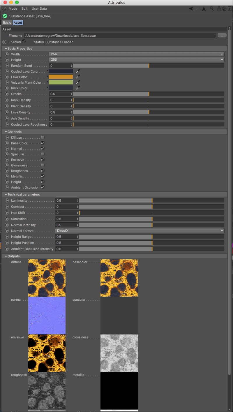

Let me add that Substance in C4D is non-destructive and editable, you can alter your material without creating a new export.
This is were Substance is powerful.
You can download a base material from 'https://source.allegorithmic.com/' and make it your own in-line in Cinema without using an extra program.

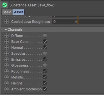

aoktar wrote:I'm open to add some extra support. But I'm not good on Substance. One question goes to you, why don't use saved images from substance? Isn't faster and better on quality of result?
To get this to work in Octane, you would need to look at the Substance Asset attributes and see what Channels were being used. At that point link them to their Octane equivalent. The issue is not all Channels are used for each Substance so I'm not sure how that would affect everything.
Screen Shot 2018-11-26 at 10.33.26 AM.jpg (30.24 KiB) Viewed 14284 times
Screen Shot 2018-11-26 at 10.33.35 AM.jpg (27.72 KiB) Viewed 14284 times
Screen Shot 2018-11-26 at 10.33.47 AM.jpg (22.07 KiB) Viewed 14284 times
