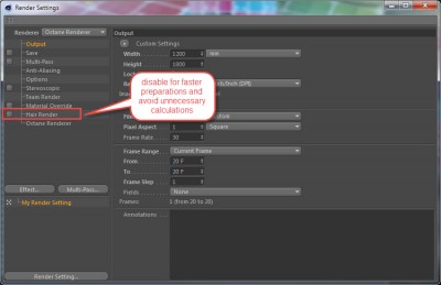

It may not be as your expectations in background process. If it's only working fine with "transform/vertex" that's the way to go. Also see/read this picture for a hint.renderingz wrote:I'm just trying to figure out if there is a way around it, the mesh deforms, but again the hair isn't dynamic, so the hairs only change position/rotation. Is this the behaviour you would expect?
