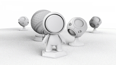

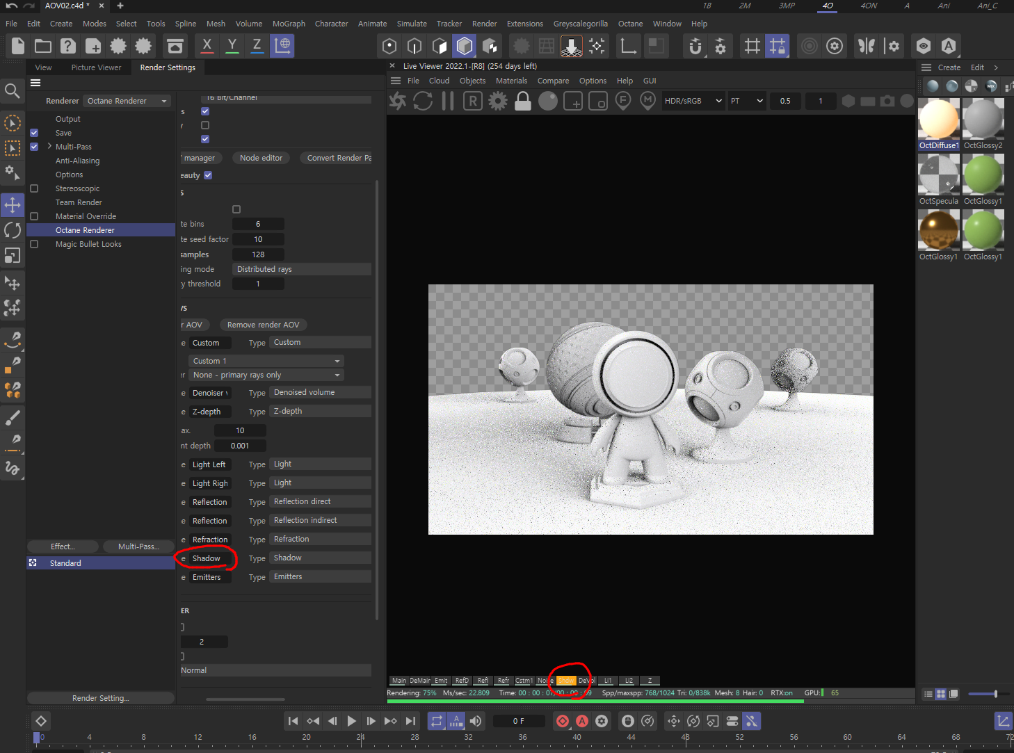

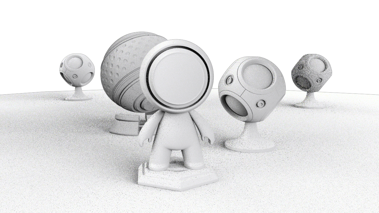

Hi.
Can't render without noise?
Is there any way to render cleanly?
Posts: 10611
sorry, it is not plugin related, there is an issue in core SDK between Shadow AOV and Texture Environment.
If you replace it with a DayLight Environment with 0° P rotation, the Shadow AOV should be ok.
The issue should be fixed in the next SDK update.

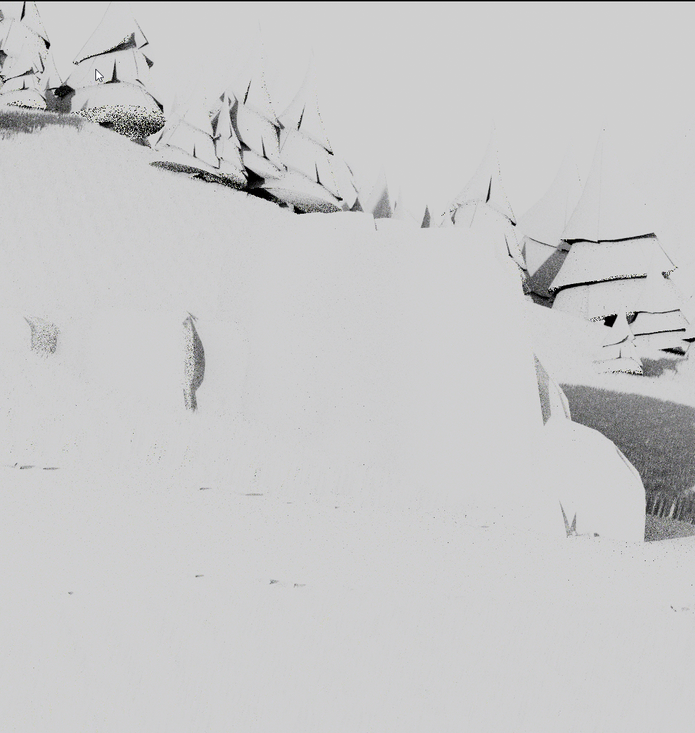

So basically the whole compositing abilities of octane are broken in this release? When can we expect a fix and a clean shadow pass instead of this:
Though I have to say: I always struggled to get a clean and useable shadow out of octane...
6850k // 32 GB // 1080, 1080 Ti, 2080 Ti // Win 10 // C4D 19.068
Posts: 10611
The issue with Texture Environment and Shadow AOVs has been already solved in 2022.1.1 SDK:
viewtopic.php?f=24&t=81415
Plugins will follow shortly.
