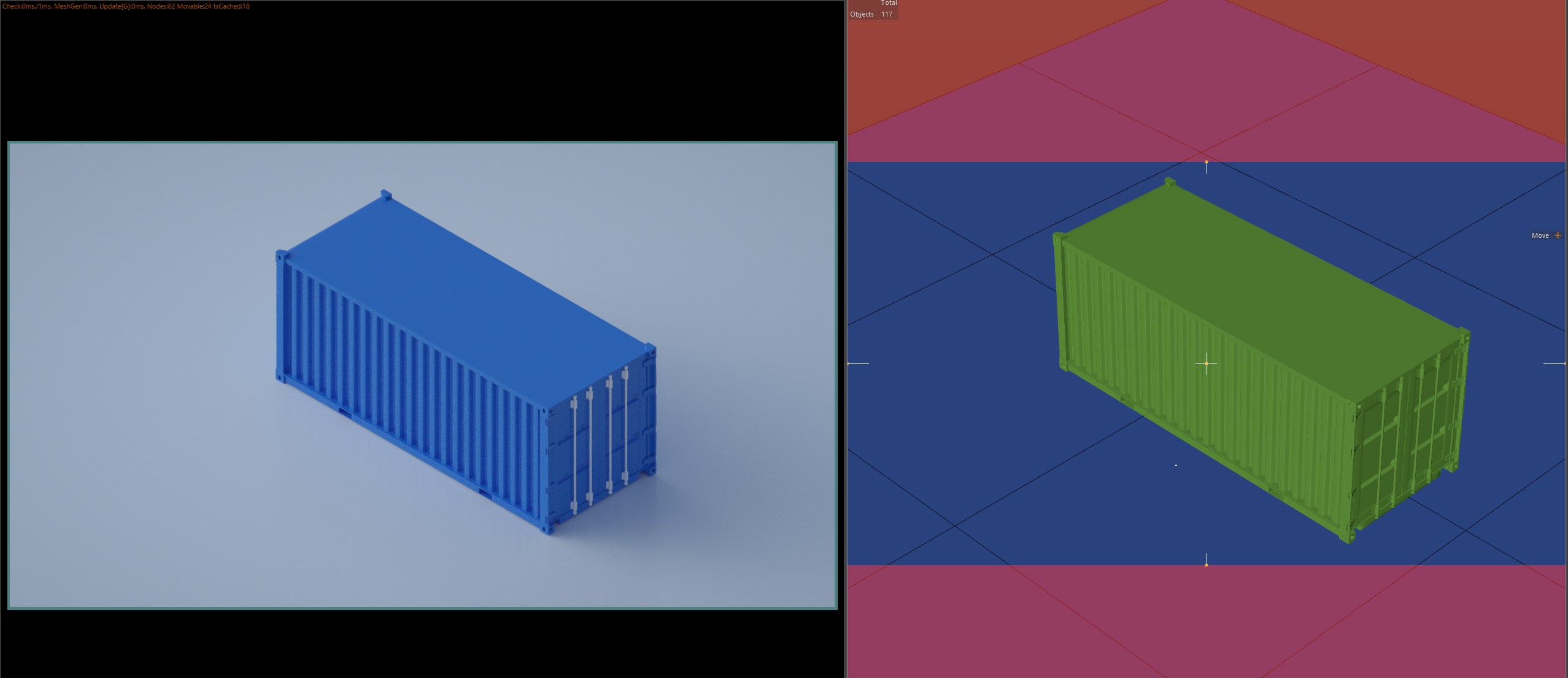

Is there any way to get a PROPER isometric camera inside Octane? The workaround with 45 degree for H and -35.264 for P seems to work on the first look, but when you compare it to the build in isometric camera its pretty off. Please see attached comparison of the Viewport and the renderview and you'll see what I mean.

The RAR contains two files. 02 is with some different Camera Settings which seem to achieve a closer match.
For comparison: Arnold gives a perfect match out of the box by setting the camera to parallel which allows a simple scaling of the scene by just using the zoom value inside the camera.

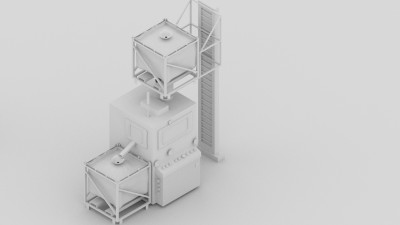

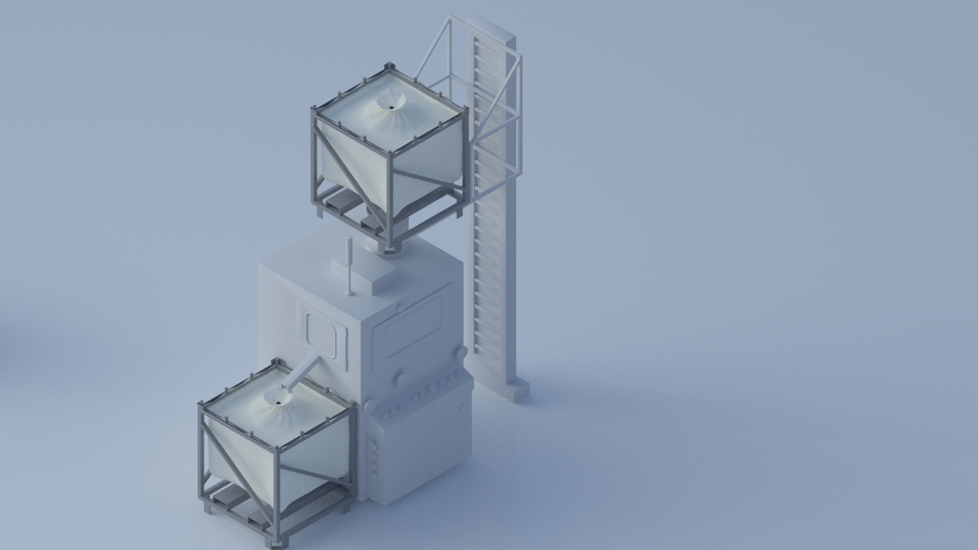

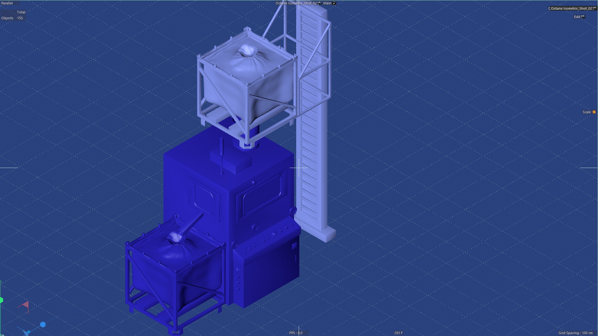

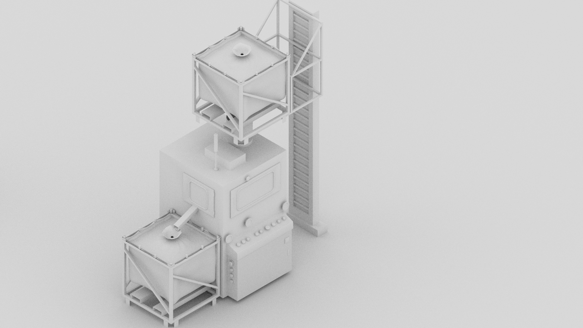

Just tested the whole thing... looks like Octane just can't get it right. Arnold recreates the Viewport perfectly, Octane is off as soon as you render it. We would probbably get away with it in the final project, but animating is kinda tricky when your safe zones are useless. Camera is the same, only the camera tag is different.
I just don't get it how this feature is not production ready in the year 2021...
