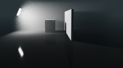

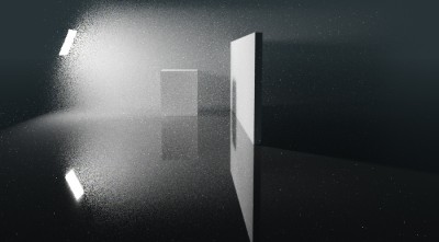

There were multiple requests on the forum for some kind of solution for simple, even fake, 'visible' spotlights or fog effects. Right now we can either change the settings to AO or render volumetrics separately. But what if the rest of the scene needs Pathtracing and we only need one (god?)ray of light coming through the window? Can we just reduce multiple scattering in the volume but still keep our shadows somehow? Well, now we can do that.
Here's a light source inside a volume rendered using Pathtracing kernel, Max. samples 128, No GI clamp. We get a ton of fireflies everywhere.
If we make sure our lights are only emitting direct light we get some improvement. Notice how fireflies are only focused around our lights and the rest of the scene is clean. That means adaptive sampling will be able to do a better job detecting noise.
If we go a step further, using the Camera ray option, we can make direct light only visible in the camera. We loose our reflections, but we get a super clean render. This is great for stage lights, spaceship thrusters, spot lights and all those cases where lights are too small to have a significant effect on the overall lighting in our scenes but it's just enough to cause a lot of noise everywhere.
