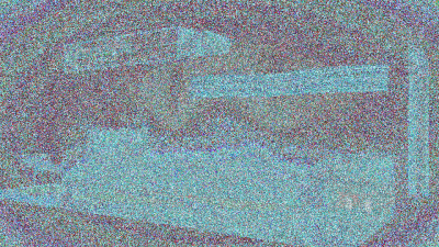

Hi Face,
My Render using the plugin has problems.
Look At this image. What´s Happening?
Windows 7 Ultimate 64-Bit, Intel I7 980x Extreme, 6GB ram, Nvidia Geforce GTX 580

Postby face » Thu Sep 12, 2013 6:37 pm
face Thu Sep 12, 2013 6:37 pm
Yes, its a bug.
But what i don´t understand, some other renderers have also some fullscreen passes, without this error i think.
Must take a deeper look...

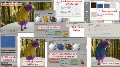

Postby Gescort » Wed Sep 18, 2013 9:39 pm
Gescort Wed Sep 18, 2013 9:39 pm
Hi Face,
bug with update texture.
Gescort

Postby face » Thu Sep 19, 2013 2:48 am
face Thu Sep 19, 2013 2:48 am
Thanks Gescort,
there isn´t a check for texture names, will implement it in the next version.
face
