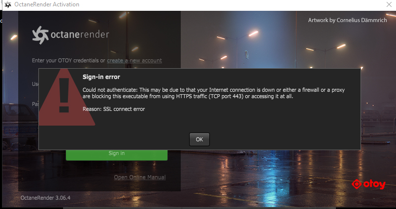

Hi, I hope that someone can help me and it may help someone too.
I had installed a TP-Link usb wifi adapter. Since then was impossible activate the license. I connected again the ethernet cable and it still happend.
After many tests, the way I foud to solve it is that each time that it lost the license, f.e. when launch a batch render, I have to shoot down the computer, disconnect for a time the power cable, connect it again, restart and activate the license.
Anyone know how to fix that problem. Thanks a lot

Hi Maskeline,
The error shown is thrown by the underlying cURL library when it is unable to complete the SSL handshake, either due to a protocol error (i.e. You are using a proxy that is not correctly configured for SSL) or a certificate error (Either a proxy, or your firewall software, is performing MitM with all your internet traffic, resulting in a certificate that is not trusted by your machine). As you mentioned a WiFi card, it is possible that if you are connecting over a corporate or public WiFi network, your traffic is passing through a proxy.
I recommend the following:
  • If you have firewall software installed, disable it completely and try again.
  • If you are connected over WiFi (especially if it is a corporate or public network), try connecting over a wired connection instead.

Thanks hellguy, but I don´t have a firewall software installed and although i had installed a wifi pen drive, I´m connecting over a wired connection and still happend.

If you are not using either a firewall or a proxy, perhaps your root certificate authorities settings have been messed up for some reason.
To reset your CA store using the latest version from Windows Update open a command prompt (as Admin) and run the following:
Code: Select all
certutil -generateSSTFromWU roots.sst
certutil -addstore -f root roots.sst
Full documentation from Microsoft.
Please let us know if that helps.
