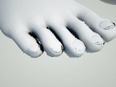

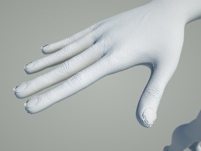

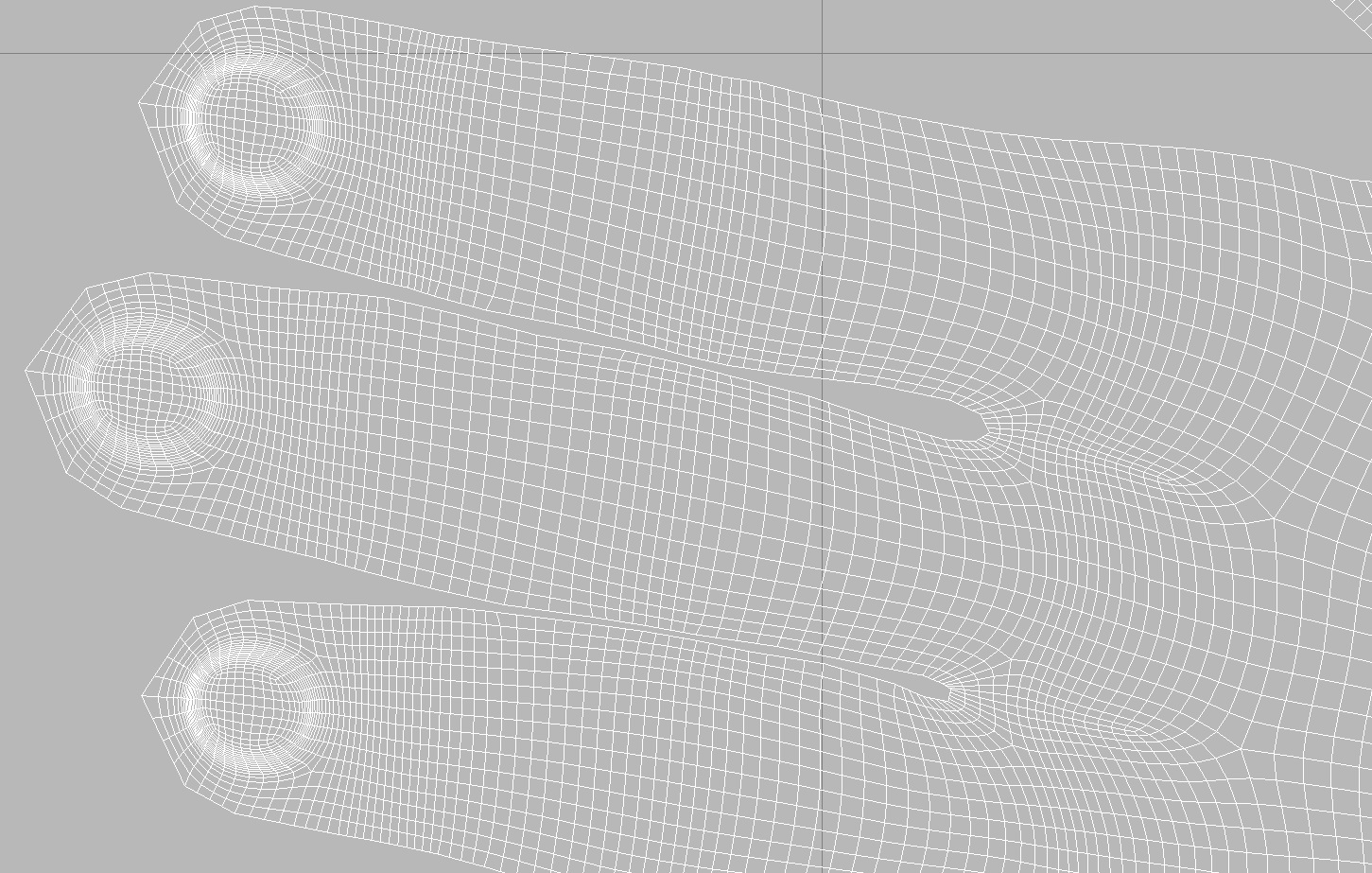

I set up an octane diffuse material with an 8K displacement map I generated in zBrush. the character body displaces fine but the hand/feet fingers are messed up. in mental-Ray this setup renders successfully with no artifacts. What am I doing wrong here?

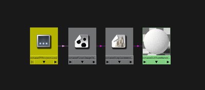

examples and setup:

Thanks for the notes and for your fast reply prodviz.

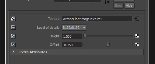

I'm using a 32bit EXR file for the displace map and I'm doing the negative shift in the amount.
Maybe JimStar will have a clue to what is going on here. Displacement is a crucial feature with my work and I'm sure of others.
If someone experienced the same artifacts please let us know.

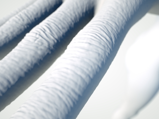

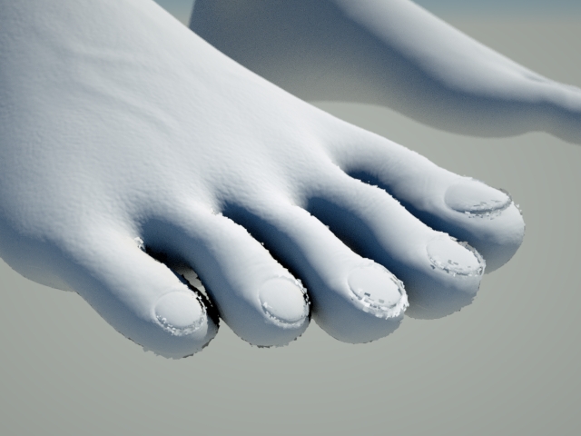

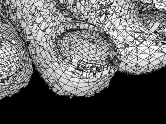

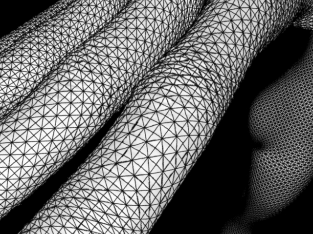

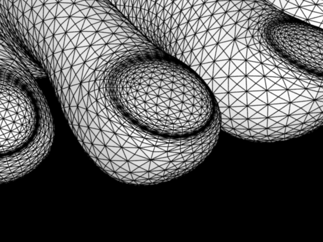

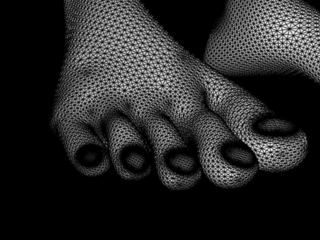

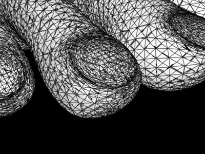

After some experimenting I noticed that when the poly object is hard edged, there are no artifacts when displaced. the artifacts occur only when I introduce edge normal smoothing...
displace with with no normal smoothing.
displace with with 30 degree normal smoothing.

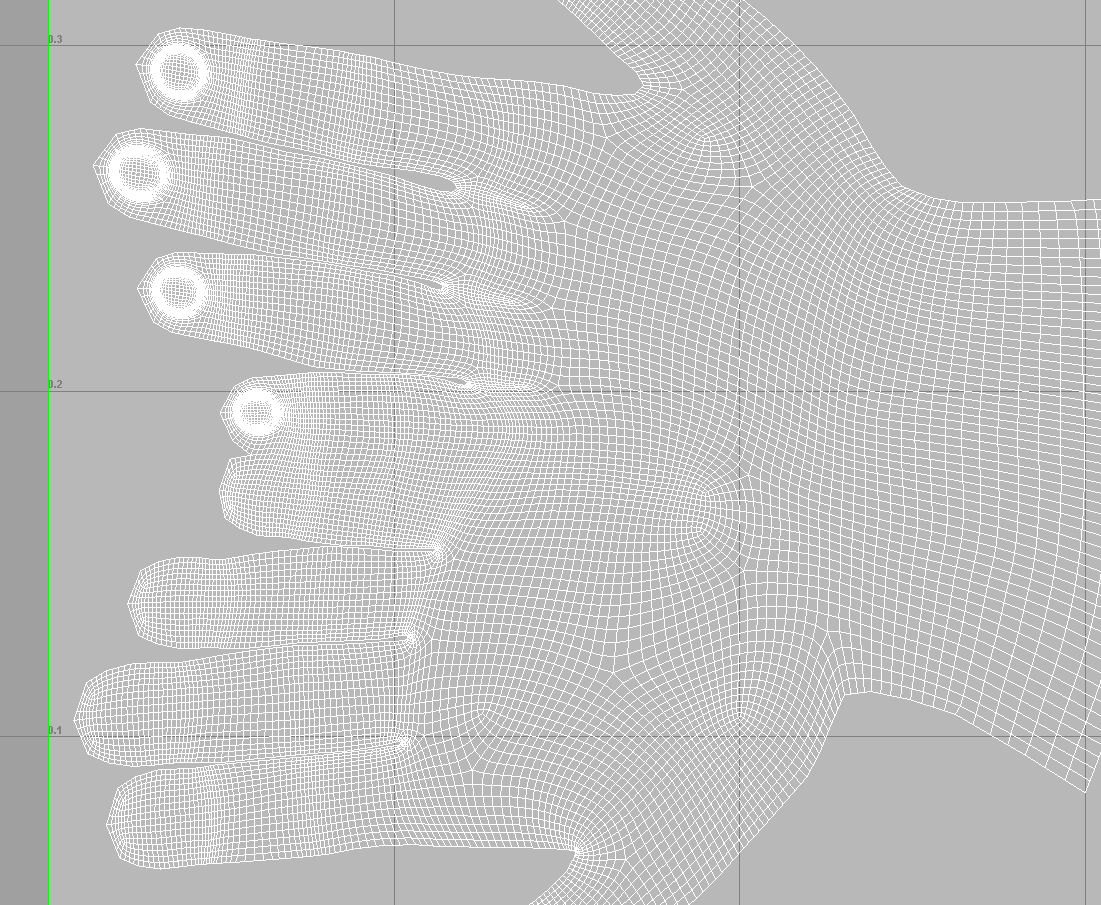

wireframe render - displace with with no normal smoothing.
wireframe render - displace with with 30 degree normal smoothing.
wireframe render - no displacement
2x Xeon E5-2620, 32 GB RAM, 4X GTX1080ti, Windows 10, Octane 3 for Maya 2018, Radeon HD6450 for disply BRIO Animation ltd

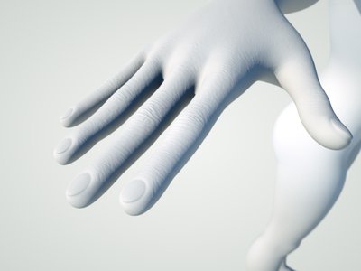

Zbrush displacement export setting:
-16 bit map!
-mid value = 0, to eliminate the use of negative shift in the amount.
it seems that the 16 bit map is the main issue here. all experiments with 32 bit map failed!
With the 16 bit map, all artifact were cleaned out:
-16 bit map!

Yes, looks the same but it seems that octane renders faster.
