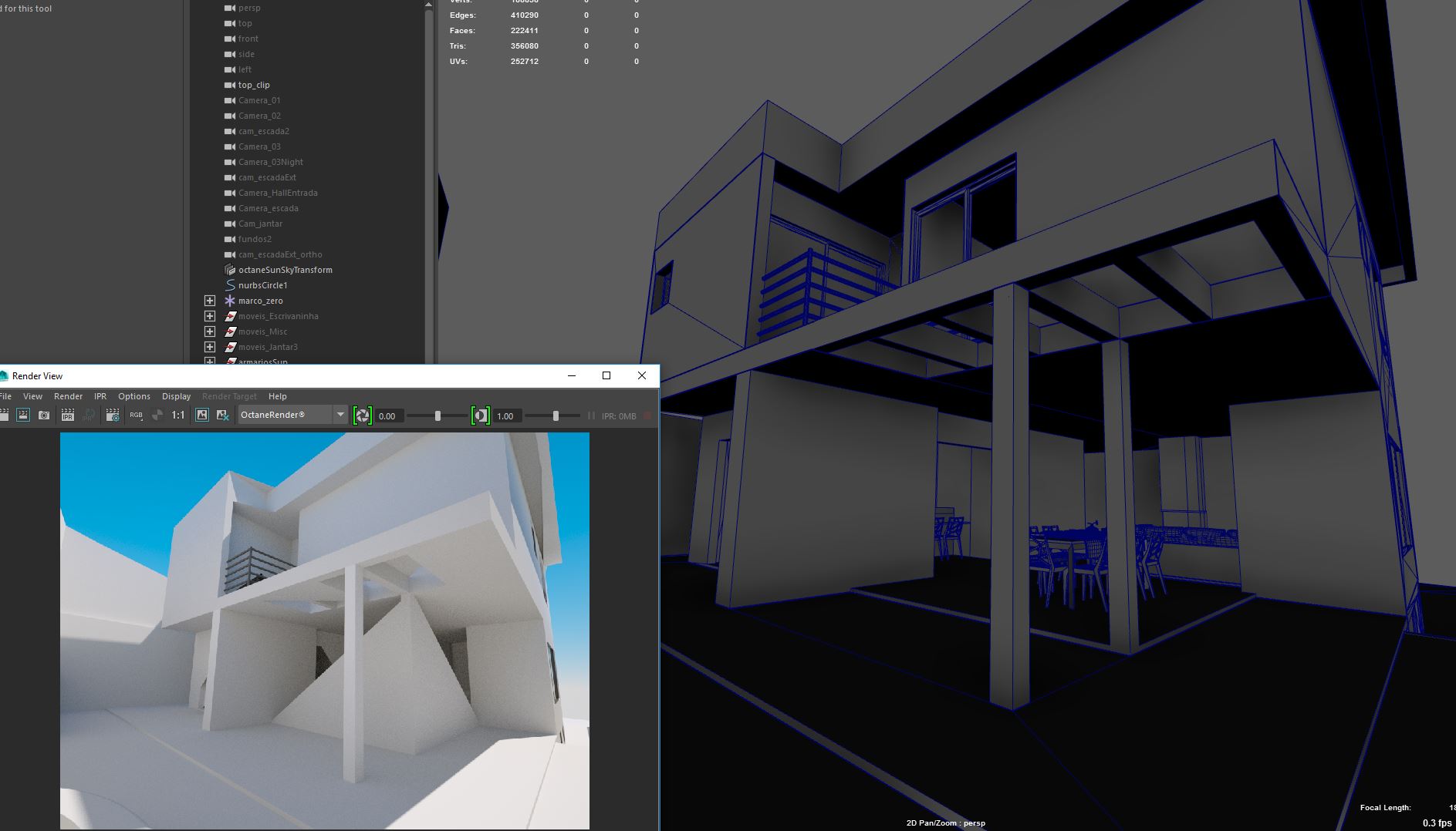

Personally I don't fancy those beautiful volumes, I'm a man of simple tastes. I'm hoping for:
1. correct triangulation of concave polys,
2. a hardware shader that shows better in the viewport (transparency, color management) and...
3. parses the usual parameters to exporters like fbx.
4. baking to texture
Is any of that in the roadmap?

Texture baking we will be looking at. Can you give us some more detail on 1,2,3 please maybe some examples of what you mean? Octane 3.0 does not support fbx, and what was the issue with concave polys originally? Feedback most welcomeivankio wrote:Personally I don't fancy those beautiful volumes, I'm a man of simple tastes. I'm hoping for:
About the first point of Ivanko this is an Octane limitation, not the plugin, Octane doesn't support concave polygons.haze wrote:Texture baking we will be looking at. Can you give us some more detail on 1,2,3 please maybe some examples of what you mean? Octane 3.0 does not support fbx, and what was the issue with concave polys originally? Feedback most welcome
But the plugin could be more clever, pre-tessellating non-convex polygons.
(Actually this is already the case when exporting trough Alembix/ORBX)

1, 2: will have a look after the overhaulivankio wrote:Personally I don't fancy those beautiful volumes, I'm a man of simple tastes. I'm hoping for:
3: see hazes answer
4: Yeah version 3 will have a texture baking camera node.
I posted that previously on the user requests forum:
viewtopic.php?f=111&t=54008
About parsing material parameters to exporters (like FBX), let me try to explain:
Octane Render is not the only output tool we use for our projects, specially now with VR.
I guess that's a reasonable common workflow to assume, after all even Octane added the bake texture functionality.
Currently I have to branch my scenes when it's time to render (specially also because of the triangulation requirement). Then the client asks for a change and I rework it on the clean exportable scene. Now I want to render with Octane again, but the Octane scene is not updated. It has the octane materials applied, but it's too clumbersome to edit. I have to either import, triangulate and reapply the materials from the clean updated scene, or edit the Octane scene.
I wish I could work on a single Maya scene to render and send meshes to Unity. This is important when changes are needed. To that end, it would be nice if the hardware shader could parse to the exporters common parameters like albedo/diffuse color, opacity and normal map (even roughness and specularity although that would change drastically between renderers). I never meant to use fbx with Octane. Just that Octane materials could feed it's parameters to exporters. The override mentioned on the user request post could be good enough, although it's not nice to deal with double materials in the libraries.
But yeah, wrong triangulation of concave polygons and lack of viewport transparency*transmission*opacity are the biggest issues that are too outdated limitations. I can live without the exported parameters and texture links if at least the material names and assignment are kept. (although it get's more uncanny since Octane can bake lightmap, but can't embed or link into the emissive channel of a mesh being exported)
Meanwhile I'm catching a breath before once again reassigning all materials, triangulate the thing and hope that this is a wrap.
