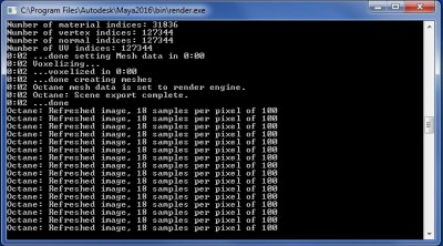

I am having issues with Batch rendering with Octane for Maya.
When I try a normal batch render from the Render-Batch Render option, It says:
Result: Rendering with OctaneRender®... //
but then nothing ever happens.
Next I closed out of Maya and right clicked on my scene, then hit render. This time I got more info, but this time it just does this forever.
[Check out Attachment]
I am also using GPU-Z to and my GPU load never goes above 0% using both methods.

Update on my situation, now IPR and normal frame buffer render stopped working.
I have tried:
unloading and reloading the plugin
rebooting
reinstalling both standalone and the Maya plugin
making a clean scene and importing the old scene
So far nothing has worked.
When I hit IPR render it renders to 18 samples and stops every time even though I have max samples set to 5 thousand.
When I hit normal frame buffer it just freezes Maya.
