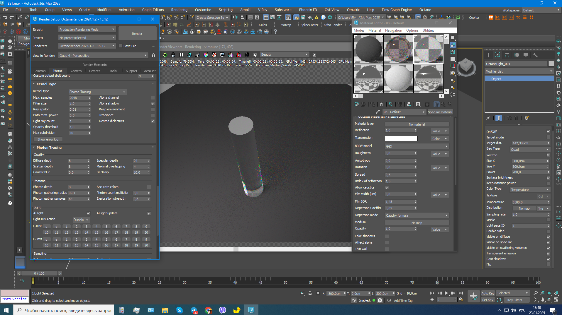

How to work with caustics? I do everything according to the lesson, from metals the caustic is very weak, but there is, but from glass there is no caustic at all
increasing the power of the light source does not give any effect, the IOR setting also has no effect, The checkbox for displaying caustics in the material is selected
OctaneRender® for 3ds max v2024.1.2 - 15.12
https://help.otoy.com/hc/en-us/articles ... ing-Kernel
3ds max 2025.3
win 10
4090 rtx
566.36 game ready
Caustic does not work in glasses, Photon Tracing Kernel

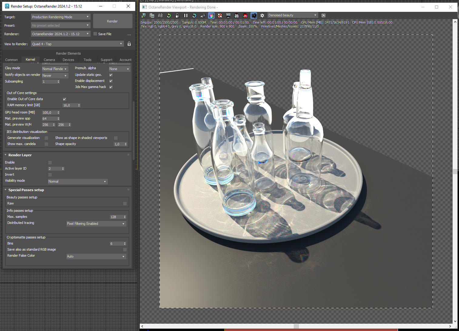

Hi Elvissuperstar007,
The caustics are working, so the issue might be with the scene setup. It looks like you're using a very large light source, which naturally creates diffuse shadows and tends to diminish the caustics. On the other hand, point-like emitters will emphasize the effect.
Regards
Paride
Regards
Paride
