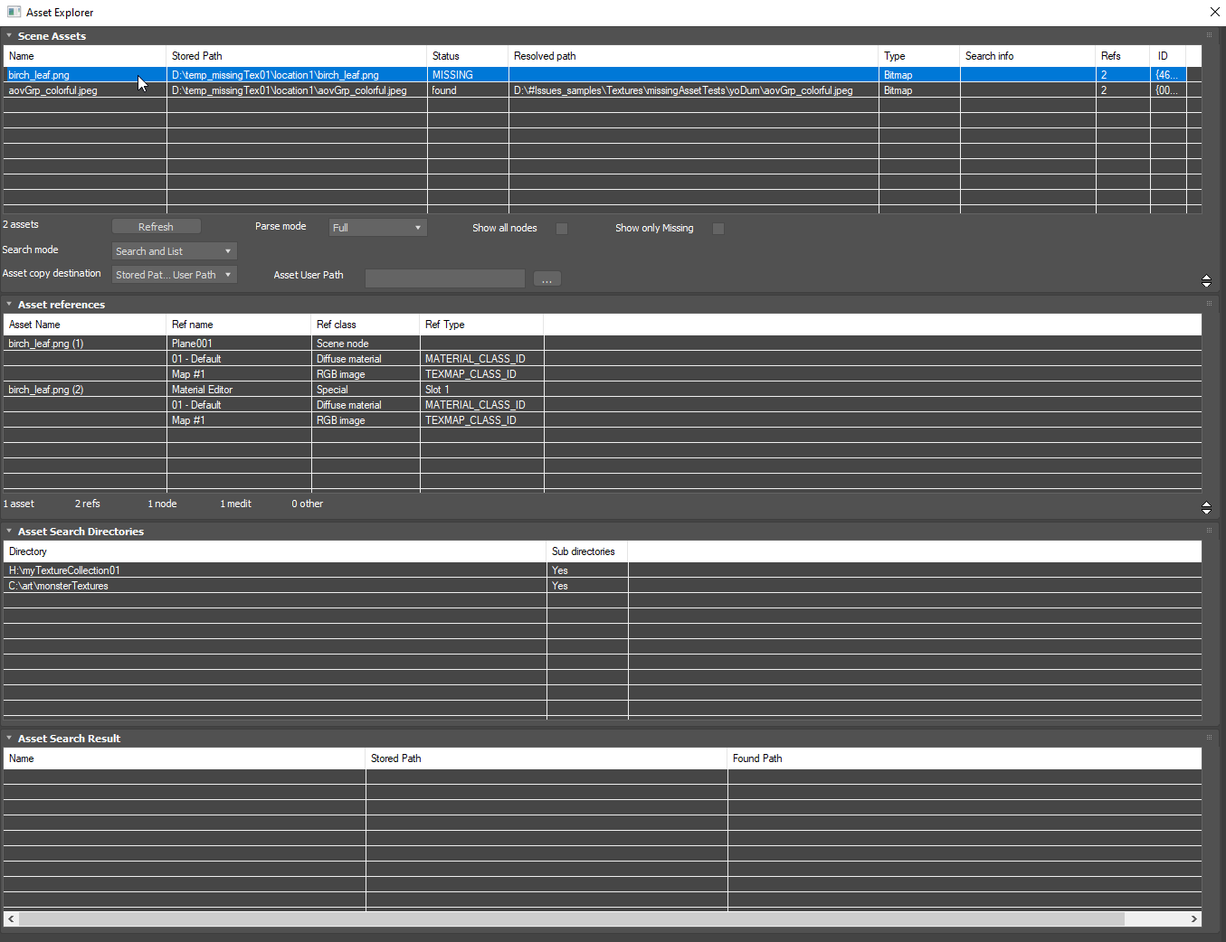

There are 4 rollups:
---------- 'Scene Assets' rollup: ---------
THe main table has the following columns:
Name is the base filename, without any path.
Stored Path is the path and name as stored in the scene data. This is the same as the 'Full Path' listed in 3dsMax Asset Tracking window.
Status shows 'found' or MISSING'
Resolved Path is the path where the file was actually found by 3dsMax.
It can be different from the Stored Path if the file was not found in the stored path, but found in an alternate directory, as set in 3dsMax 'Configure Project Paths / External files' of Asset Tracking
Type is one of the 3dsMax asset type.
Search info displays the result of the last search, for missing assets
Refs is the number of references of this asset. Those will be listed in the 'Asset references' rollup
ID is the internal unique ID of this asset.

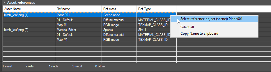

------ 'Asset references' rollup -----
When selecting one or more assets in the Scene Asset rollup, all references will be listed there, with the full tree of materials and textures leading from a base node to a particular asset.
Note that no references can be listed when the Parse mode is 'Global'.
The top of the tree (root object) of a reference shows the Asset Name, and the other sub items will show an empty Asset Name.
Use the right click on this root object to open a context menu that allows to select this of those objects in the scene, or a slot in the select the matching slot in the Compact material editor.

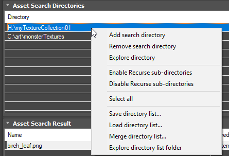

----- 'Asset Search directories' rollup ------
Use the context menu to add or remove directories.
There are also options to save and load those directory lists.

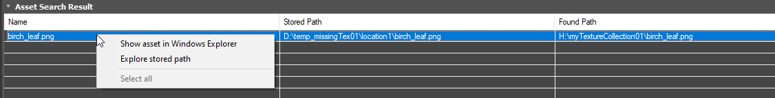

----- 'Asset Search Result' rollup ------
Will display the first location where assets have been found by the last search.

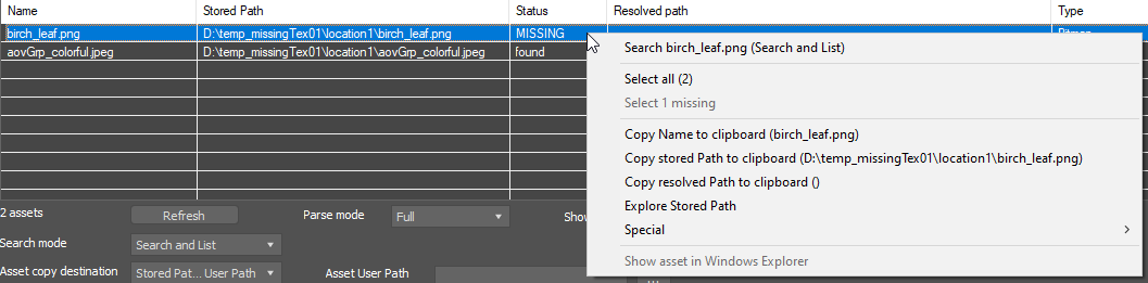

------ Searching for missing assets -------
-Add one or more directories in Asset Search directories.
-In the Scene Assets rollup, select some of the missing assets, and right click to open the context menu
The first option will show the search to perform, as selected in Search mode, and the number of missing asset to search for.
You may want to keep the 'Search and List' mode at first, to check if assets can be found in the selected search directories.
The result will be displayed in the 'Asset Search Result', and in the 'Search info' column of the Scene Assets
You then change to the 'Search and Rename' or 'Search and Copy' mode to actually fix the missing asset issue.
Note that 'Search and Rename' will change the scene data, and the scene will need to be resaved.
'Search and Copy' can copy the assets to a location that will be found by 3dsMax.
