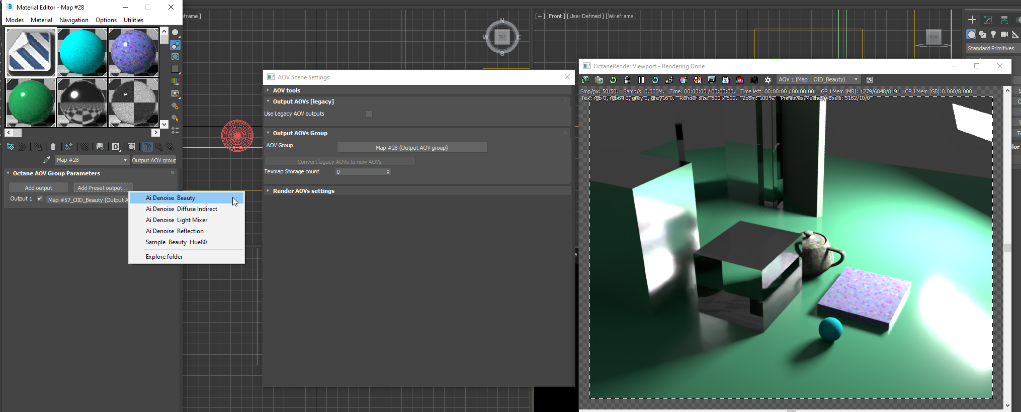

A new button has been added to the Output AOV group texture, to create some preset AOV outputs automatically.
There are currently only a few build-in presets, more can be added in the future.
User-created preset can be added. see bellow.
A first typical usage is to use the new OpenAI denoiser to denoise any render pass or AOV layer. (only available in 2024.1 Alpha3)
(and automatically set the denoiser Albedo and Normal, that improve the denoiser quality)
Reminder:
To create the main AOV group texture, open the AOV Scene settings dialog (from Render Setup / Kernel tab / Render settings : AOV Settings button)
Create an AOV Group texture, and drag and drop it to the material editor.
See more details about the AOV settings here: New AOV system - Step by Step tutorial (2023.1 Beta3) viewtopic.php?f=27&t=82109
In the Output AOV group dialog, press the "Add Preset output..." button, and select one of the options.
The currently available presets are as follow:
"Ai Denoise Beauty" (AiDenoise_Beauty.ms)
"Ai Denoise Reflection" (AiDenoise_Reflection.ms)
"Ai Denoise Diffuse Indirect" (AiDenoise_DiffuseIndirect.ms)
Those 3 presets are basically the same, only changing the Render AOV (pass) to be denoised.
This uses the Open AI denoiser AOV
"Ai Denoise Light Mixer" (AiDenoise_LightMixer.ms)
This uses the Open AI denoiser with the Light Mixer AOV layer (AOL)
Sample_Beauty_Hue80.ms
This the most simple sample to illustrate the use of 2 AOV layers.
(The AiDenoiser presets are only available in 2024.1 Alpha3)
After the new Aov output is created, you can select it in the Octane Viewport, or add it as a Render element for normal rendering.

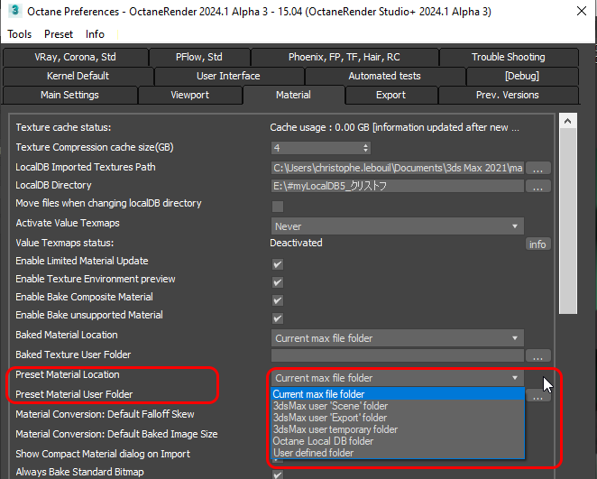

Customisation - Adding new preset using MaxScript
Those preset are simple Maxscript files, so it's easy to customize and create new ones to match your needs.
Before editing those files, make sure the location is convenient for you:
Open Octane Preferences, Material tab:
Check or set the Preset Material Location type and Preset Material User Folder.
When pressing the the "Add Preset output..." button, you can select the 'Explore folder' to view and edit the MaxScript files
