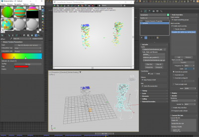

--- instances_age_gradient01.max
Basic simulation with particles, Octane geometry modifier set Particle UID to 'Age'.
Gradient Texture, using Instance range with Maximum ID set to 101 (number of frame, that will be the highest age of the oldest particle)
You can change the Octane geometry modifier Particle UID to 'Birth Unique ID', and set the Maximum ID to 200 (the number of particles at the last frame) to observe the result.

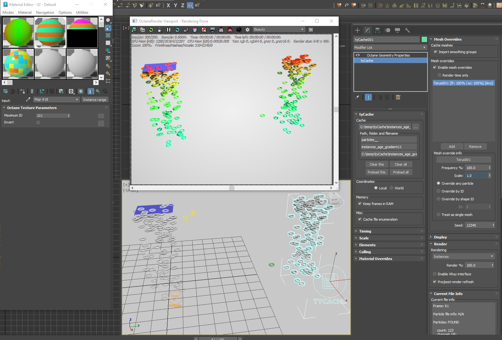

--- instances_age_gradient11_tyCache.max
Illustrates the usage of the TyCache.
An Export Particle operator has been added to the TyFlow Event_001.
For this sample, the Global Settings / Coordinates is set to Local, so we will be able to move the tyCache, to see both the original tyFlow object, and the resulting tyCache.
After opening this sample for the first time, select this Export operator, and press the 'Generate PRT files' button.
In tyCache / Render, the Rendering is set to Instances.
Note that the original tyFlow uses a build-in shape (torus).
For the tyCache, we need to set the geometry to a similar torus created in the scene (Torus001), with the Mesh overrides panel.
For real usage scenes, you would not move the tyCache object, and hide or delete the tyFlow object.

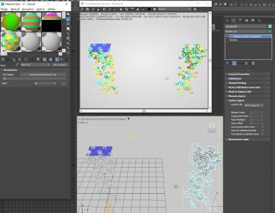

--- random_from_instance_tyCache.max ---
Same tyFlow / tyCache object, but with random color for each particle.
Using a Gradient Texture, and a Random color texture as Input.
The Particle UID of the Octane geometry modifier is not used, and can be set to None.
Note that multiple objects using the same material will result in different colors for each objects.
(the tyFlow and tyCache colors don't match)
--- random_from_instance_tyCache2.max ---
Same as previousely, but we use the Particle UID to create random colors.
The Particle UID of the Octane geometry modifier is set to Birth unique ID.
The Gradient texture uses an simple OSL texture (InstanceIDAsRandom01.osl) that reads the particle ID (instance ID), and uses a noise function to create a random grey value based of this ID.
This way, both the tyFLow and the tyCache object will have the same random colors.

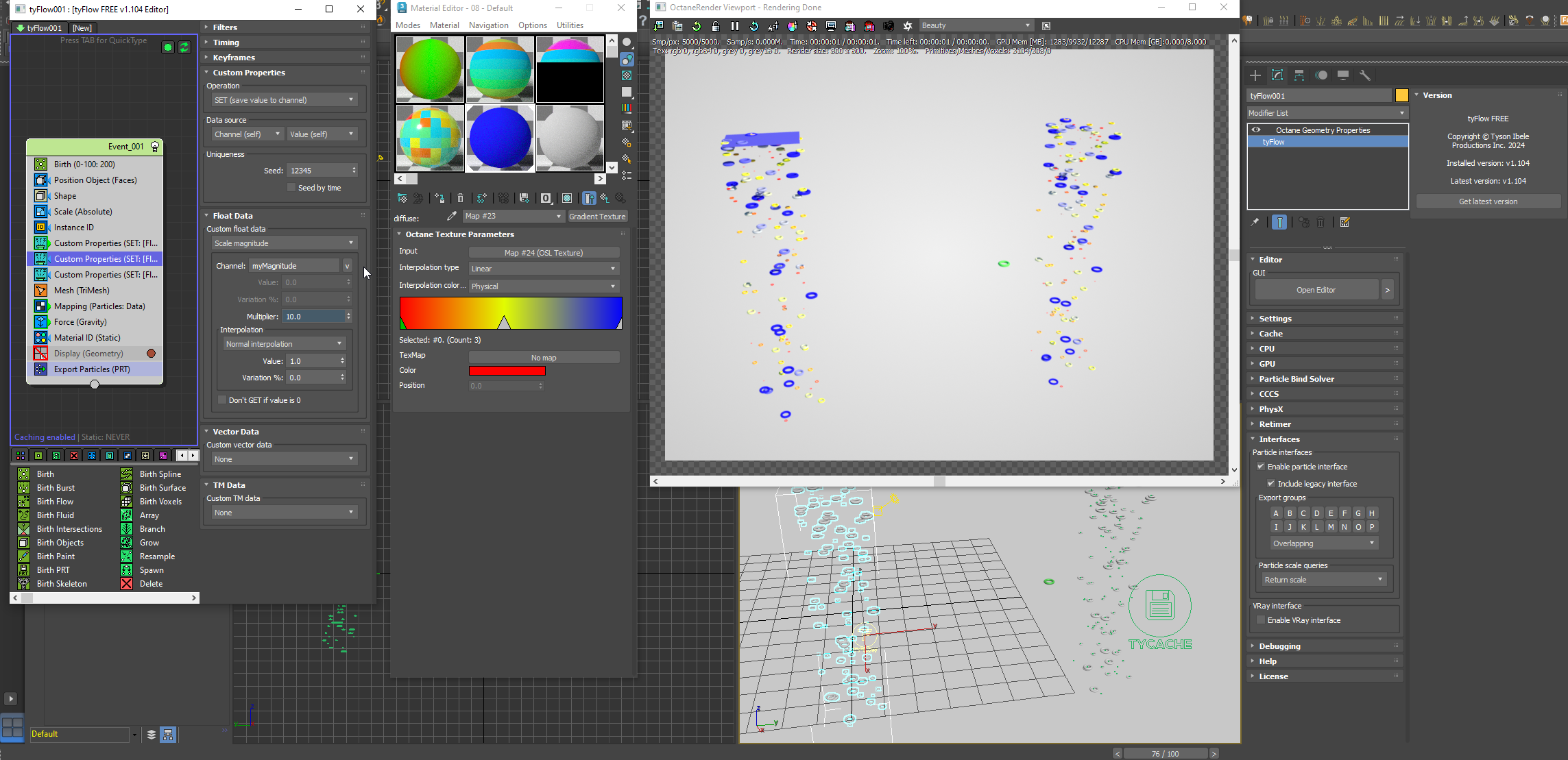

--- customFloat_randomScale_tyCache.max ---
In this sample, we read the random scale of the particle to set the particle color from a Gradient texture.
The Event_001 also has a Export Particle (PTR) operator. As for all those samples, use it to create the cache files, for the tyCache object.
In Event_001, an operator Custom Properties do a SET operation, and the Float Data is reading the 'Scale magnitude' with a multiplier of 10.0, and store it as 'myMagnitude' (a user defined property name)
The Scale (Absolute) operator is set to 500 %, with a random variation of 100 %
In Octane geometry modifier, Particle UID is set to Custom Float, and the Element Index is set to 1.
Note the custom property information line, "Custom float: myMagnitude" , that confirm that we selected the correct custom float.
The value Multiplier is set to 1.0, and the value offset to -25
Those have been determined by trial and error, based on the idea that the original data value (size / scale of the particle) should be between 0 to 50.0 (5.0 from the 500%, and x 10 from the multiplier).
(we can check the original scale in the tyCache object, with the Current File info / Open tyParticleViewer dialog, and that's in the range 0 to 5.0)
We will re-use our shader InstanceIDAsColor.osl, that basically scales the Instance ID to a value between 0.0 and 1.0 by dividing by the maximum value (parameter 'instanceCount').
So in our case, we will set instanceCount to 50.
The actual smallest particle scale is not 0, to we can adjust Value offset to have a better fit from the smallest / biggest particle to the gradient colors (red for smallest to blue for biggest)
