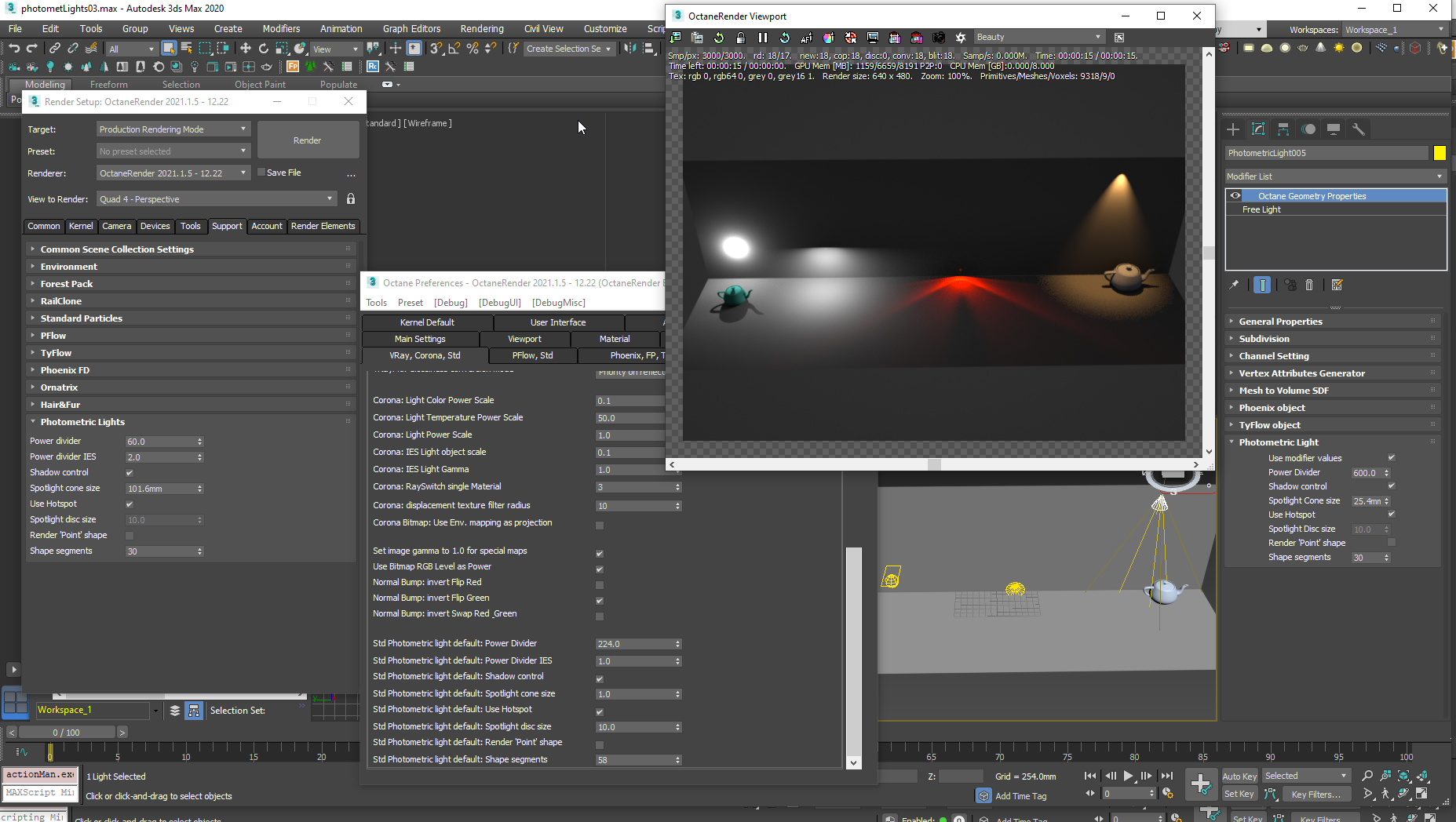

--- Octane settings ---
Some additional parameters are available to control the internal Octane settings of the lights :
-In Render settings, tab Support, rollout 'Photometric lights':
Those settings affect all lights of the scene, unless an Octane Geometry modifier is applied a light object.
Power Divider : Divider for converting 'Intensity' to Octane 'Power'
Power Divider IES : Divider for converting 'Intensity' to Octane 'Power', for IES lights (Photometric Web)
Spotlight cone size : Size of the cone used to create a spotlight.
Use Hotspot : For Spotlight : use the Hotspot angle to place the internal emitting disc inside the cone.
Spotlight disc size : For Spotlight, when 'Use Hotspot' is disabled: Relative size (percent) of the emitting disc inside the cone.
Render 'Point' shape : For 'Point' shape, set the octane shape visible to camera.
Shape segments : Segment count for the light shape (disc, sphere, ...)
Note: The default values (eg when switching the renderer to Octane) can be set in Octane Preferences, tab 'Vray, Corona, Std'
-In Octane geometry modifier.
The panel 'Photometric Light' has the same settings.
When 'Use modifier values', the parameters will be applied individually for each light.

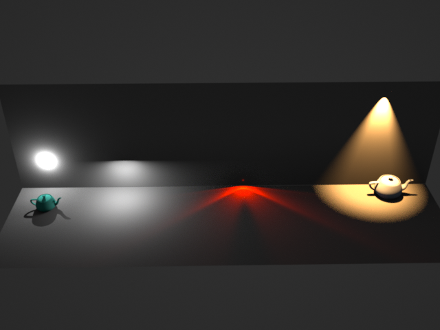

-Scene with 4 different types of photometric lights, scanline renderer.
photometLights01.max

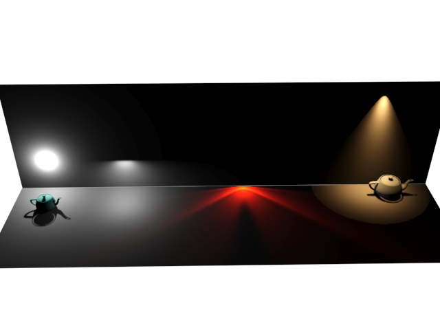

-Same scene, using octane renderer, after global adjustments in Render settings.
photometLights02.max

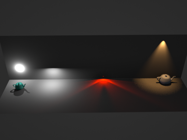

-Added an Octane geometry modifier for individual adjustment of the spotlight power.
photometLights03.max
