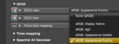

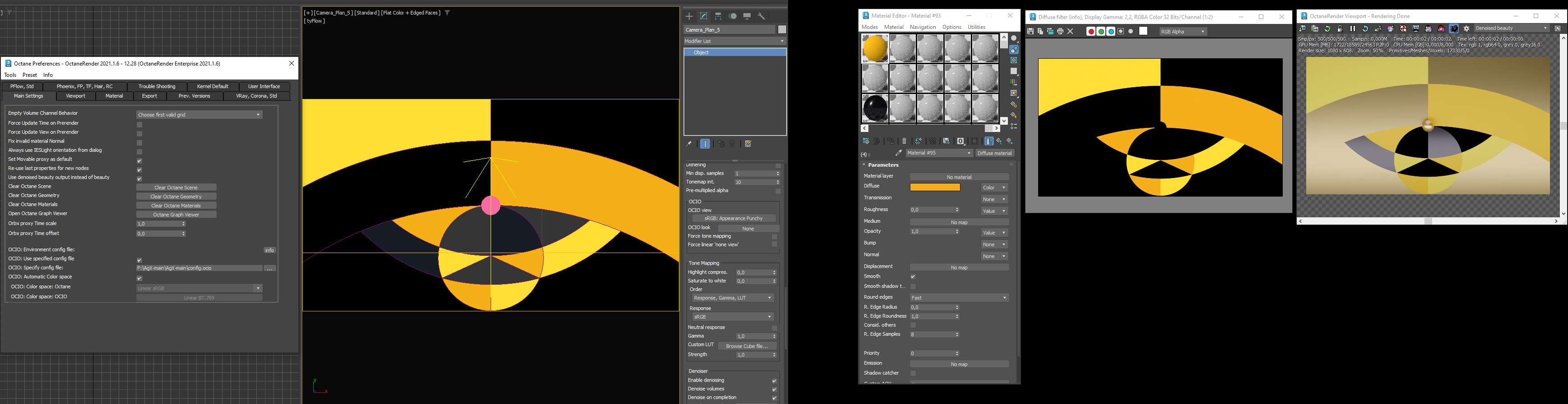

Hello,
I'm having trouble to understand why I have a washed out result in the beauty pass of my Octane Viewport, whenever I'm using the ACES or AGx method, please see attached screenshot.
Are we forced to adjust levels of .EXR 16bits files in post production or is there a way to get the "nice looking image" straight from the Octane viewport and save it as .jpg for previews.
Color management is obviously a new world for me
Thank you in advance

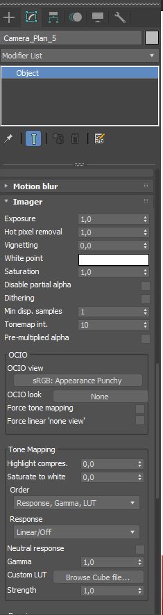

Hello elsksa,
Thank you for your answer and for all the time you take, I'll stick with AgX !
This is actually the camera Imager that you can see in my screenshot... In 3ds Max you have a "general" Imager that works with all the different views (top, right, perspective, ortho...Etc and every camera created has its own Imager that doesn't depend of the general one

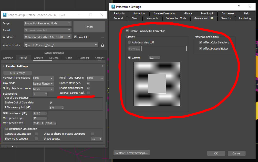

The specificity of the Octane plugin is that there is an option for a "3ds max Hack", please see attachement.
If I turn off "Enable Gamma/LUT Correction", every color in the viewport and in the material editor become wrong

Well, nothing wrong happens when I export image to the frame buffer or to Photoshop/After Effects... it's the same as the Octane's viewport one (that's a start !)
My only concern is actually to avoid post processing and I would like to have "correct colors" showing up in the viewport :
As you can see in my first screenshot, all the colors are washed out in comparaison to the Max Viewport / Material editor / Diffuse Info pass etc...
I'm sorry if that's unclear, my english is not my mother tongue
