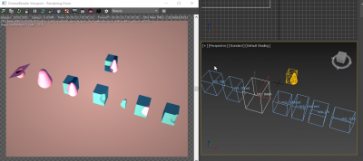

The Vectron primitives and operators can be created from the 'Octane Vectron' panel of the 3dsMax Geometry tab.
They should be straightforward to create and edit, with a simplified wireframe mesh visible in the 3dsMax viewport.

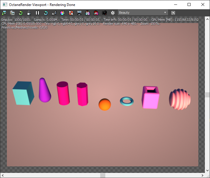

The primitives currently available are: Box, Capsule, Cylinder, Prism, Sphere, Torus, Tube.
vctrSample1_Primitives.max

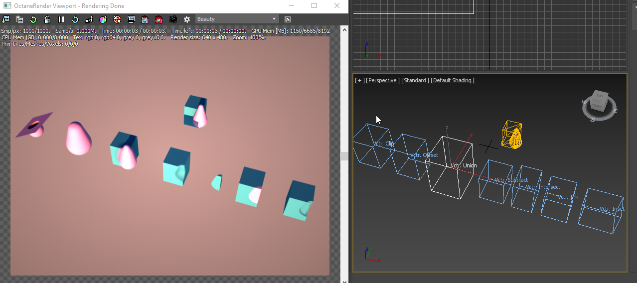

The operators currently available are:
Clip, Ink, Inset, Intersect, Offset, Substract, Union

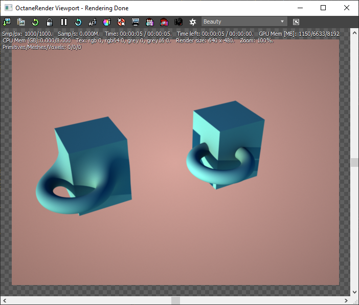

The Domain operator uses SDF object (like Volume SDF vdb), and is not fully functional in this version.
vctrSample2_Union.max
vctrSample3_Operators.max

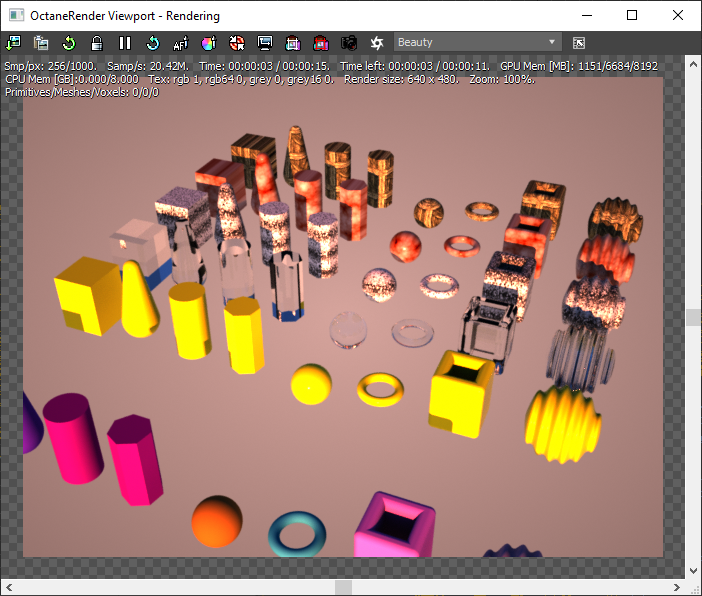

Materials can be applied to Vectron primitives.
Note that there are no UV available; instead, a XYZ to UVW projection can be used.
vctrSample4_Materials.max

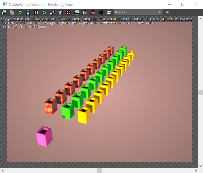

Instances of Vectron primitives can be used, but all instances will use the same material.
To apply different materials to instances, you can use References for each material instead of Instances.
You can then create instances of those references, that will share the same material.
vctrSample5_Instances.max
