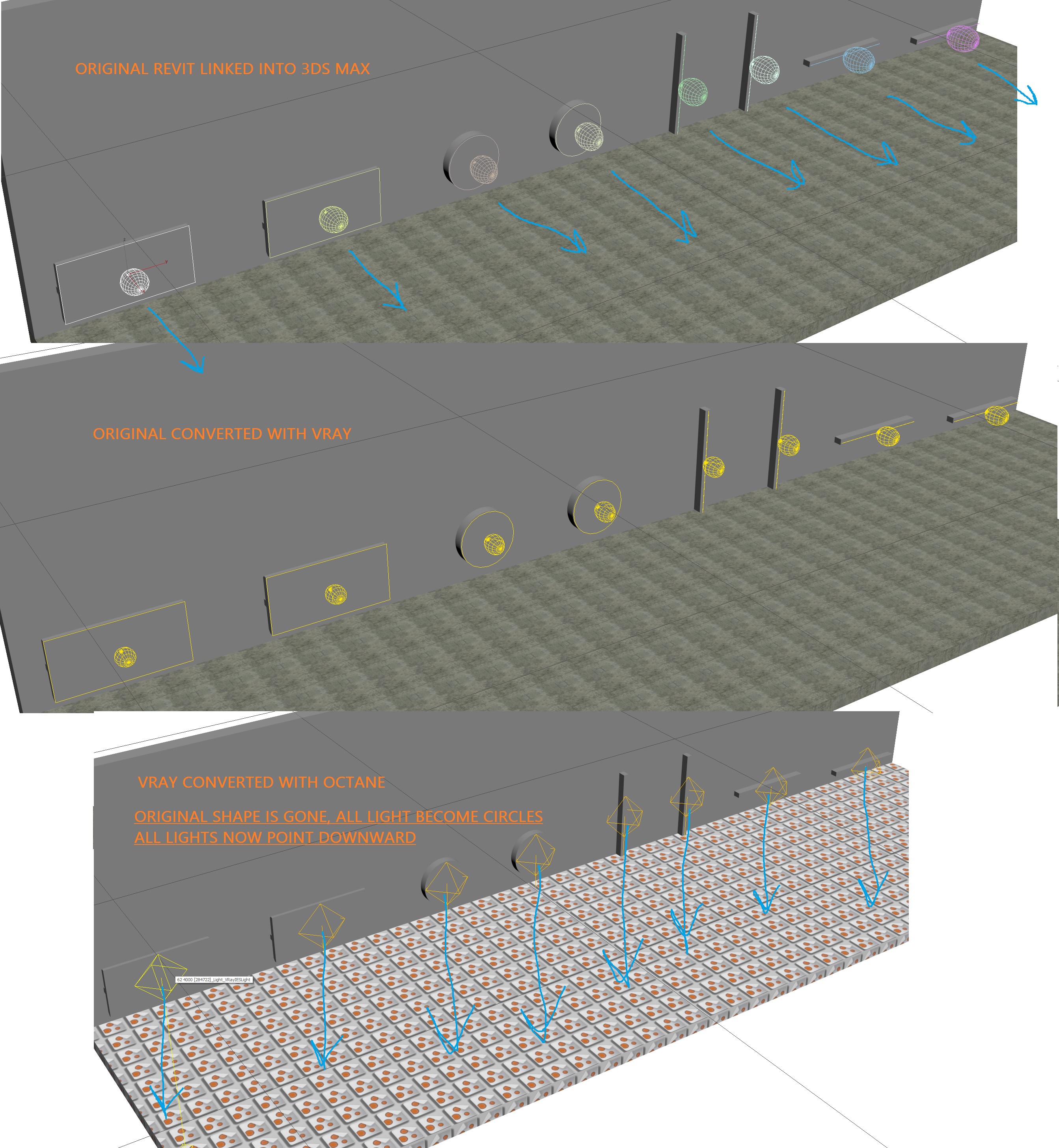

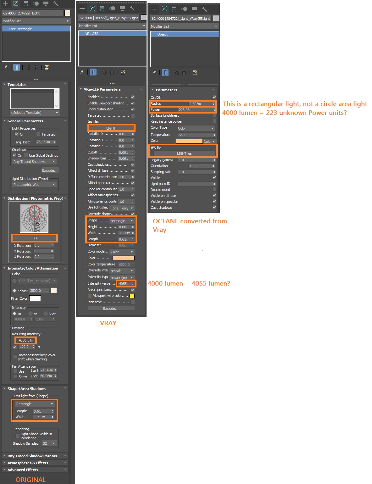

Here's some illustrations of more tests with light conversion:
There's a few issues shown:
-The lumen value gets converted to some non-lumen "power" value. It would make more sense to keep lumen as lumen, because this is what the lighting industry uses to talk about light intensity.
-The shape is lost and converted to a point/circle light instead. It's unclear if changing the size of the circle changes the resulting intensity.
-All lights pointing on the side or above now point downwards!
Also, there's no way to check the accuracy of the light intensity. From a professional perspective, it seems very wrong. It seems like the resulting light intensity in Octane is way too bright, to the point of making the sun look dim. The fact that Octane does not use lumen, but power is just more reason to not trust the lighting power data.
I hope the team can work on improving the accuracy of light conversion, this is very crucial for architectural and lighting visualization. Also if this kind of errors are fixed, we could build a really good pipeline to go from Revit to Octane on a massive scale.

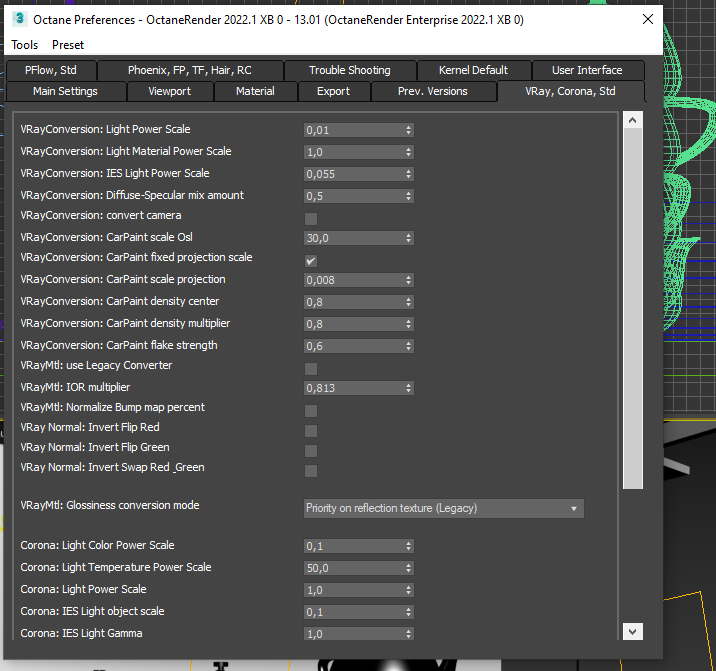

Hi SamuelAB,
viewtopic.php?f=27&t=64872&p=329709#p329666
viewtopic.php?f=27&t=64872&p=383392&hil ... en#p383392
You can set the Light conversion values in Octane preference.
Regards
Paride
