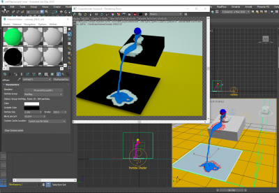

The new texture "PhtParticleTex" allow mapping of 2 colors depending on the distance to particles of a Phoenix simulator.
This can be used to create a 'wet' effect, where the liquid has touched a surface.

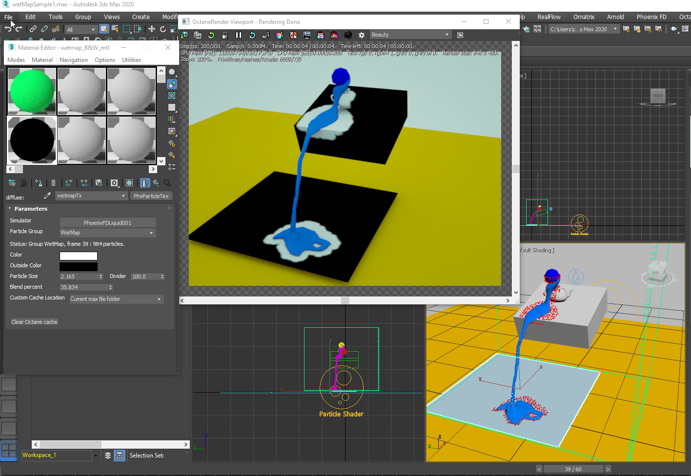

To visualize and setup the particle distance and blend ratio, you can first use it as the diffuse color of a diffuse material:

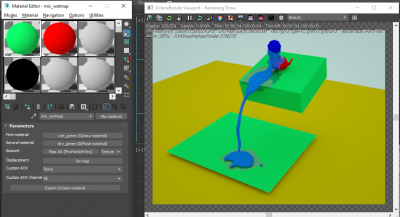

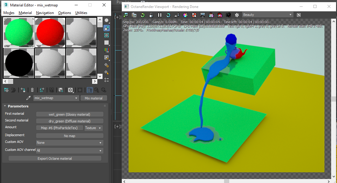

Then, you can use it as the Amount of a mix material, to blend a wet and a dry material:
The usage should be straight forward:
After a Phoenix simulation is complete, move the timeline to a frame where the particles are visible.
-Select a Phoenix simulator node
-Select one of the particle group available (eg : Wetmap)
-Open Octane viewport.
-Adjust the particle size and blend percent to archive the desired effect.

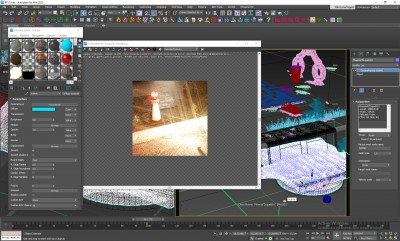

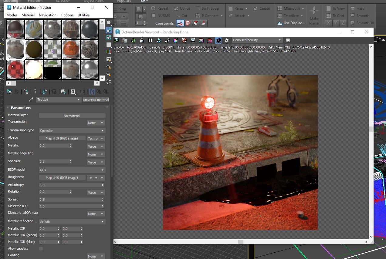

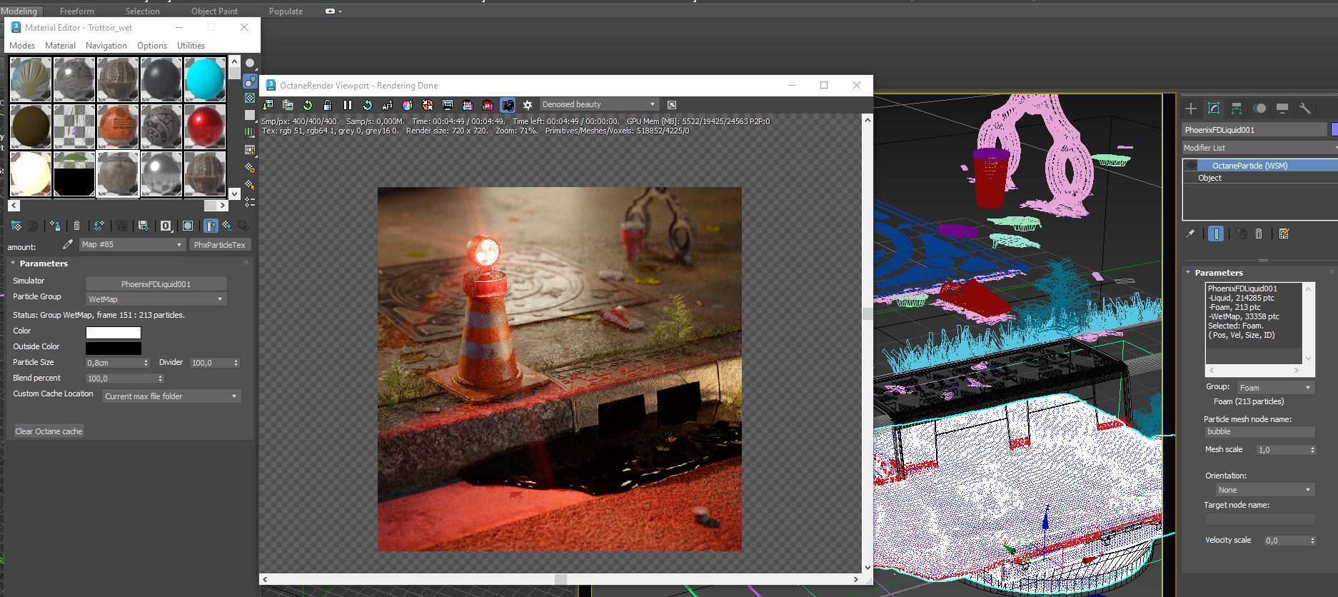

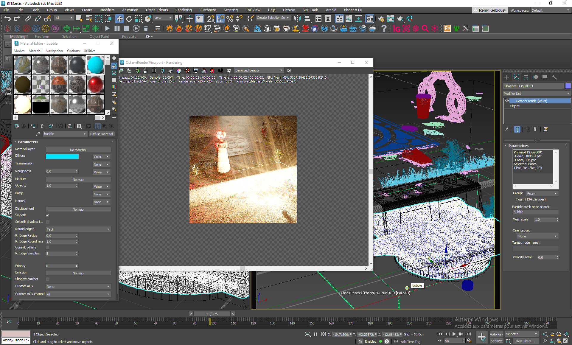

- When I launch a phoenix sim with a mix material (with the PhxParticleTex) applied to the geometry, 3ds Max crashes, I need to stay with a simple material (without PhxParticleTex)to get the simulation working.
- Render is extremely slow (from 5 seconds to 5 min/frame) and a light is appearing on the right ("Capture_Phx_mixmat.jpg") as soon as I use the mix material with the PhxParticleTex
- I have a bug when I'm using "OctaneParticle/group : Foam" too, whatever the material I'm using for the mesh reference, it renders a very emissive/bright material instead (please see attachement file)
Thank you in advance

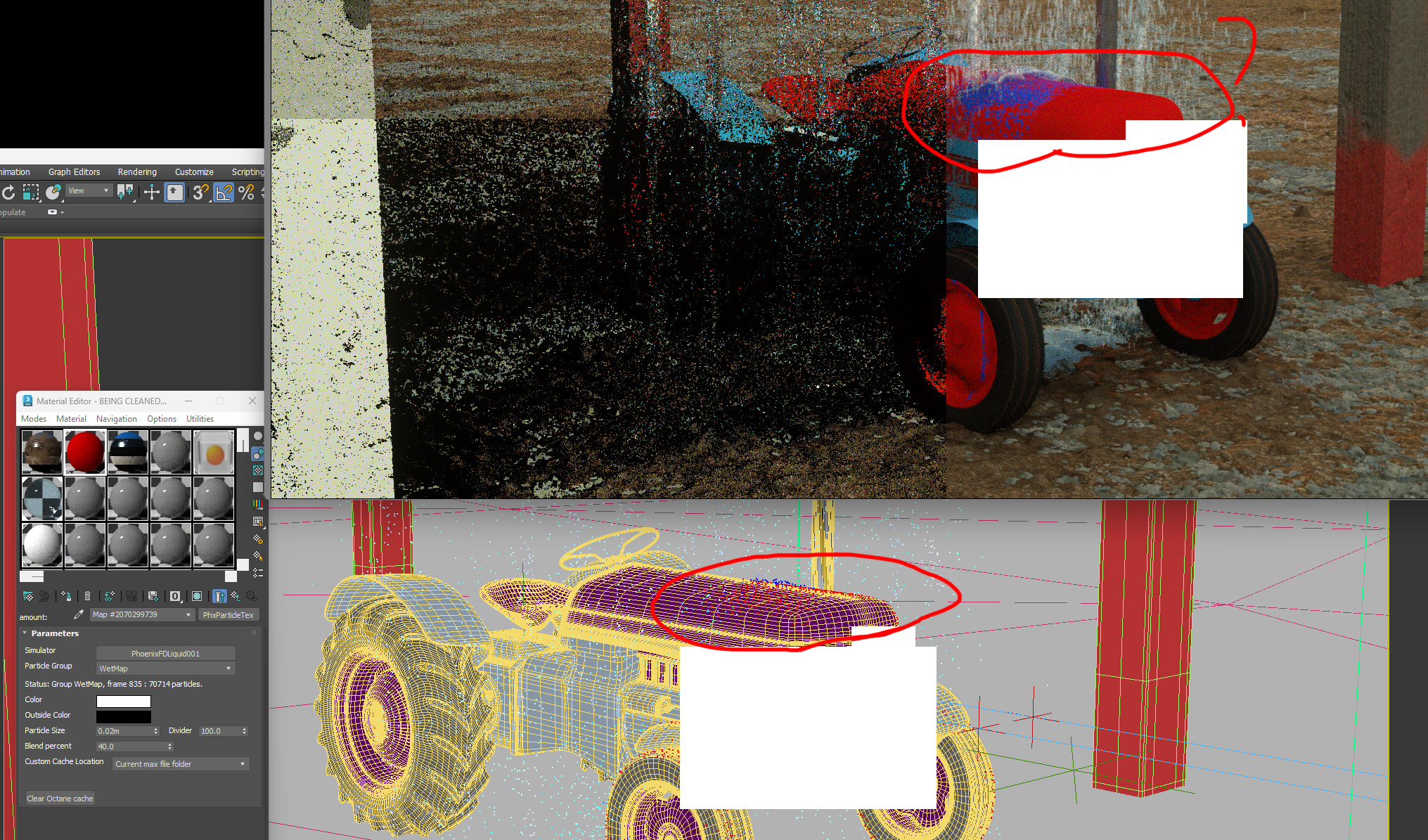

Thank you for the update! I noticed when liquid resolution is increased wetness disappears unless you change particle group from wetmap to liquid. Not sure why
And if a grid is high resolution using this wetmap is impossible. Too slow
Also on top front of the tractor is covered with wetmap particles but your particles texture is not covering the front top with blue color.

remKa wrote:Hello neonZorglub,
a few feedbacks from using PhxParticleTex :
