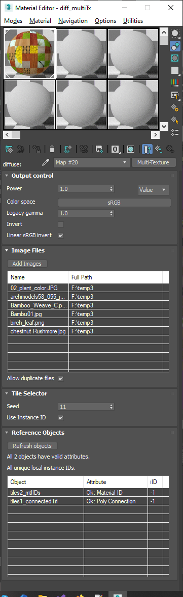

1) Add images to the image list.
Use the Add images button, and select 1 or several image files
2) Apply the material to some objects
3) Use the 'Refresh objects' button in the Reference Objects rollout.
This will check the geometry settings and provide a 'Fix issues' button to configure the Octane Geometry modifier correctly automatically.
You can choose one of the 2 ways to differenciate faces for the random texture assignment:
-Using the Material IDs.
-Using the Polygon connections.
This creates internal IDs for each group of connected polygons.
* Seed: Base for random numbers generation.
* Use instance ID
This allows to have different random textures on several object's instances.
If disabled, all instances will have the same randomness.
-Removing images from the list:
Select one of several images, and use the context menu (right click) and choose 'Remove image(s)'
In this menu, the 'Explore image folder' opens Windows Explorer at the folder location.
The Multi-Texture is a wrapper using Octane Image Tile, so there are the same output settings available (power, color space, etc..)
The object list provide a context menu for selected objects, and allow to change the geometry assignment type (Material ID / Polygon connection)

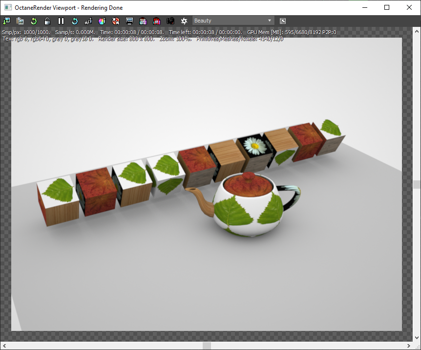

Multi-Texture_sample1_MtlID.max
using the default Box (witch has 6 different material IDs), each side use a different random texture.
Note that the teapot has both different material IDs, and separate parts. So you can use both methods to differenciate faces.

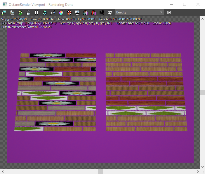

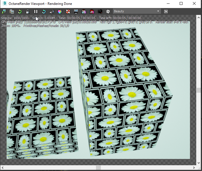

For Bercon tile support, I suppose you are talking about this ? https://github.com/Bercon/BerconMaps
For use of the Bercon tile alone, the option to Bake it works well with octane, as in the sample berconTile02_oct.max:
BerconTileSamples.zip
(841.8 KiB) Downloaded 309 times
(Render settings: tools tab, Material converter: Enable bake other unsupported: On)

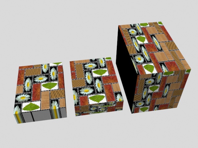

But I suppose you want to use Bercon tile with MultiTexture from CG Source ?
like the sample berconTile03_multiTile_Scanline.max:
Rendered with Scanline Renderer:
This currently can not be baked (I think because of the use of 2 uv channels).
Could you confirm that it's what you want to use , or send me a sample that works with Scanline Renderer, and not with Octane ?
I can check if it can be possible to use octane Multi-Texture for this, or to make the baking work..

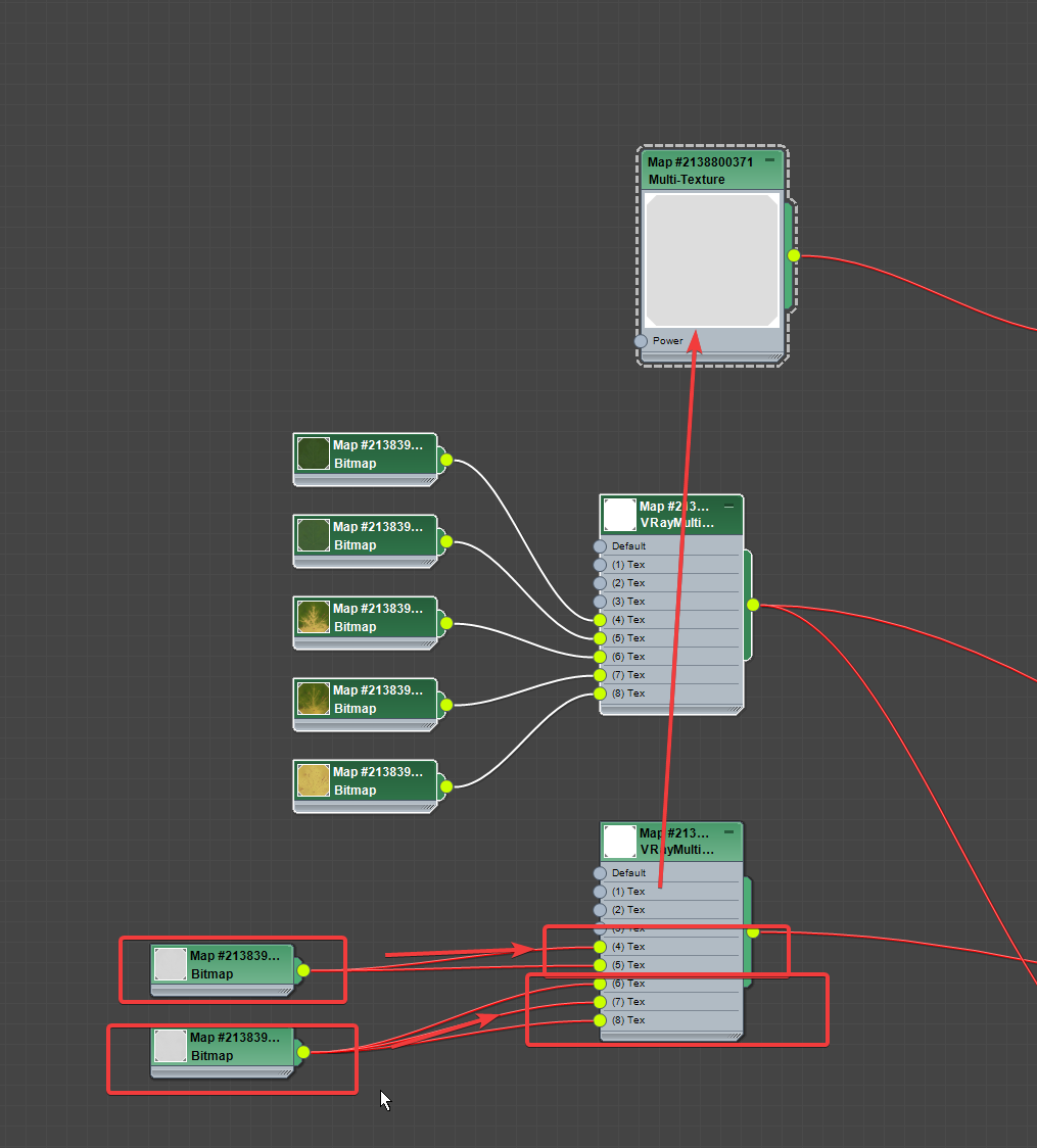

Thanks v much - great reply, much appreciated.
'But I suppose you want to use Bercon tile with MultiTexture from CG Source ?'
Yup, exactly that.
Here's a vid on youtube which is exactly what's needed, working with Vray.... ;)
https://youtu.be/phhlBboBWxI
If you can get this working in octane that would be perfect.
Cheers
