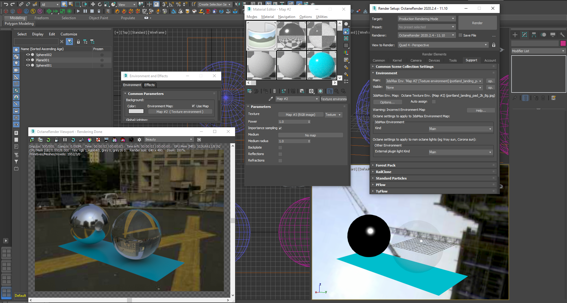

-Added a new panel 'Environment' in Render settings / 'Support' tab.
-Added Octane environment parameters when using standard bitmap.
The simplest work flow to use environment map is to assign a standard bitmap (hdr, jpg,..,with spherical mapping) in the 3dsMax environment map.
It will be rendered by Octane as in the 3dsMax viewport.
When using an Octane daylight instead or additionally, the environment type can be set as Texture or Daylight,
and the texture can be an Octane RGB image or a Standard bitmap.
The new 'Environment' panel should help to see and select the 2 kinds of environments available in Octane, and assign one of them to the 3dsmax viewport.
Reminder: Octane has 2 kinds of environments : a Main and a Visible.
The Main environment defines the background image and the global lightning, with an optional Medium texture, and the Visible environment can be set as source of reflection, refraction, replace the background image (backplate), etc..
New Environment panel settings:
The Main and Visible combo boxes allow to enable one of the available environments.
The corresponding 'op.' buttons show a menu for the selected environment, to help assign, select, or convert it.
The "3dsMax Env. Map." status shows information about the map currently assigned to 3dsMax environment / viewport.
The "Options..." button shows options related to the 3dsMax environment / viewport, help to have the same background as Octane.
Auto assign can be enabled to ensure that the 3dsmax viewport always display the same background as Octane.
An additional information ("Warning..") may be displayed if an invalid setting is detected, and a Help button will propose to fix the issue.
The group box "3dsmax environment" show the settings to use for the corresponding Octane environment.
Those settings are part of an Octane daylight, so there are only displayed when using a standard Bitmap.
The group box "Other environment" provides the same settings, when a Vray or Corona sunlight is present and enabled.

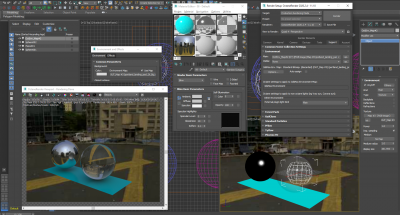

Here are some samples to illustrate the new features:
OctaneEnvironmentSamples.zip
(1.75 MiB) Downloaded 296 times
------------- 01

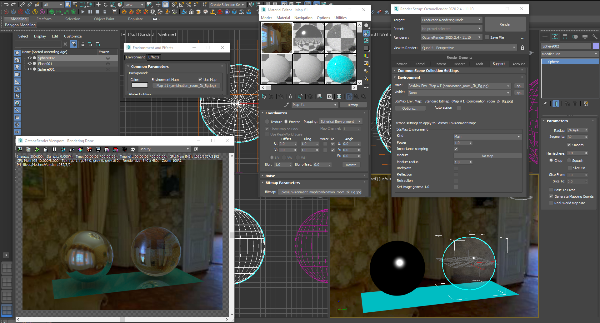

octane_envir01_stdBitmap.max
-a standard Bitmap is assigned to the 3dsmax Environment map.
-a 3dsmax viewport is set to display the 3dsmax Environment background
-the environment settings are available (power, medium, ..) and will affect the Octane render.
-changing the Bitmap orientation (Coordinates, Offset U) will update the octane environment.
----------- 02

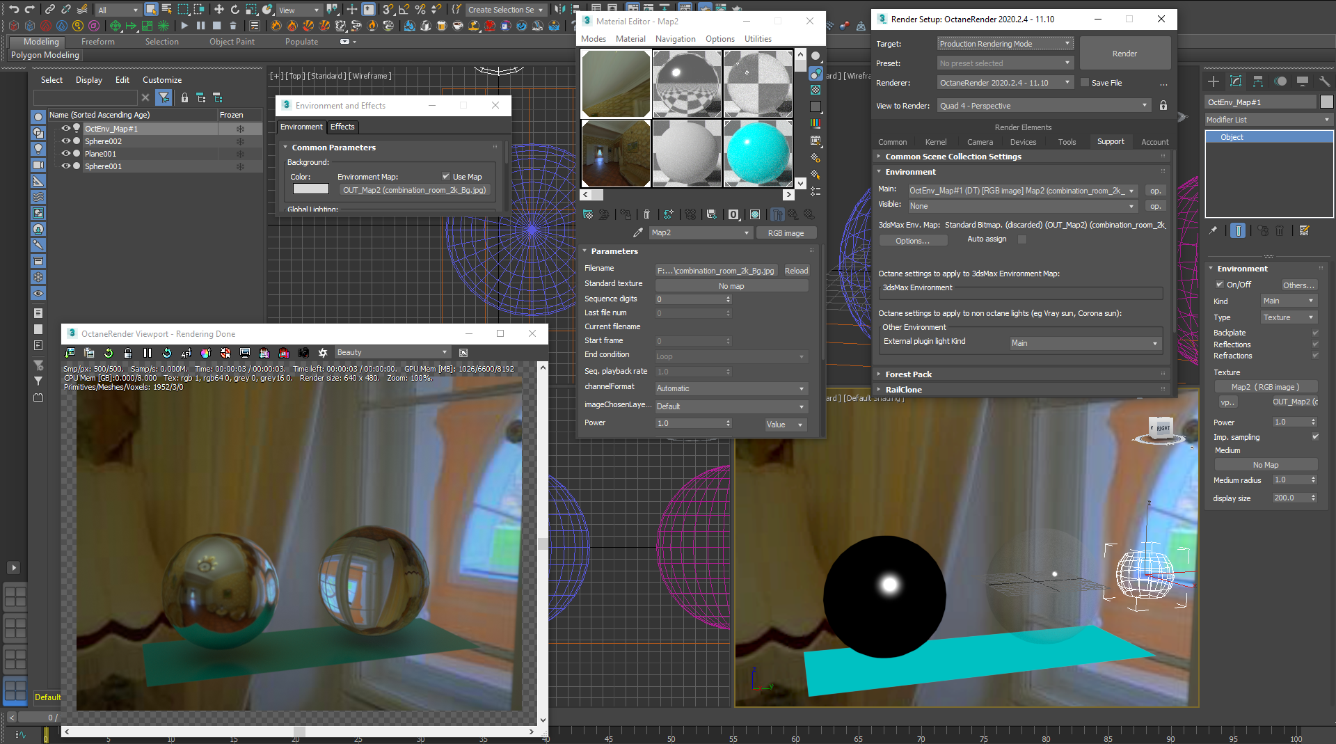

octane_envir02_RGBImage_to_Bitmap.max
-an Octane RGB image is used in a Daylight. (Map #2)
-it is automatically converted to a standard Bitmap (OUT_map#2), assigned to the 3dsMax Environment
-changing the RGB image orientation (UV transform, translation X) will automatically update the 3dsmax viewport.
----------- 03

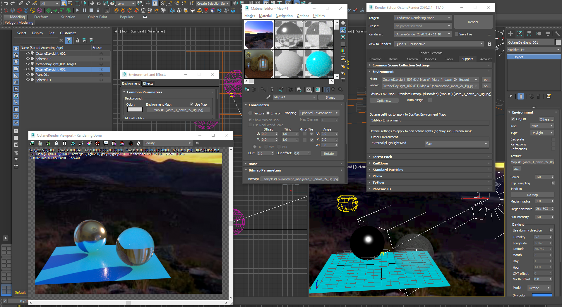

octane_envir03_SecondMap+Sunlight.max
-an Octane daylight is used as the Main environment with a texture and sun parameters
-a second Octane daylight, with kind set as Visible, is used for reflections and refractions
----------- 04

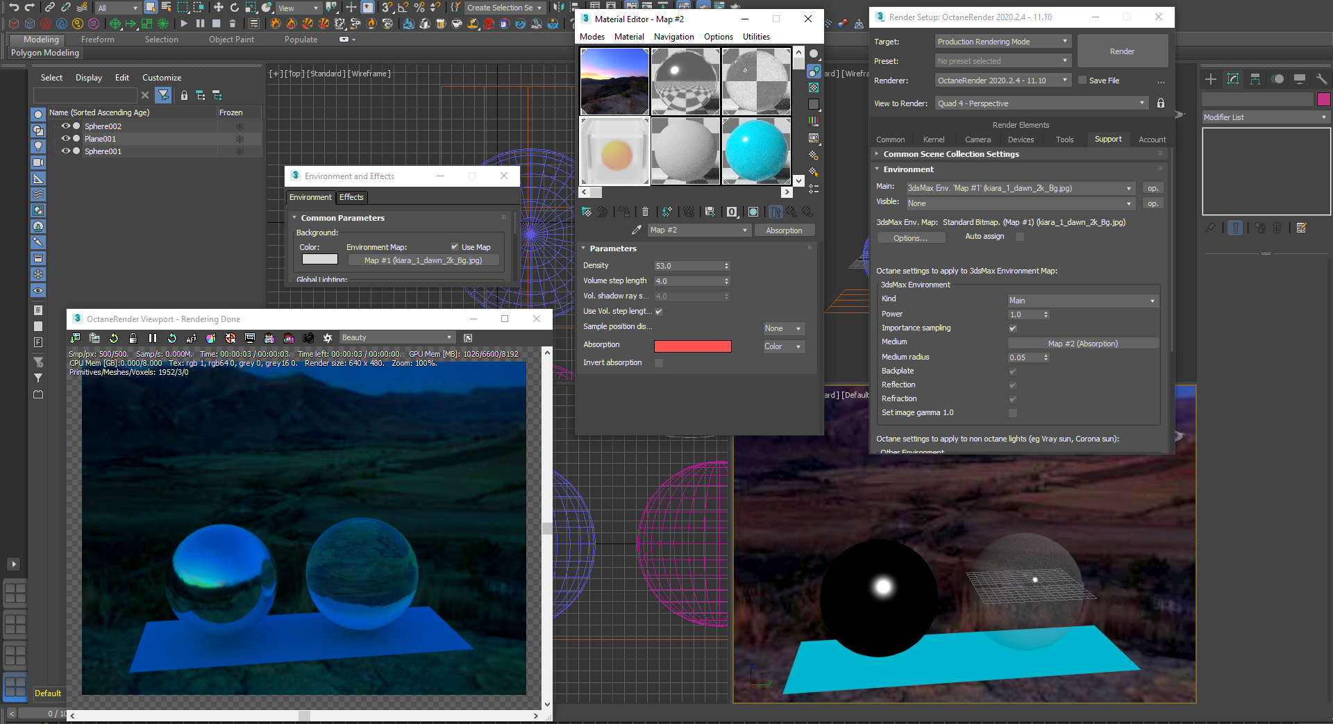

octane_envir04_stdBitmapWithMedium.max
-a Medium map is assigned in the Environment panel, and rendered by Octane.
----------- 05

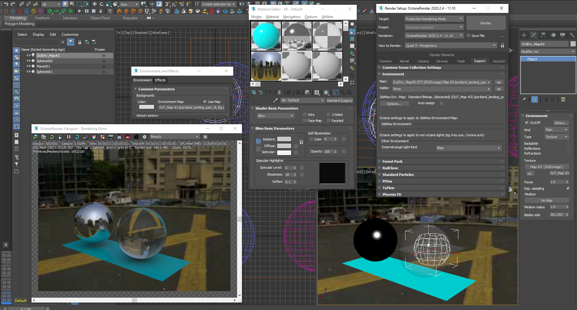

octane_envir05_OctEnvTx_wrongDisplay.max
This illustrate the issue of using a Texture environment or a RGB image directly in the 3dsmax Environment map slot.
It renders correctly in Octane, but the 3dsmax viewport is incorrect.
----------- 06
octane_envir06_OctEnvTx_fix.max
Using octane_envir05_OctEnvTx_wrongDisplay, we just need to use the 'Options...' button, and select
"Create Octane daylight from 3dsMax Environment"
Both Octane and the 3dsmax viewport match.
