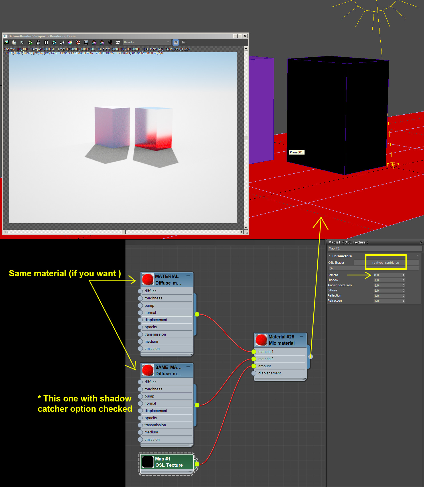

From a long time now I don't use shadow catcher as the shadow catcher option turn material into a white material.
Perhaps it could be done otherwise, but like this it works. :mrgreen: :mrgreen: :mrgreen: :mrgreen:

Hey! This is awesome. Raytype_contrib.osl - this is your custom shader? Could you share it :) ?
HHbomb
Posts: 1437
Hi, osl shader can be found here : viewtopic.php?f=21&t=71597
