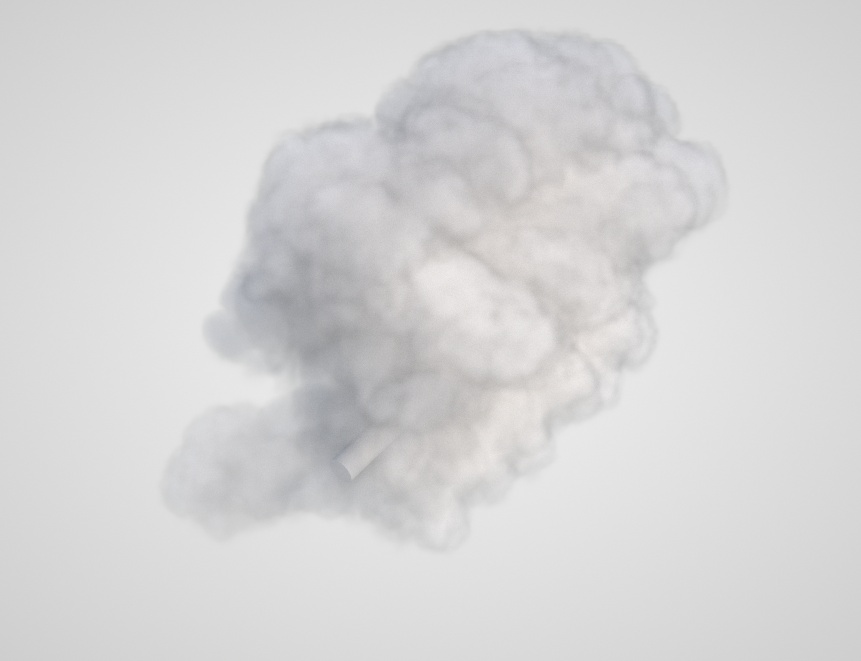

Ok so I got something with 4. basic smoke.. control how dark with density.. might help for other stuff - max people, help out with the rest?

acc24ex wrote:Ok so I got something with 4. basic smoke.. control how dark with density.. might help for other stuff - max people, help out with the rest?
https://docs.otoy.com/3DSMaxH/3DSMaxPlu ... ght=medium

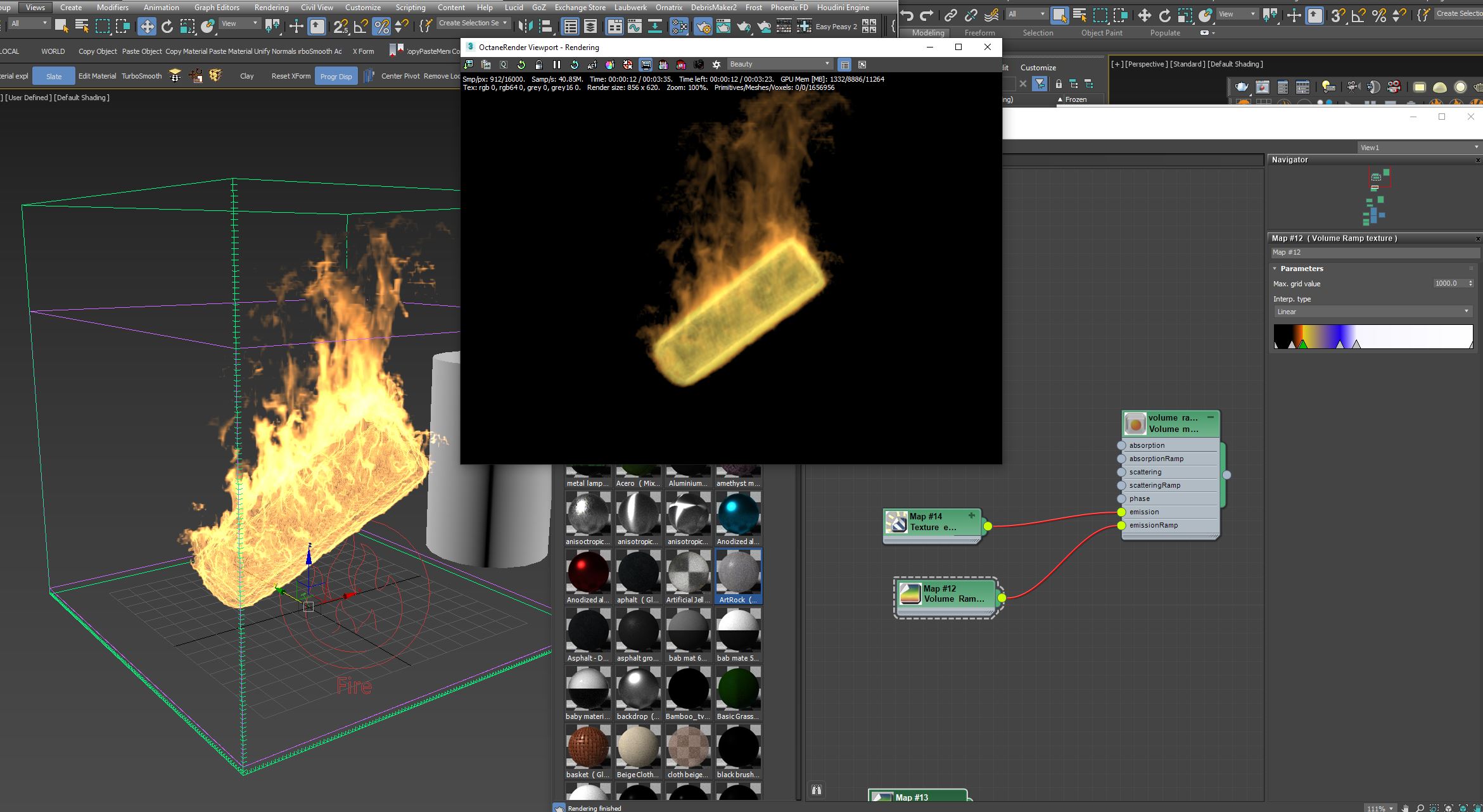

you know what, I cannot get anything with the fire, what settings do we use for Octane volume.. I got the smoke but fire.. nopeparide4331 wrote:acc24ex wrote:Ok so I got something with 4. basic smoke.. control how dark with density.. might help for other stuff - max people, help out with the rest?
..also the material still doesn't update in octane viewport until you change the frame, making it a bit more difficult to setup

Hi acc24ex,acc24ex wrote:you know what, I cannot get anything with the fire, what settings do we use for Octane volume.. I got the smoke but fire.. nopeparide4331 wrote:acc24ex wrote:Ok so I got something with 4. basic smoke.. control how dark with density.. might help for other stuff - max people, help out with the rest?
I will make some sample scene In the next few days.
Regards
Paride
thanks, I got this so far, missing those fine details, but also no smoke..
.. shouldn't be this difficult, took me a few tries to find settings and get it as close as possible.. I mean, OK for a challenge and learning, but you don't always have the time to do that
