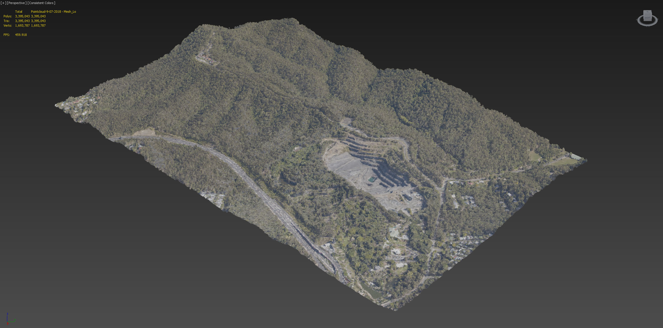

This would be extremely useful for us too. I often have very high polygon meshes generated from point clouds which are very time consuming to UVUnwrap/Bake. Being able to render the vertex colour on the mesh would be great but so far I have not been able to uncover a way to achieve this.
