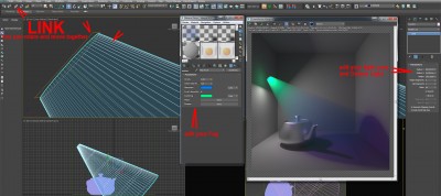

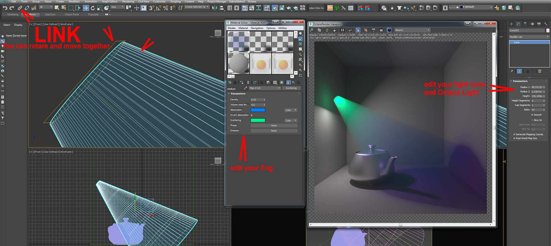

paride4331
Posts: 4002
Hi guys,
Perhaps this solution can be of help.
Attached a .max file
Regards
Paride
2c.rar
(1.79 MiB) Downloaded 410 times

paride4331 wrote:Hi guys,
Regards
Paride
thank you! Hopefully otoy will create similar stuff for lights
