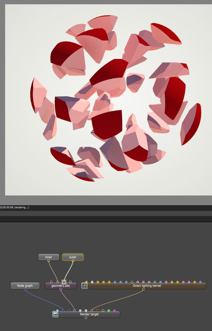

paride4331
Posts: 3994
Hi amoh,
I do not think there is only one way to get the same result. however, this is what I think you want.
Regards
Paride
amoh
Posts: 19
Joined: Sun Apr 03, 2011 8:20 am
paride4331 wrote:Hi amoh,
Regards
Paride
Wow! :)
Thanks a lot! That's exactly what can help me with my problem. I did not expect that node to work with Octane plug-in. Tnaks again!
