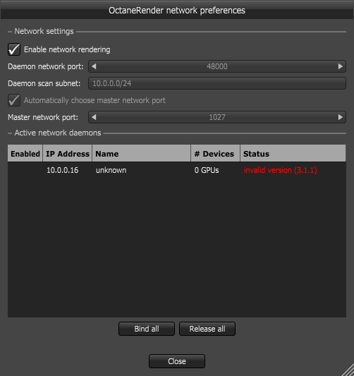

NETWORK Rendering in 3dsmax 2017
Ok, so I am running two full licenses of Octane, and with Max 2017. My version is 3.01.1 and the 3dsmax max beta plugin, 3.0.2 - 3.17
QUESTION... Why can I only network render in the stand alone version... when in 3dsmax, even though I go to NETWORK RENDERING and enable it, the other machine comes up "Invalid Version (3.1.1)"
SEE ATTACHED

Ok I just realized something OBVIOUS to my problem. Why is the standalone download version only 3.01.1, and yet the 3dsmax plugin is calling for 3.02 !!!
That would totally explain the error (invalid version 3.1.1) I need to have the two match !! Either download 3.02 stand alone which is not available for download in my download section, or I need to run a plugin that is 3.01 based !
Please advise.
richardyarlett
Posts: 197
Joined: Thu Apr 09, 2015 8:48 pm
Ok I have found the 3.02 standalone.... I guess you guys have updated it and not updated the downloads section officially.
azen
Posts: 809
Joined: Mon Jun 01, 2015 11:06 pm
I will look to get the download section updated on the site. Mixing versions hasn't been a use case that I have tested yet. Please confirm whether the issue was resolved.
richardyarlett
Posts: 197
YES RESOLVED !! Great to know. I was using a 3dsmax plugin, MORE advanced than the base stand alone version. That was the problem. I didn't catch that there was a 3.02 standalone.
