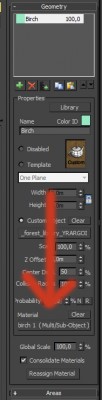

2) assign the material to the Forest pack object (material apply image )

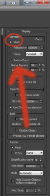

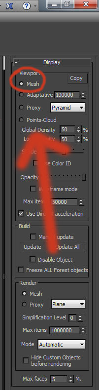

3) check the box "mesh" into the "display" section of Forest Pack (display image)

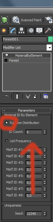

4) add a "material by element" modifier to the Forest Pack scatter, check "random distribution" and set the number of material you have created in the "Mutly sub Object" material (material by element image)
