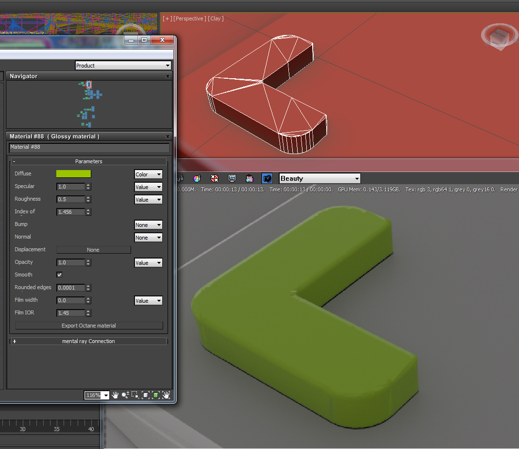

Just purchased Octane for Max 2015 and have found that any geometry I use round edges on, I get artifacts.
I am working in mm and scale is set accordingly, I am using the latest release.
Is it still an issue/bug to be resolved or is there something I am missing on my end, want to check before reporting it.
Rounded Edge Artifact

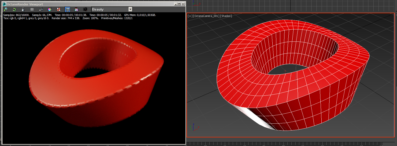

I assume you mean the problem is with the mesh topology, well there is the problem.
I deal with NURBS translated data, so clean quad and poly topo is not an option (I tried increasing mesh density but the problem still occurs).
So can someone clarify that Octane's round edge only works on clean, uniform topology.
I am aware that on other render engines this is not a limitation, so would it be possible to address this in Octane?
Thanks for your time.
gueoct
Posts: 402
Joined: Mon Jul 11, 2011 3:10 pm

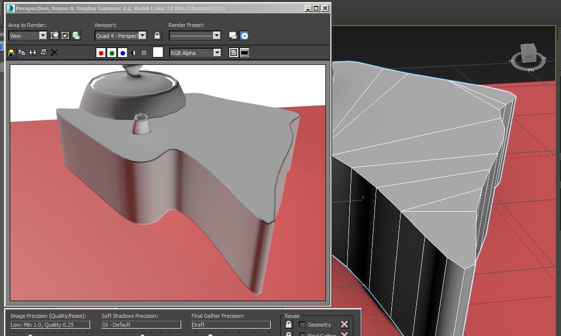

What other render engines support edge rounding?

gueoct wrote:What other render engines support edge rounding?
Mental ray ---- Corona render (CPU - render)\
possible Redshift render
but we should not compare them with octane render you will be bored to work in them
gueoct
Posts: 402
The MentalRay rounded edge looks lousy, too! :-)))
Though the radius is much smaller than in the Octane example...
Intel i7-970 @3,20 GHz / 24 GB RAM / 3 x EVGA GTX 580 - 3GB
Gestaltdesign
Posts: 60
Joined: Sat May 23, 2015 7:14 am
Vray too of course.
gueoct
Posts: 402
Gestaltdesign wrote:Vray too of course.
Wow, didn´t know that VRay can do that! Just tried it out, works fine!
On the other hand, Octane Edge Rounding does not....
it only does on very simple shapes with straight edges.
it´s not a topology issue. i tried a very simple and clean object...
Gestaltdesign
Posts: 60
Oh right, that's interesting, so it is a broken feature then or one in development, surprised a mod has not commented about it.
It works perfectly in Corona too. I will go out on a limb and guess it is a lot harder to implement in a GPU renderer, no idea, hope it works soon!
mbetke
Posts: 1300
Location: Germany
Its broken since ages.... :-/
I keep chamfering my models where I need to with a slight value and use a lot of boxmapping anyway.
