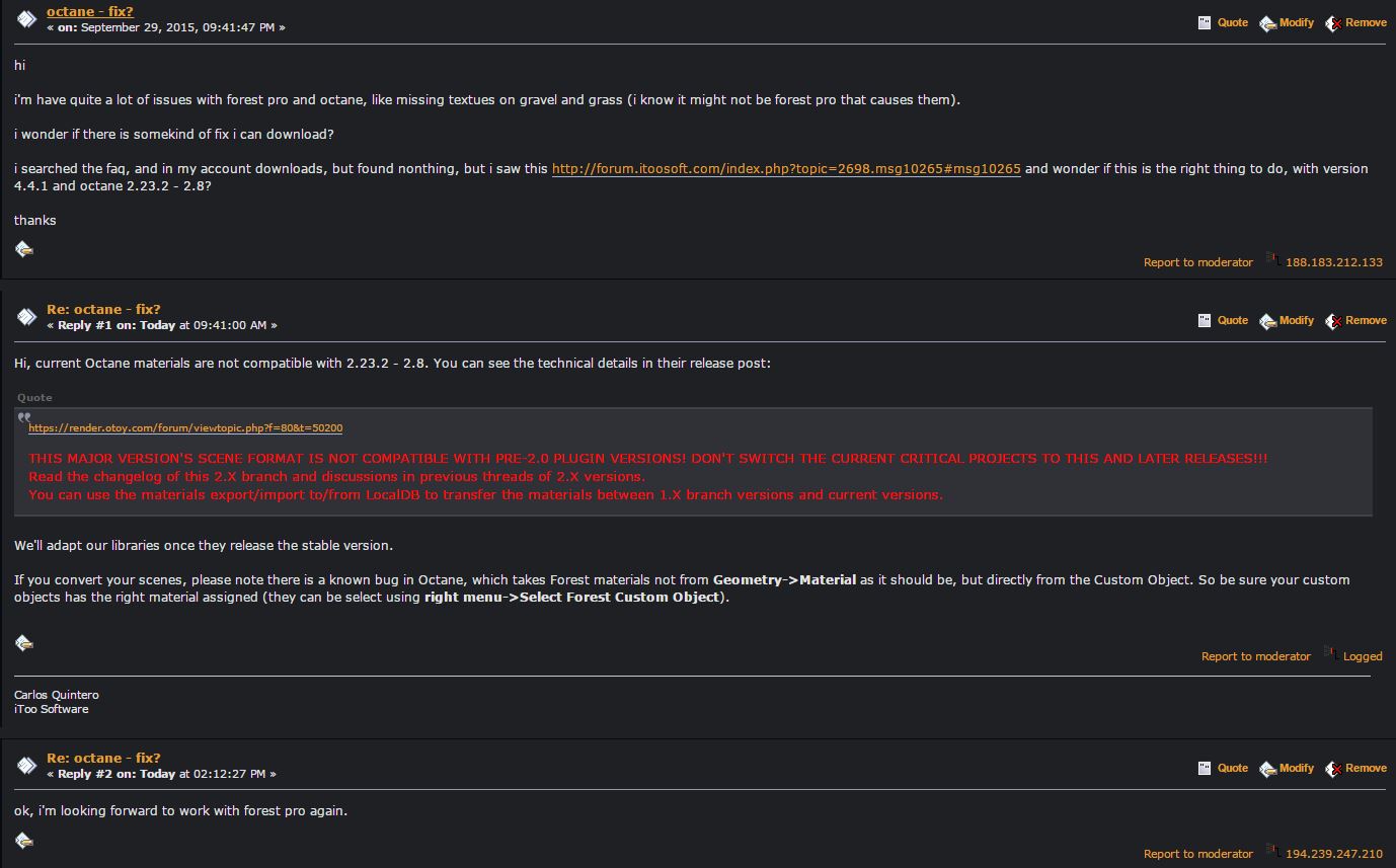

i have just upgraded to forest pro 4.4.1, and would like to use the stones that comes with this release.
i can add but the materials are not working :-/
so i try to edit the materials myself, but everytime i reopen the octane render window, the materials are reset :-/
is here anyway i can fix this or create a workaround?
i'm using octane pluging version 2.23.2 - 2.8
thanks

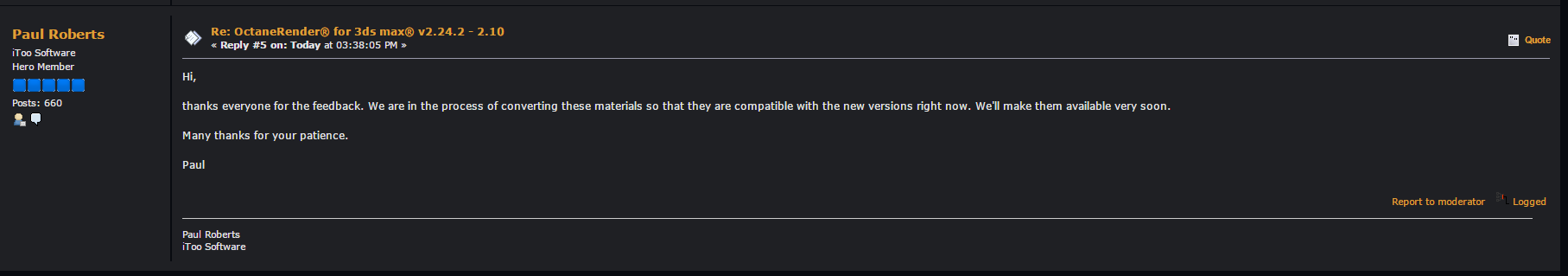

i posted in the itoo forum, and got a message that they are wating for otoy to have a 'finished' plugin.
there are some workarounds, but it gets to complicated and time-consuming for me.
