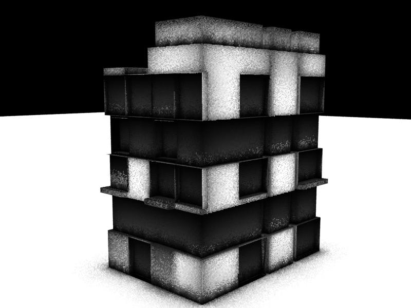

actually it sort of works -
doesnt work directly in octane, it works with mentalray.. it uses render elements, so it renders another image after it renders the main render, the other image is a black and white image with dirt only, which you have to assemble in post editing

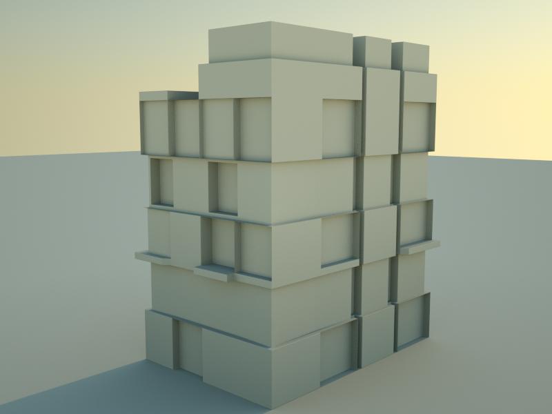

it works if you do it like this: render the dirtmap inside mentalray, then switch to octane to render the main render (while keeping the identical camera view), assemble the dirtmap and render in post edit..
basically it renders another image with dirtmap after it renders the main picture, it doesn't seem to matter what the light direction is (need more tests to verify that)
al the materials have to be in mentalray, because it will give you an error if you use octane 3dmax materials and stop

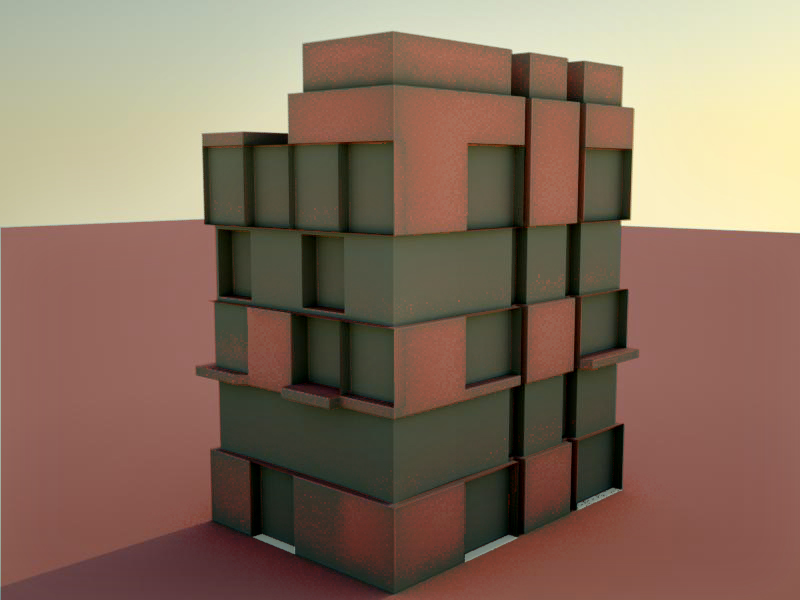

could be useful for all those times you make a perfect render and want to dirty it up in postediting
here's a quick and dirty test with octane and dirtmap

not really sure what you're asking, the software basically produces the dirtmap render - that is the black and white image.. which then you have to apply in photoshop
