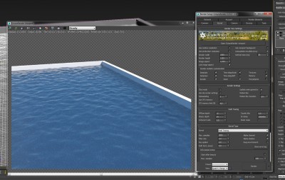

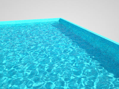

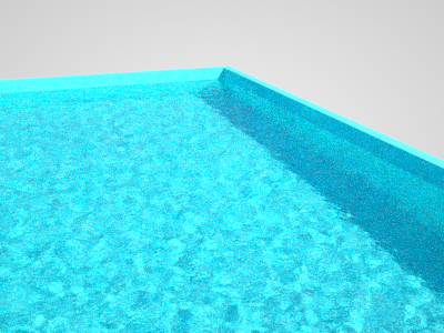

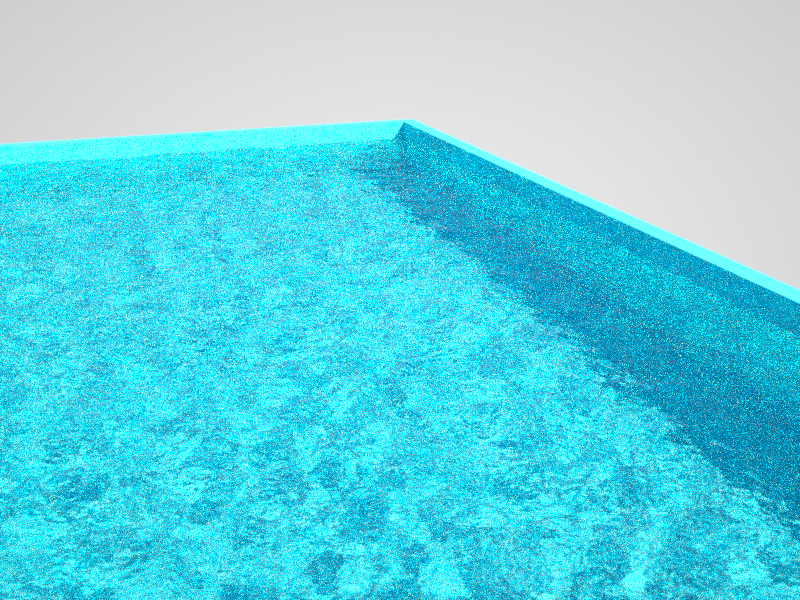

Different methods:
First displacement modifier
Second Bump map
Third Displacement map
Winner Displacement modifier
pool.zip
max file
(213.16 KiB) Downloaded 369 times
Material Displacement
material bump
material bump
Displacement Modifier

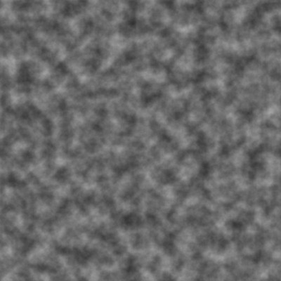

This is the map I used

It does not work. :((

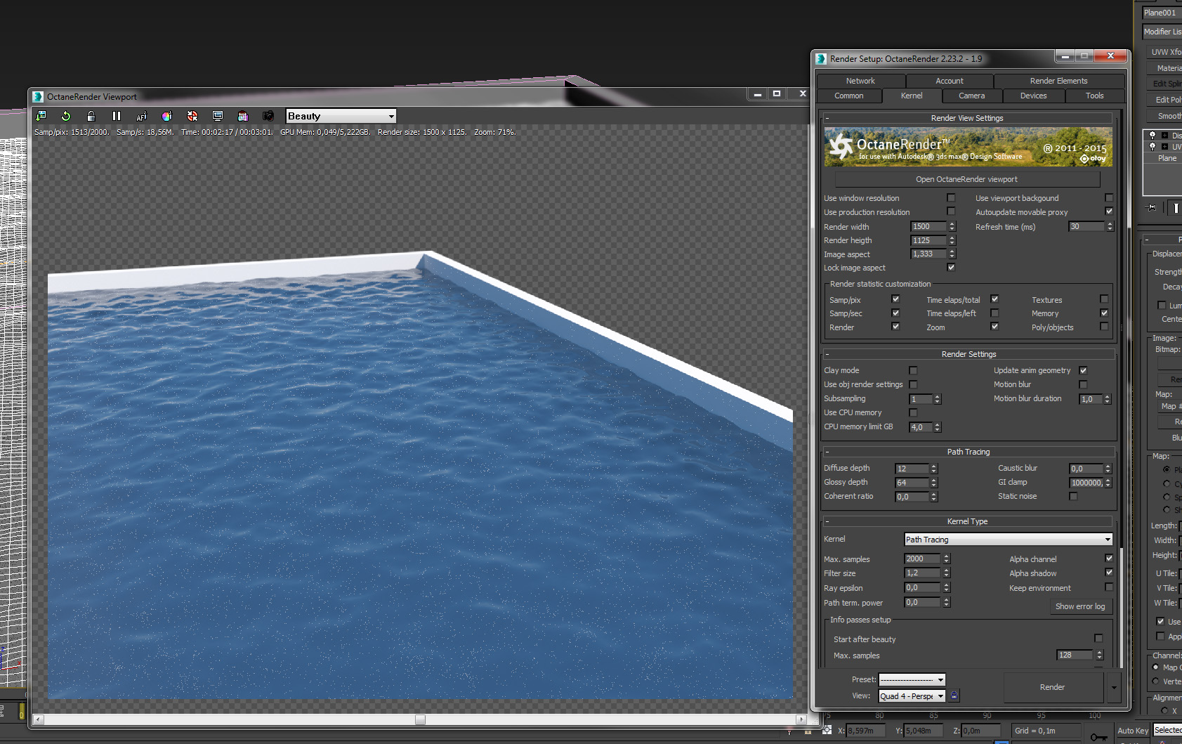

I just set caustic blur to "0,01" and it works like on the screenshot. I ever thought caustic blur won't affect the caustics calculation but reduce the sharp edges and blur the caustics....

You have to activate the displacement modifier for it to work. :P

I did. Look at the surface. ;) it was the caustics blur setting.
