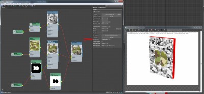

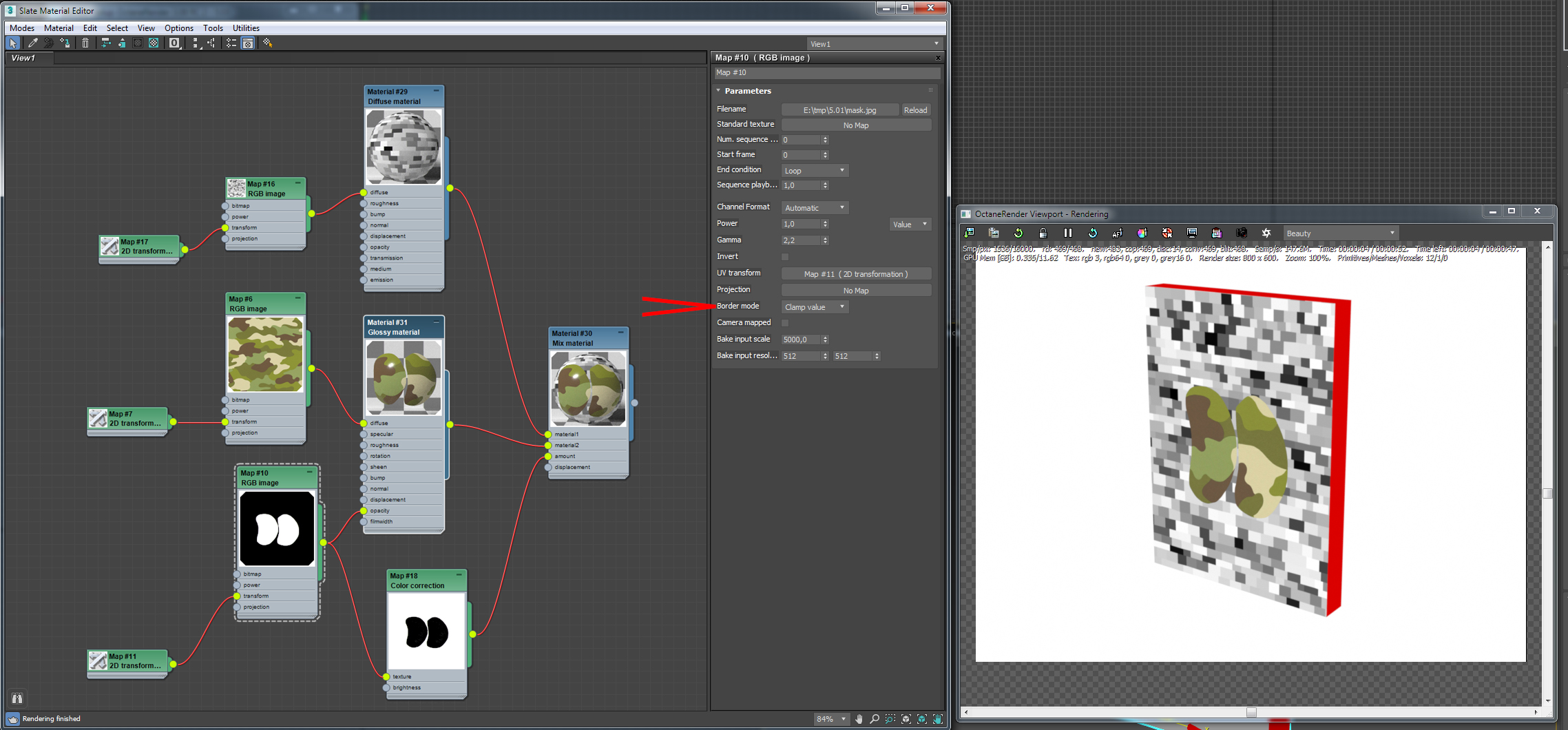

Hi Nildoe,
something like this?
Regards
Paride
02.zip
(1.05 MiB) Downloaded 253 times

Paride...hehe thanks alot yes like that..so your saying the secret is to use "Clamp Value" thats the parameter that eliminates the shadow?
however like this is not easy to drag the decal around is it? more for finetuning its position? unreal is really great at that as it offer an object JUST for this purpose and it projects the texture wherever it "hovers" to.
but this..this helps a lot already thanks!!
